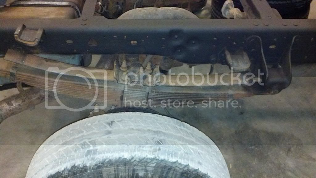

The decision was made to flip the axle to on top of the now very reduced leaf spring pack. So now remember how I have already moved the factory spring perches? yup they are on the wrong side of the axle now... I decided i was NOT going to spend the time to carefully remove them for a second time. I ordered some after market perches and welded them on the opposite side of the axle at the correct angle for proper pinion angle at the new much lower height. So I get all the drive line back together and set the truck on the ground and i ended up dropping in about 8 inches. Awesome! except now the front is too high. This was easily solved with a phone call to DJM suspension.

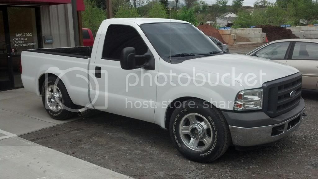

The truck is FINALLY completely together and drive able. I drove it a few days and took it to a local body shop where I had them Save the cab lights, fuel door and install a Grant Kustoms all steel roll pan. Stayed with all white to cut some cost on the now WAY over budget project. Ended up taking them about a month or so to get everything done and the truck painted. The day i picked it up from the body shop i drove it straight to the tint shop and had him do a layer of 5% all the way around and 35% on the entire windshield. Sadly the phone I was taking all the pictures of the build with got destroyed while the truck was in the body shop before i got the all the pics on my computer. However this is what it looked like the day I got it back from the tint shop.

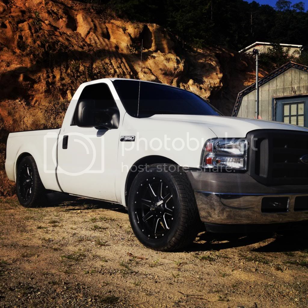

This is roughly what it looks like today. I'll post more later just tired of typing for tonight.

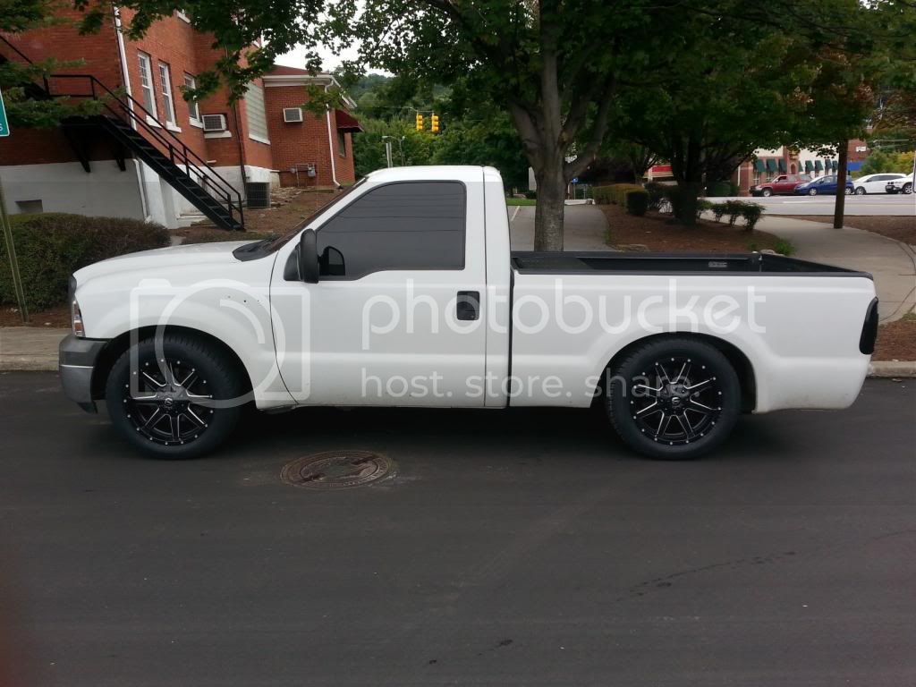

Looks good, but I think the front could use some more lowering or the back could be lifted a bit.
Good eye! lol If you put a tape measure on the wheel wells the front is 3/4" higher then the back and it drives me nuts! The problem is now that the axle is flipped there really is no real easy way to pick the rear end up some. ( Other then more leaf springs = worse ride. so no. Or flipping the rear shackle mount which is supposed to give 2 inches higher. But the point is for it to be slammed lol)
So i'm wanting to drop the front about 1 1/2" and i'd like to do it with softer factory springs. Problem is i'm having a tough time figuring out what spring code i need.
