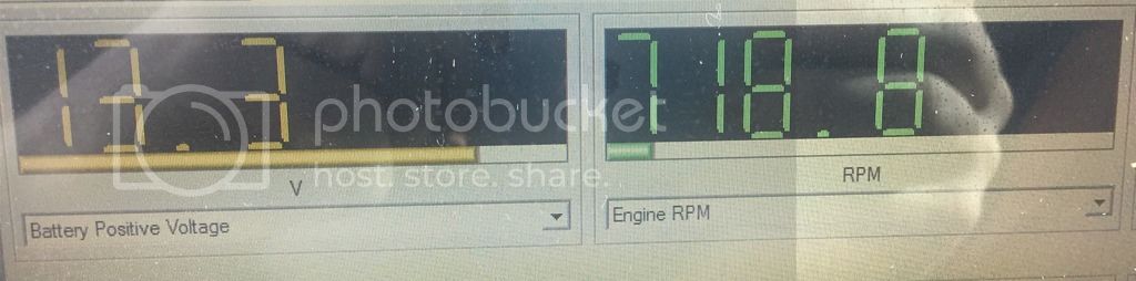

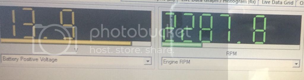

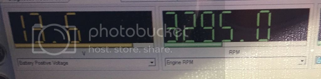

Hey guys, I need some help tracking down a low oil pressure issue I'm having. The oil gauge never moves it has very little power and running rough. Here are some readings from AE. Any ideas?
Not running
Idle
WOT uphill
Powerstroker7.3
Oct 8, 2013
519
waxhaw NC
Did this problem just start happening. It looks like you need to tell your tuning guy to increase injection pressure because the duty cycle is not high like it’s struggling to make that pressure and at idle that seems to be a normal pressure

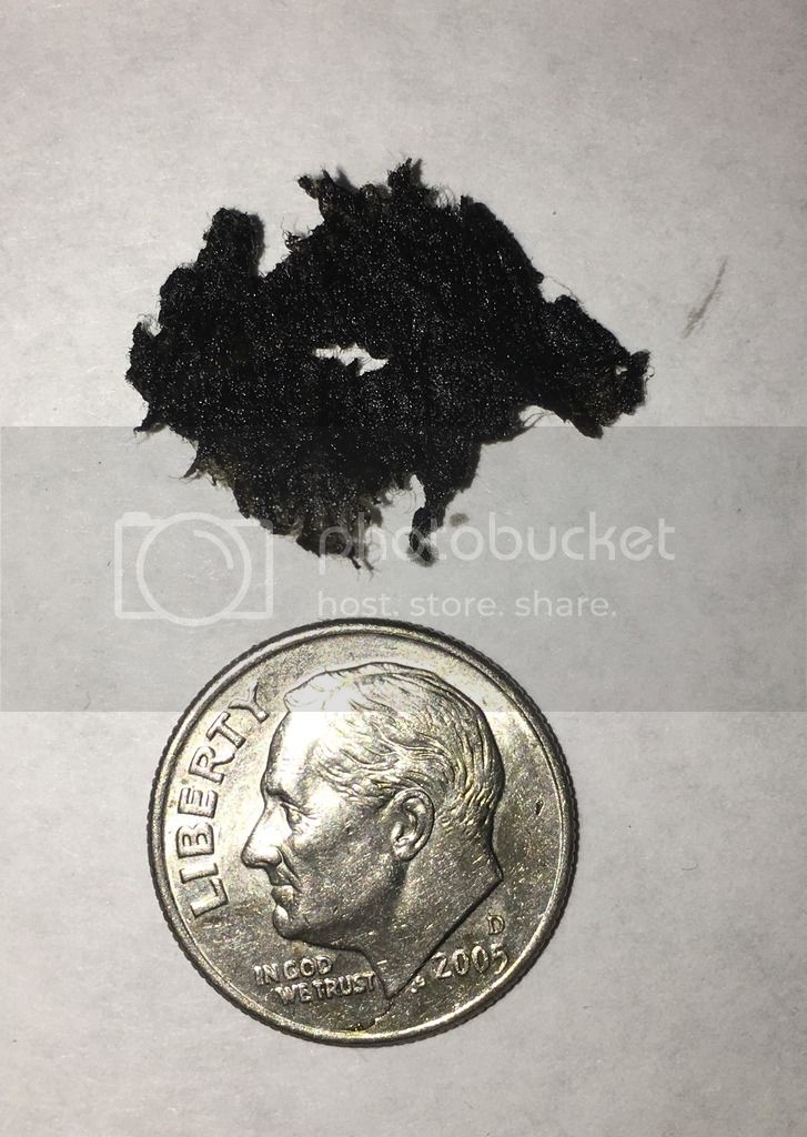

I noticed the hose to the map sensor wasn't all the way on. The original ICP sensor was still on the truck, I noticed oil on the plug so I replaced the sensor today with a factory one. After the new sensor and fixing the map sensor leak nothing has changed in performance.
Sep 9, 2015
3,690
201
Mesa, AZ
Personally i would change it. About 90% of the time, cleaning it doesnt work. A lot of times the oil gets up the wires and the insulation wears off around 1-2 inches from the pigtail, and youll have a short there, and that causes all sort of goofy chit
