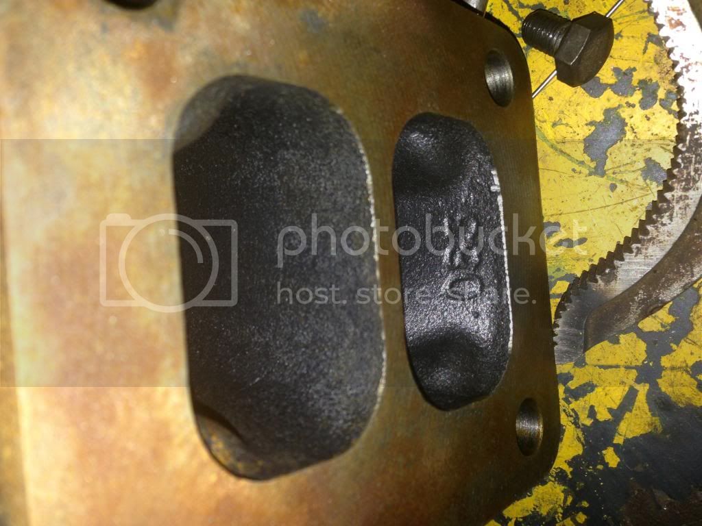

Is this the T4 .83 turbine housing everyone raves about?
Extended Power
May 24, 2011
2,216
Just curious, because it may have a T4 flange on it, but they sure don't have T4 port size...

whats the rest of the housing look like? Definitely looks nothing like we've used.

That is not a genuine Borg Warner turbine housing. The Borg .83 a/r will line right up with a standard T4 gasket...

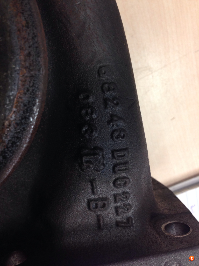

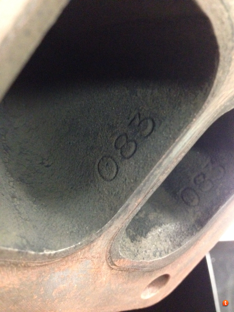

Oh really??
I posted these to show the Borg Warner symbol cast into the housing, and the part number.

Guess i should've worded that post better... "doubt that is a genuine borg housing"
Doesn't look anything like the Borg .83 housings on our shelves...

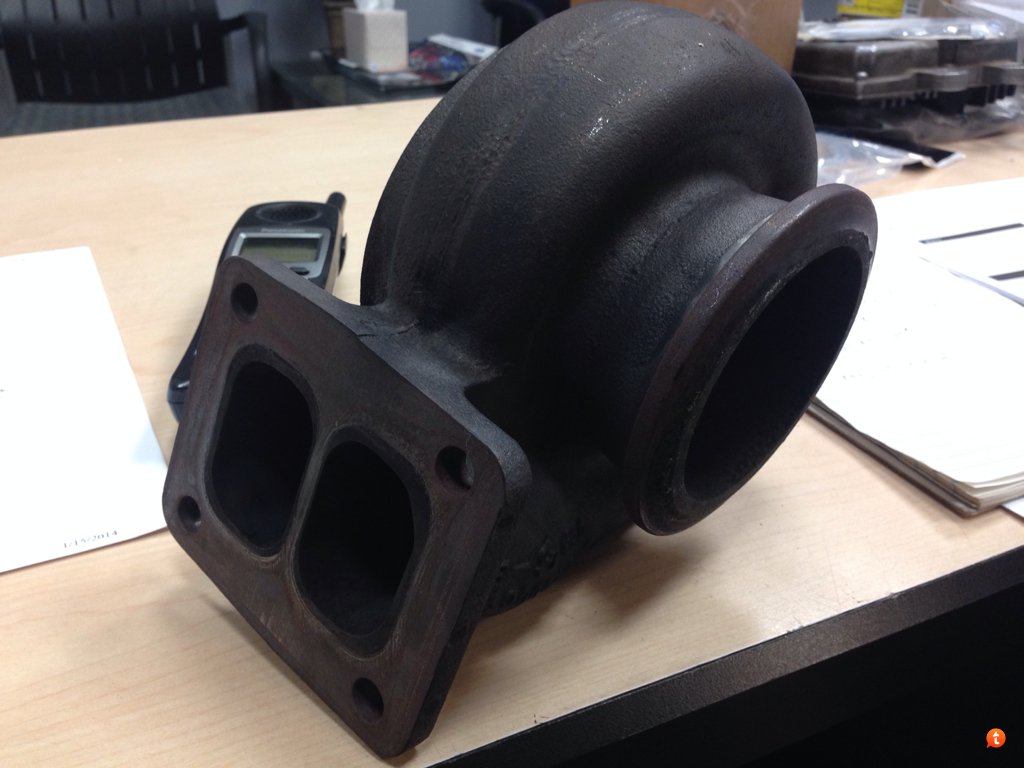

Do you have better pictures than just the flange?

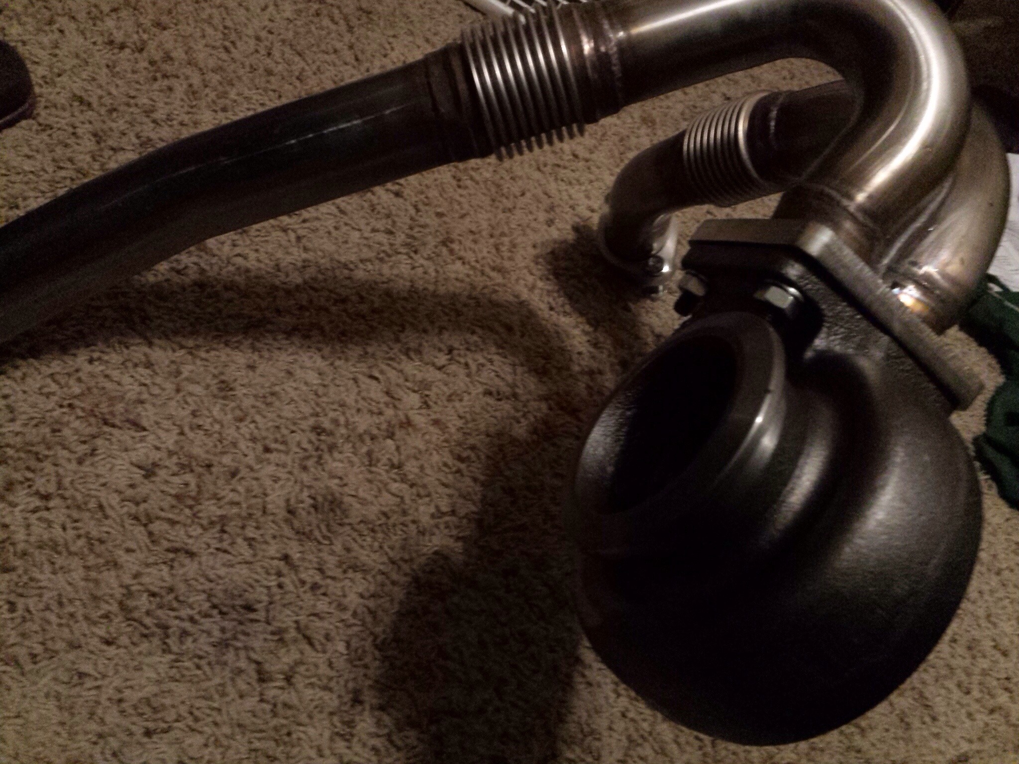

The exhaust outlet is a marmon flange, I had an adaptor made so I could use my HX40 connection on it.

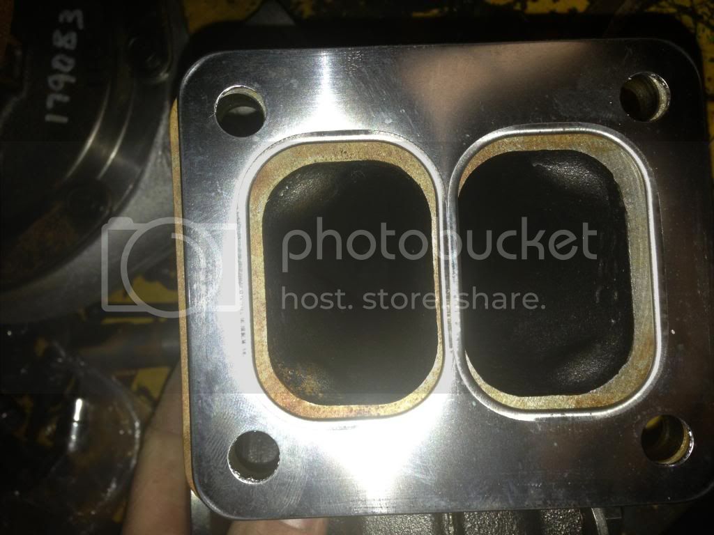

This is the only close-up of I have of mine. I do know the ports were very close to the T4 gasket.

this is a true BW .83 divided housing... same marmon flange.
They offer a few different ones, the small port housings are s200 housings machined to fit the s300
