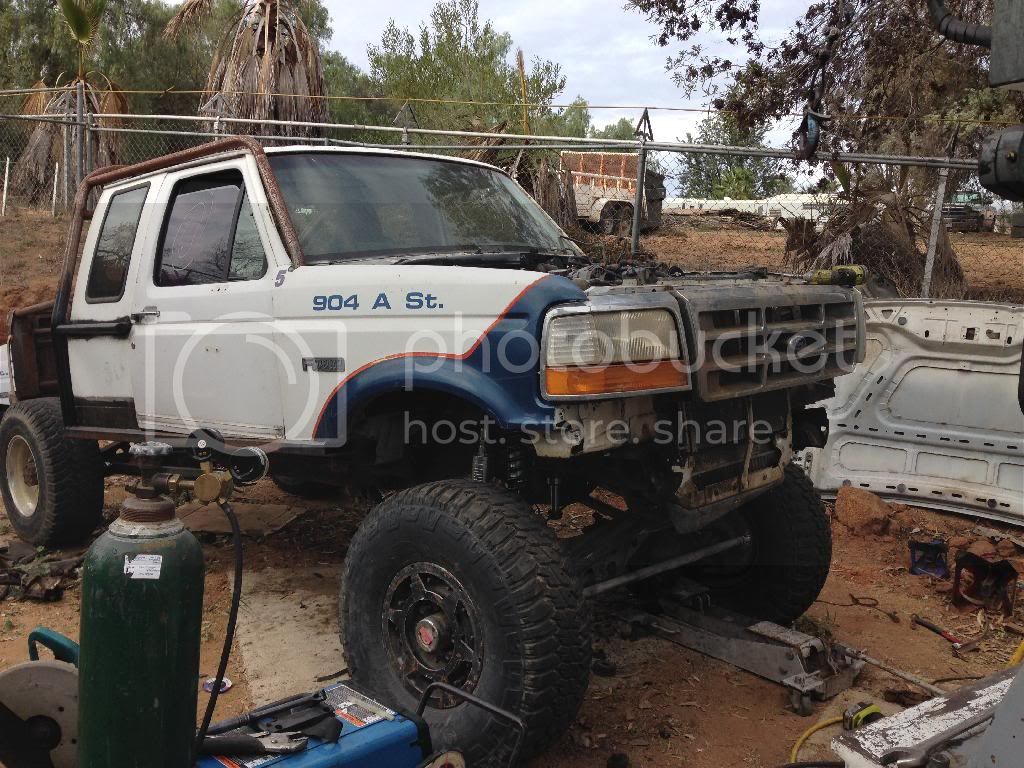

My f250hd trail/ desert truck. 3link front 4 link rear coilovers and etc...
Dieselboy
185
Guess I should transfer my build over here too.
Plans are D60 front, 10.25 rear, cage, boat side, back halved, 3 link front, 4 link rear. Once the cab and chassis are done ill take the 7.3 powerstroke / E4od/ 4407 from the current truck and swap them into this thing.
This got dropped off on Friday
Gutted it. Pulled the bed, fuel tanks, front clip and not shown but I pulled the front beams, and a/c heater box. I then pressure washed it inside and out.
More pics of the interior and cleaned/ gutted truck on Monday as I towed it down to the shop I work at.

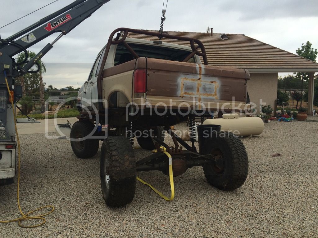

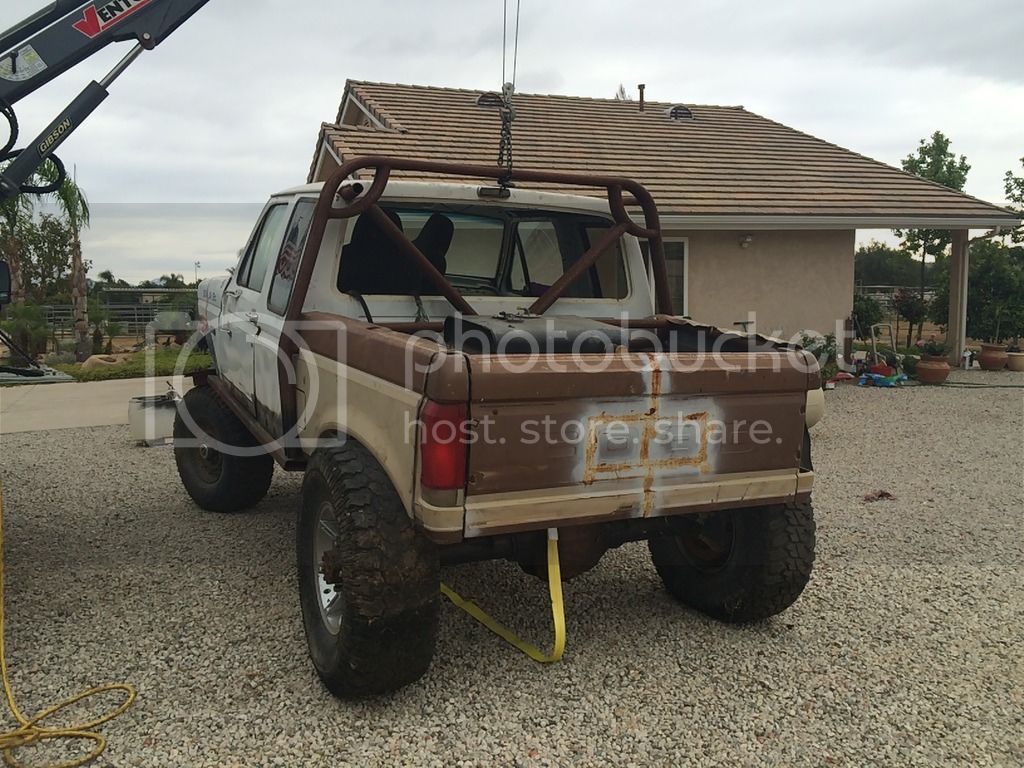

Ok I lied I got stuff don't today at work so I spent a few hours working on this thing today.
I took 12" out of the tailgate and a lot off the bed sides lol. This is just kinda hanging there lol.
Draw on tailgate racking brain on how to get equal spacing in the letters when done
Cut it apart in a way that looks like a bowtie lol
Weld It back together the best I can. I hate thin metal

Man this fabrication stuff takes forever.
Making sure the shocks clear
Test fit one of the seats. They almost bolt in lol.
Added a few braces to the rear and make some quick brackets for the fuel tank.
Plated in the frame by the steering box
Cut off the front bottom of the crossmember and welded the crossmember into the frame. Cut out the leaf spring stuff and gasser motor mount plates.

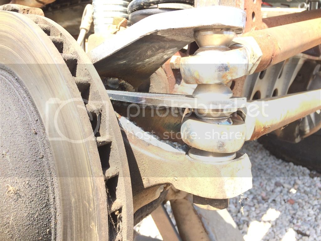

Going to use some 3/8" to make the steering double shear and brace the knuckle a little too.

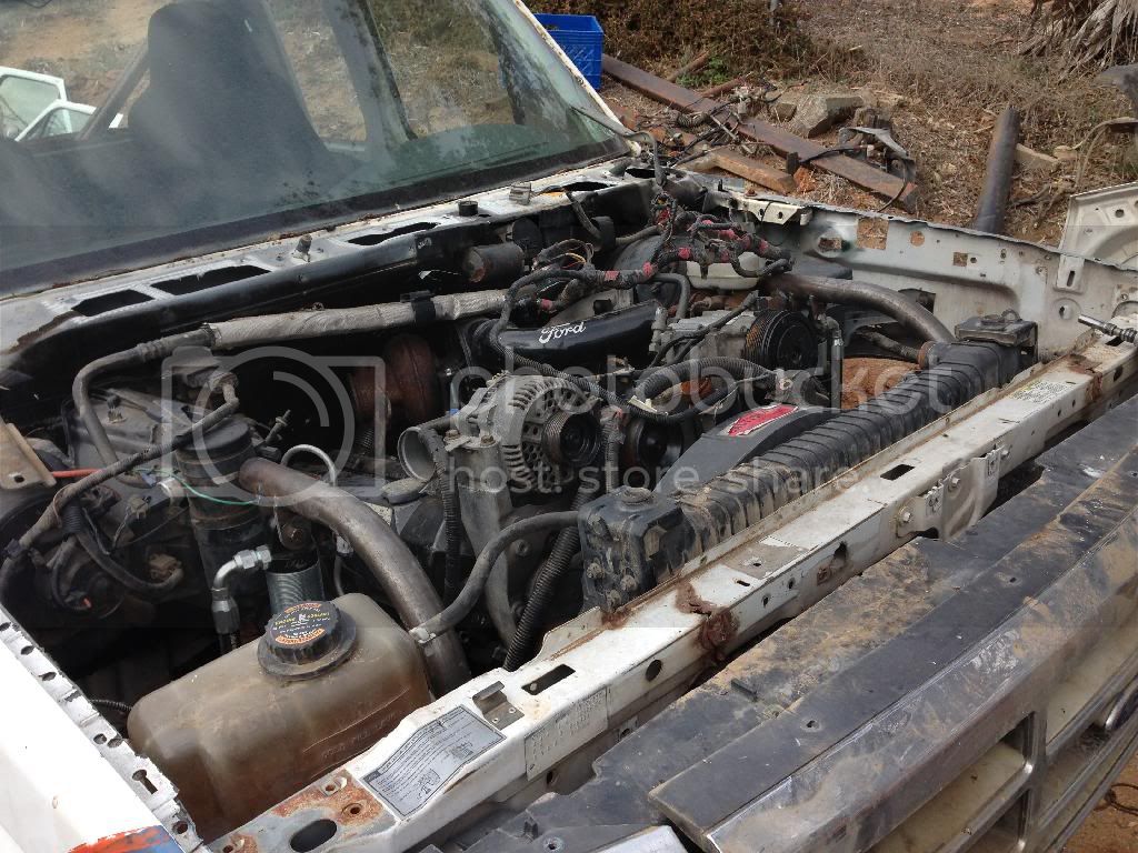

Pull the front clip
Remembered that you can't pull the engine and trans together so I pulled the 4 bolts and took the cab off.
Going to make my own regulated return electric fuel system. Also going to make my own bellowed up pipes to fix the small leak.
or just find the T444E bellowed up pipes?
Lol yeah for 8-900$
Pulled the engine and trans. (I love my crane) then pressure washed the crap out of them (not pictured)
This was the main oil leak I had
Cast iron tail housing/ tcase adapter from a 02 f350
Just FYI it is possible, but you have to pull the transmission crossmember (or cut it).:flipoff2:
With a diesel? I've tried and you can't rock them back because the turbo/ heads hits the firewall and the oil pan binds on the crossmember.

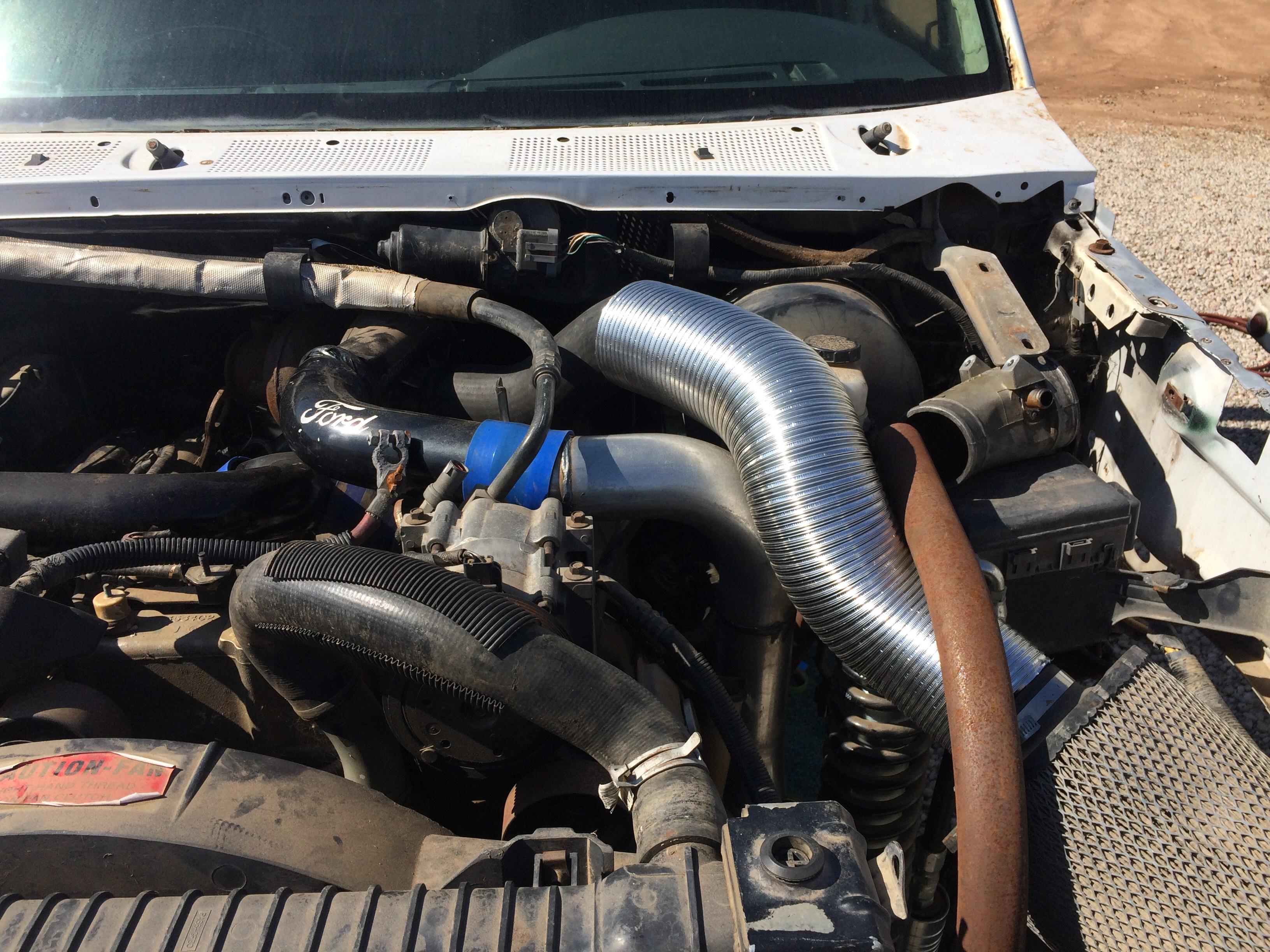

I need a set of 3" intakes.

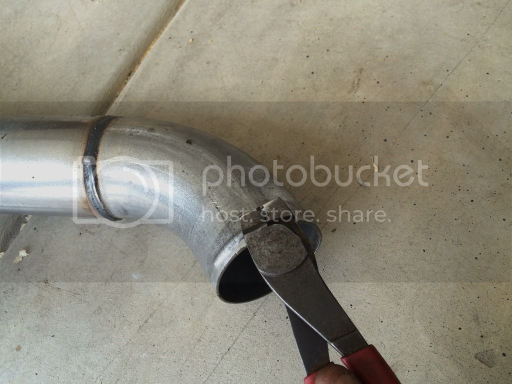

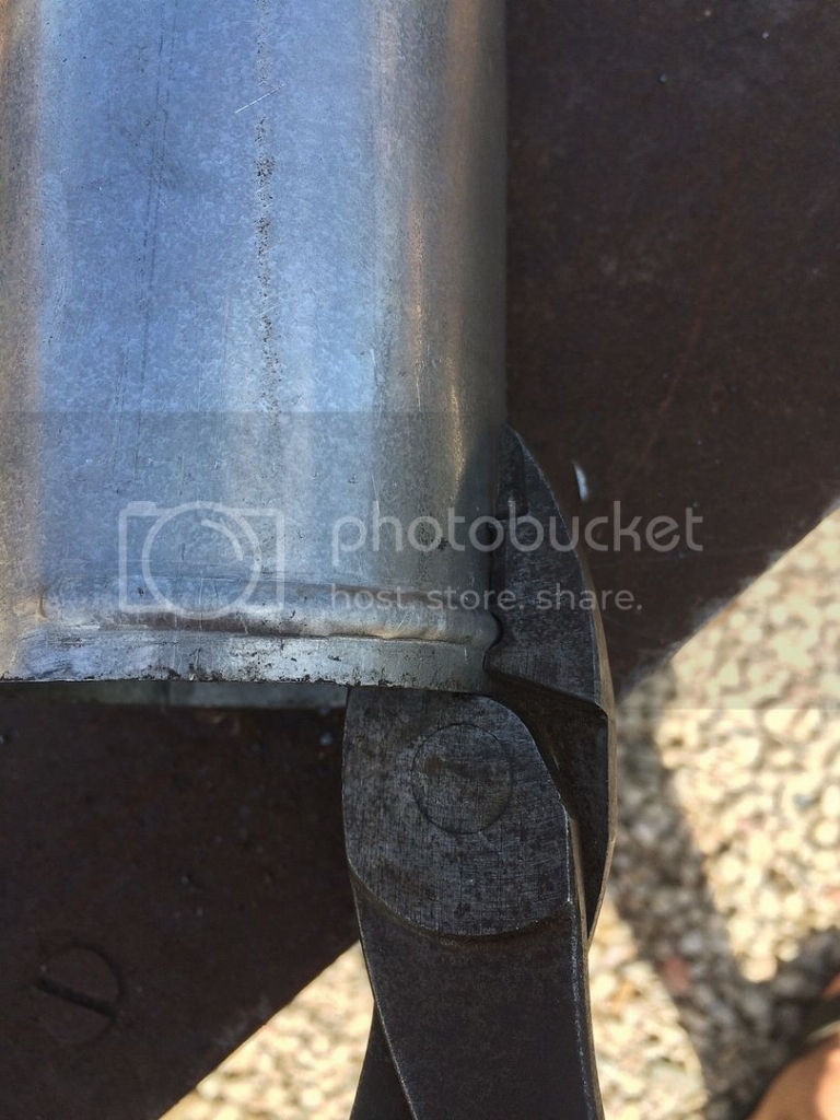

Made the 1/4" in to 1/8" x2 piece myself as I couldn't find anything I liked that kept it tidy.
Once I get the 3" intakes ill sort this out.
It was a thought.

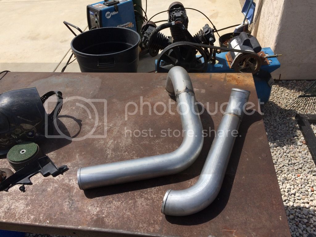

Got my bellowed up pipes and ebv delete resistor. Resealed my oil cooler too. Just a few little things till I drop it in and start front tube work. I do need a stock v band for the turbo inlet and compressor outlet if anyone has one.
Fixed a broken exhaust bolt with a stud.

Built my own intake setup and ill drop the engine in today

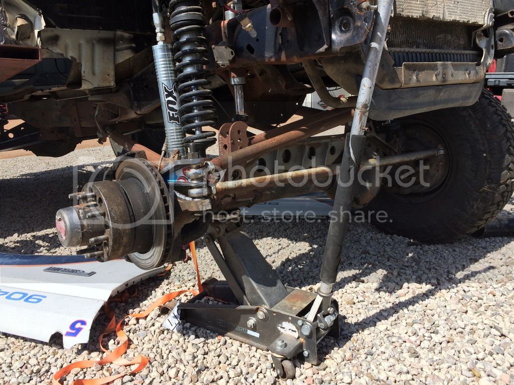

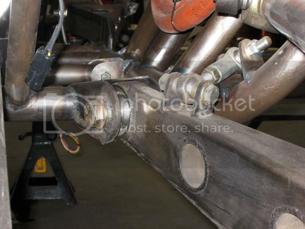

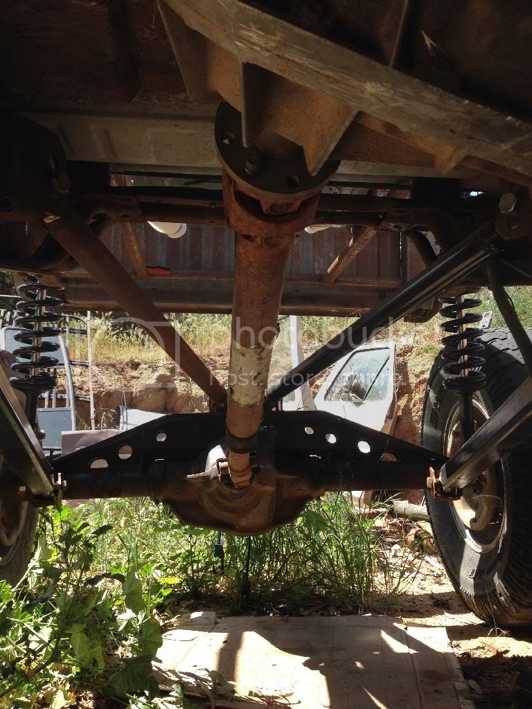

Did some work finally. I need to plate in the frame on the upper link but everything is tacked in place and has been cycled a few times. I had to move the panhard as close to the truss as I could. The panhard rod and steering are exactly the same length. They're really close to the same angle too. I measured the full droop and the steering heims max out at about 17" and I'm going to strap it around 15". Lower links are about 34" and the upper is about 44". It looks like it keeps the pinion angle really good throughout travel.
I cut in the passenger side bumpstop and I'll get the drivers side done later. I'm taking a break.
Full bump
Full droop
Got the drivers side bump in. I still need to plate to outer part of the bump pad and add a gusset inside first. I put this side lower as where it hits the truss is lower and the steering shaft is in the way.
It moves like 3/8" during the 4" of bumpstop travel.

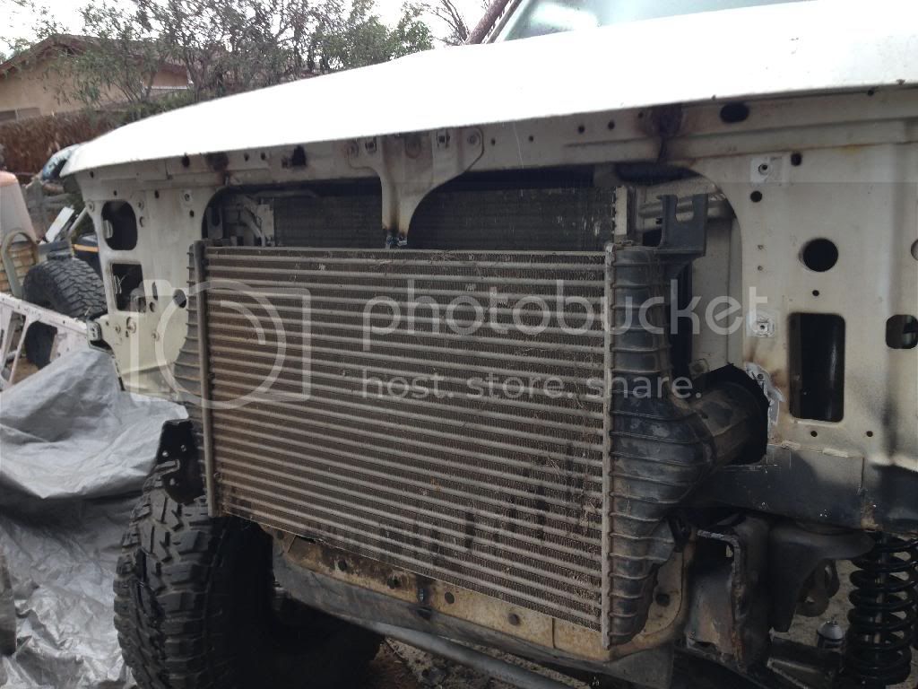

Got the front sitting on the coilovers. I'll tie them in a lot but right now with 300x16" over 350x18" coils there's 10" up travel. I still have to add a bunch of tube and the trans/ tcase and the cooling system. I got a intercooler from a superduty that I'll be adding to the front too.
