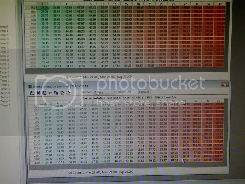

When cruising in high gear with the converter locked I have noticed the rail pressure will fluctuate several thousand psi up and down with light throttle input. It does not do this at all with the converter unlocked. I am pretty sure it has to do with me running a stock like lbf map to keep smoke down and not having the ability to regulate boost with a vgt. Is there a way to tune around it or will a have to switch to a more canned tune type lbf file? Here is a pic of my lbf map. The truck drives great with the exception of maintaining speed on the highway along with small throttle changes .

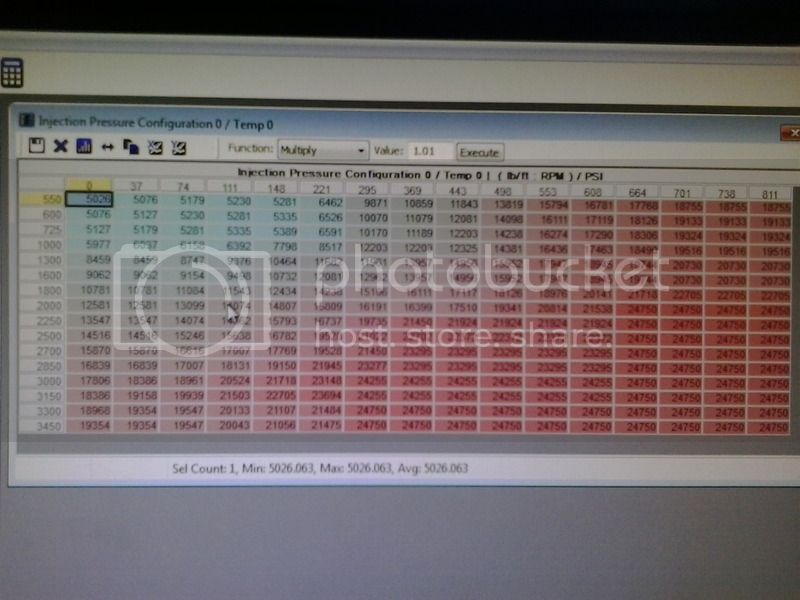

You could try to slightly adjust the lbf table at the cell right where it happens and see if that is causing it. For instance if it is around 2k rpms and 8-10 lbs of boost, try increasing your fuel mass limit in those cells. That would at least give you an idea if it was causing the issue. Also what do your rail pressure tables look like, maybe there's a steep spike on those that could be smoothed out.

This was all because of how tight I was with the low boost fueling. As soon as I loosened it up and pulled pulse width it cleared up.
