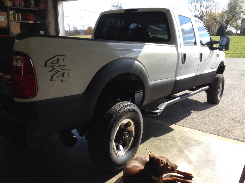

My son converted his "00" dually to single rear wheel.
Worked well for him , 2013 bed is Linexed around wheel wells for protection.
