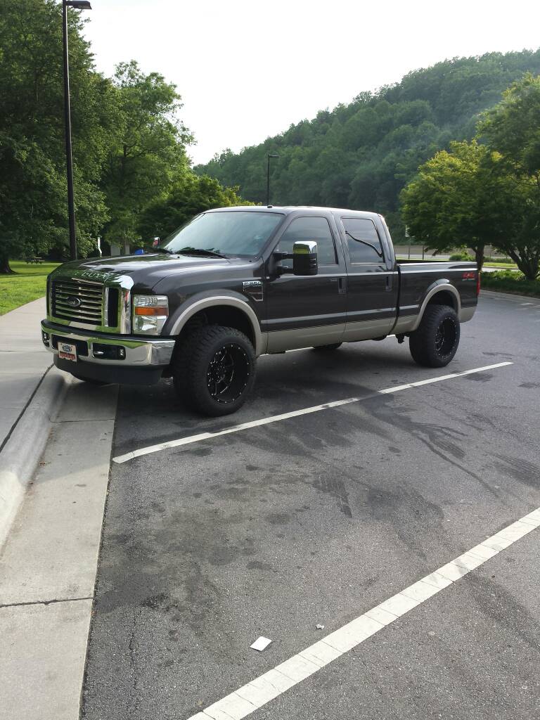

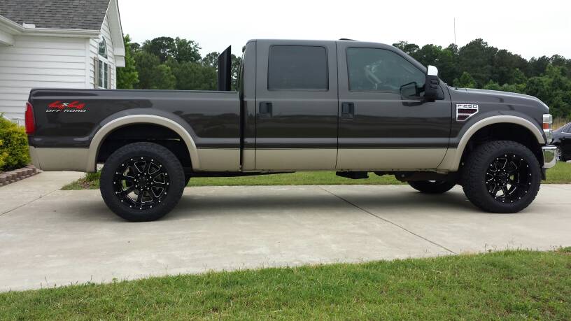

Mine is a 6.4 but it'll give you some idea. This is that size tire on a 20x12 -44 wheel

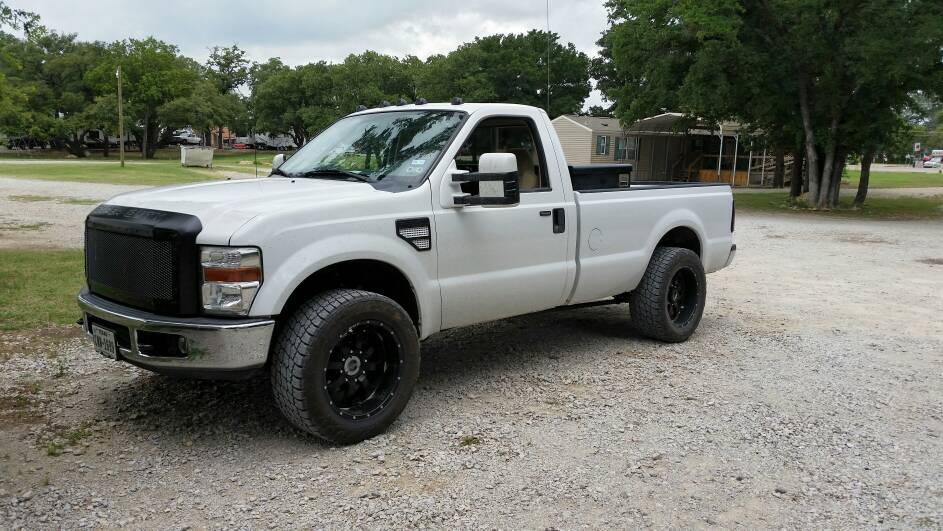

This is my dad's truck with a 20x10 not 100% sure on the offset but I think it is -24 or 27? Same size tire. You can tell it looks too small on his with his 3" leveling kit

I have no lift. Your truck looks great. I was worried about clearance, but if you have no issues i shouldn't be to worried. I like that -44 look it makes me think maybe i should reconsider.

Welcome! You will definitely have clearance issues with the 20x12 and your model year. A 20x10 wouldn't be too bad maybe minor rubbing on the inner fender liner which is an easy fix.

Do you think a leveling kit will clear those 12" wheels with -44. With my flares im worried that a 10" wheel with -24 wont stick out enough.

Your model year has smaller wheel wells than the 08's and up. I have an 05' with 22 x 12 wrapped in 305/40's, stock height and they barely rubbed at full lock on level ground. I think the overall tire size was 31.6"x11.8". Yours will be around 33.2"x12". You will definitely have rubbing issues at stock height and 12" wide rims. Even with a leveling kit.
