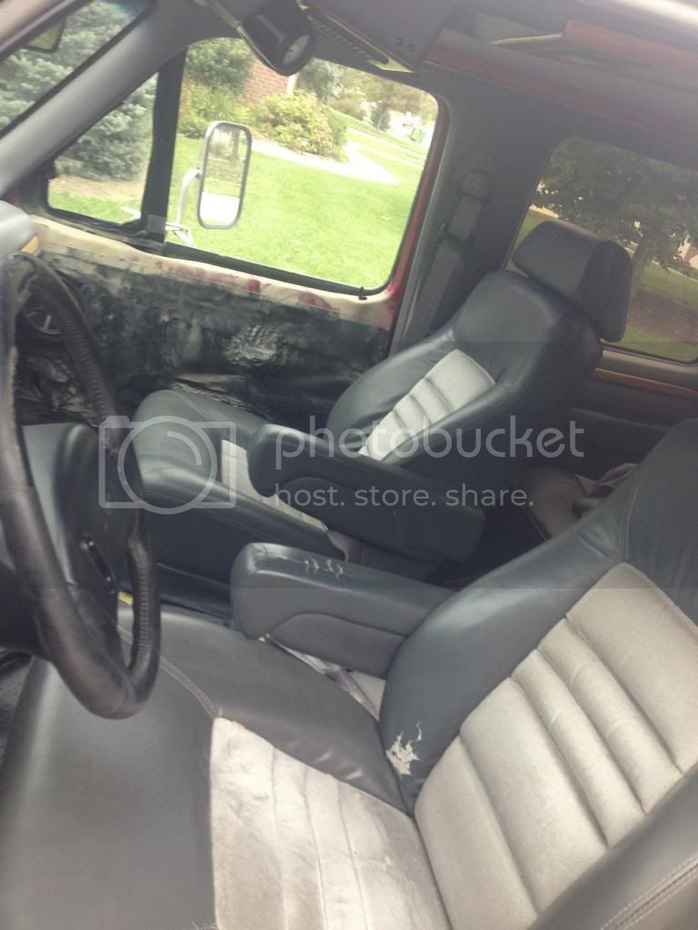

I figured I would share some of my progress I've made over the last few months, lucky for you guys, it's still a work in progress.
This truck was originally owned by an older gentleman who bought it brand new. From what I gather, Tuscany would modify the interior of these trucks for comfort and "long hauls". This older gentleman then sold the truck to some kid and the kid sold it to me. This kid only owned the truck for 4 months but managed to really screw some stuff up.
Original Interior Pics:

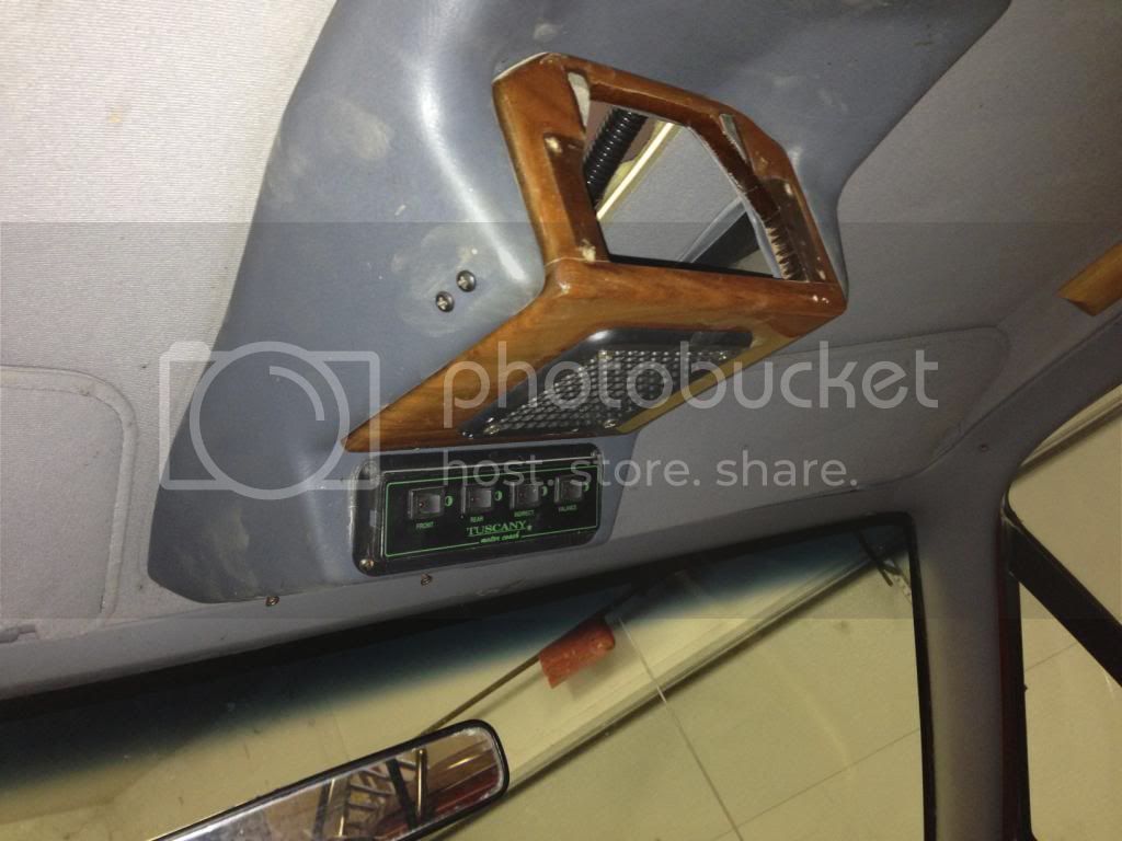

The big hole had a cheap old CB radio. I'll be remaking this wooden insert all together to remove the speaker grill and the big a$$ hole.

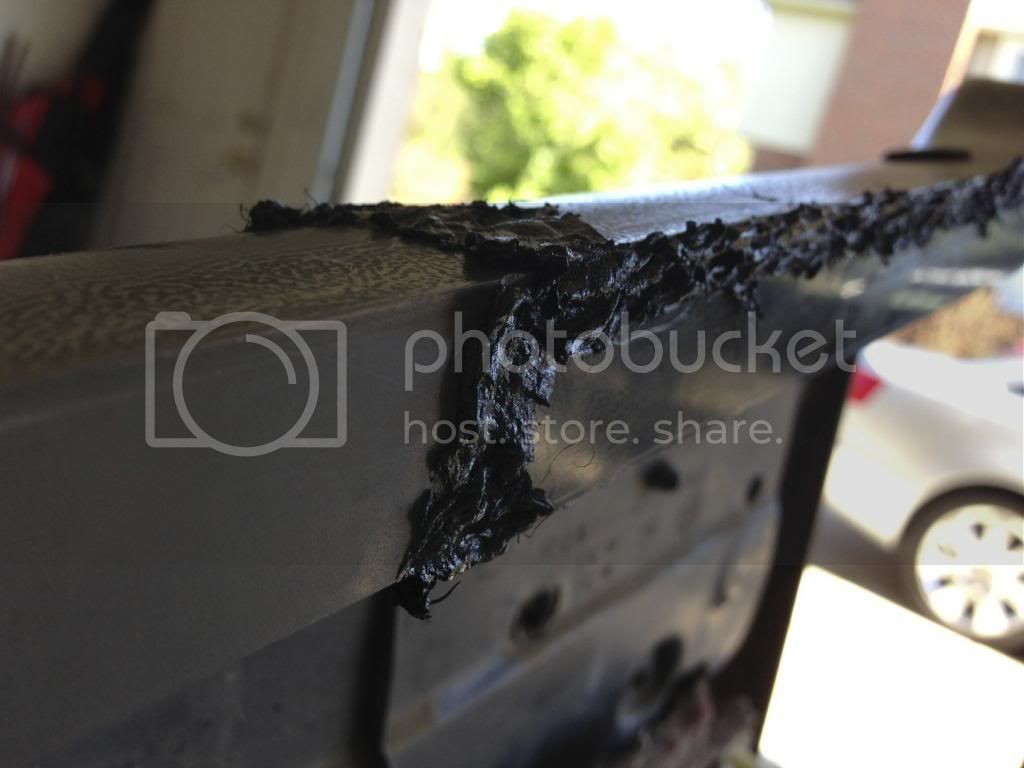

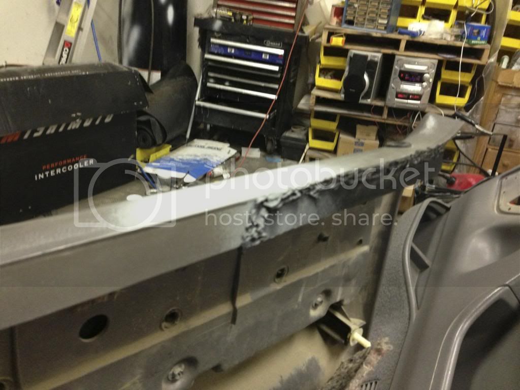

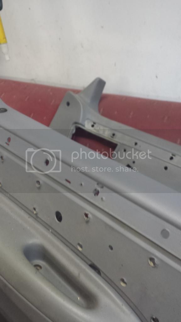

Door Panel Repair (Replicating the plastic texture was the biggest PITA):
Fixed:

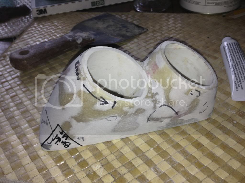

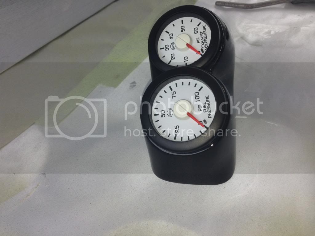

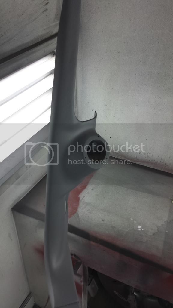

Time for some fiberglassing for custom gauge pod in overhead console:

Interested to know how you matched the texture...
I'm in a similar process right now..
Will be going inside the bottom of a stock middle jump seat to house a single shallow mount pioneer 12". Got a few more layers of glass to put down, then start putting everything back together.
That's looking good so far! Fiberglass is fun to play with.
On my door panel repair I matched and blended the texture using a grain pad.
I bought a grain pad that matches the original vinyl & plastic textures. I then used a releasing agent and clear intercoat paint and pressed the grain pad on the area I wanted to replicate my texture.
It took me a few times to get it perfect, but I'm very happy with the results.

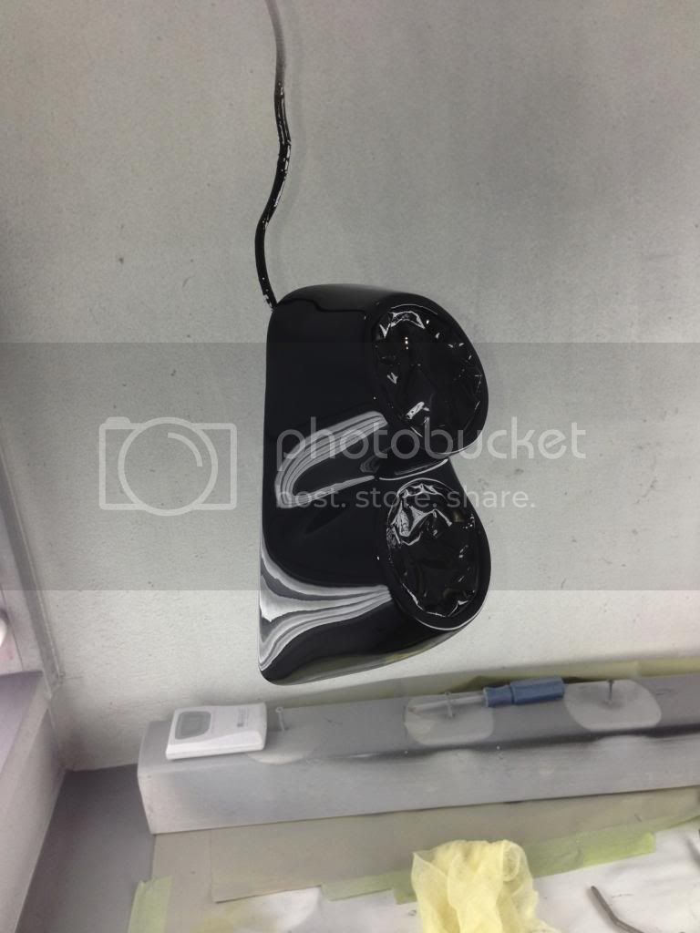

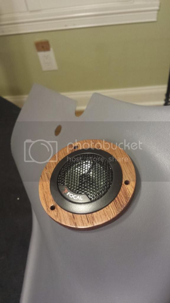

As for the kick panel tweeter pods, I used both the grain pad and SEM texture paint. The tight curves of the tweeter pods made it hard to replicate the texture using a grain pad. So I blended the OEM texture in with the SEM texture. You can really only see the difference in texture when you are 6-12" away from the kick panel.
Here is a picture of my grain pad, it's relatively small though:
There are a few tutorials on how to make your own grain pads, but I found it was easier just to buy one.

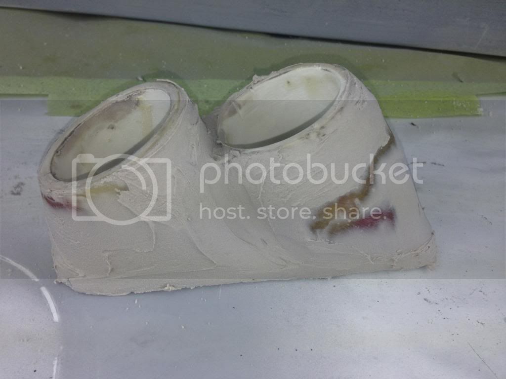

I'll keep it in mind man! I got an extra set of sails so I think first round will be smoothed and ptm. On your kicks did you just use expanding foam around the base ring then shape it and bondo over it? Or is there fiberglass just no picture.
Just let me know!

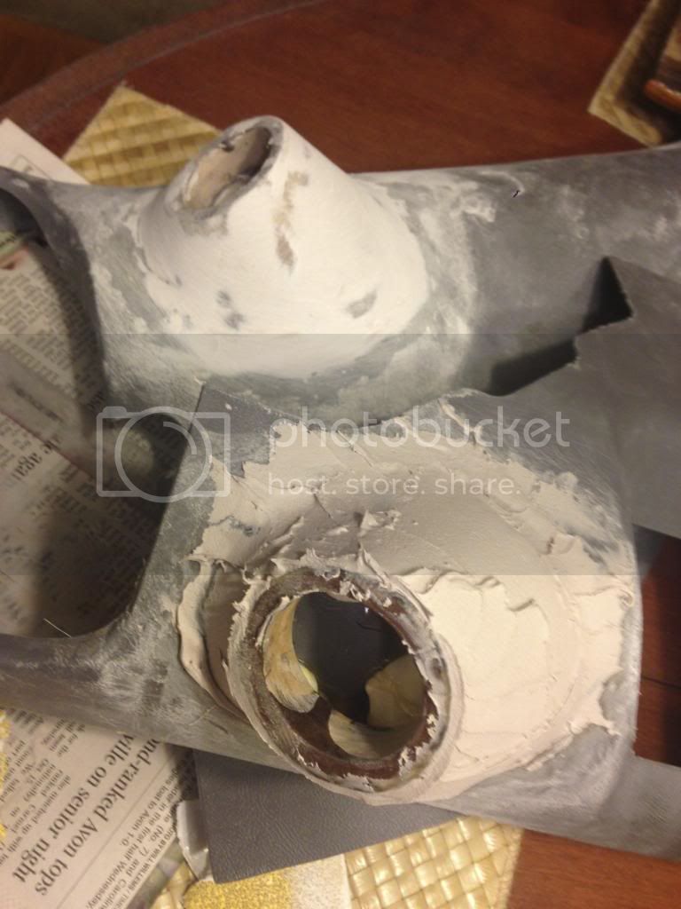

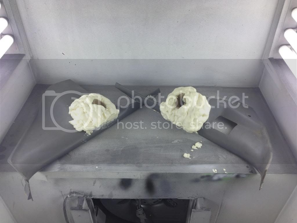

I forgot to take some pictures when doing the kicks, it is fiberglassed.
I cut out MDF rings for the tweeters and used some wooden dowel rods to position them. Hot glue to hold everything in place. Then the expanding foam and a fine hacksaw blade to shape the foam (love that stuff). Then I drilled the holes around the base of the foam (as seen in picture). I did this because fiberglass doesn't stick to ABS plastic (when using resin). Then I fiberglassed both sides of the kick panel. This sandwiched the plastic, allowing the fiberglass to have a strong bond.
