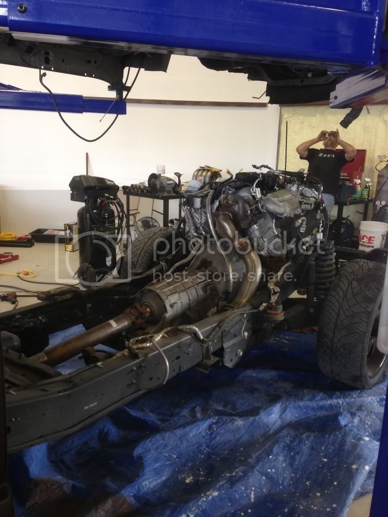

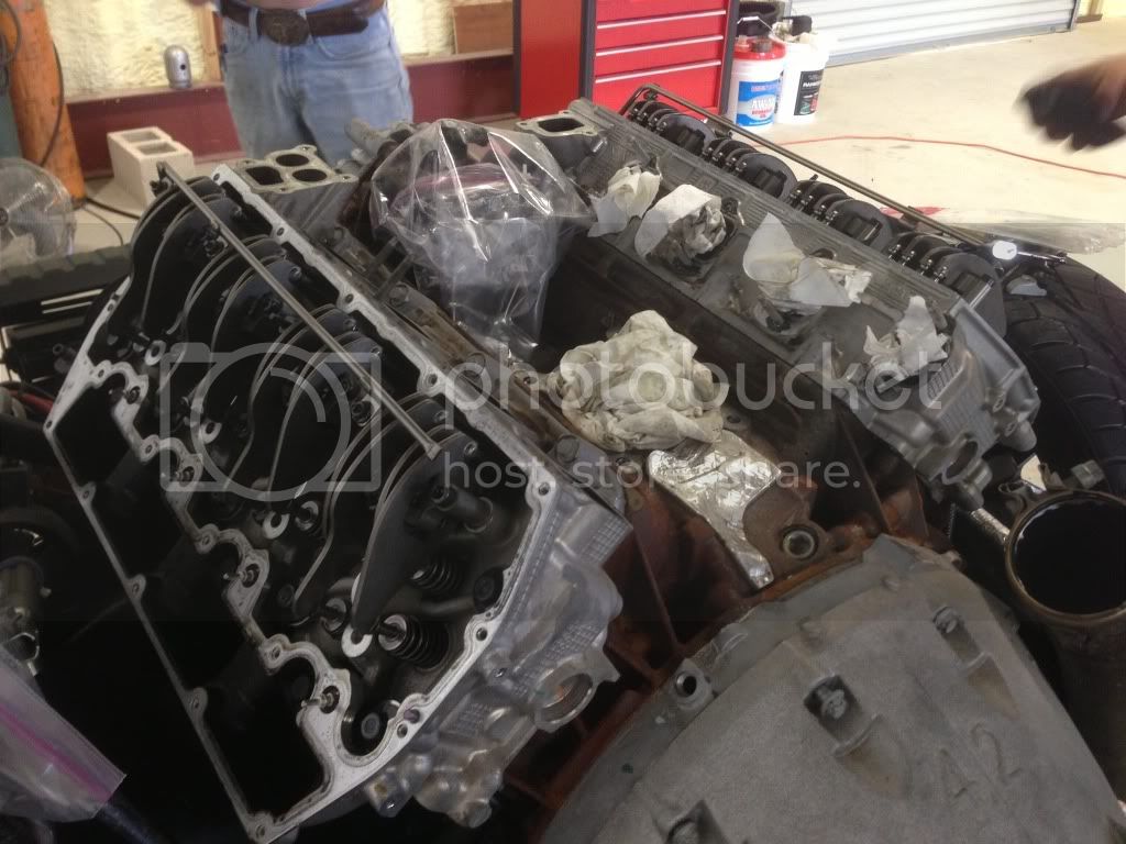

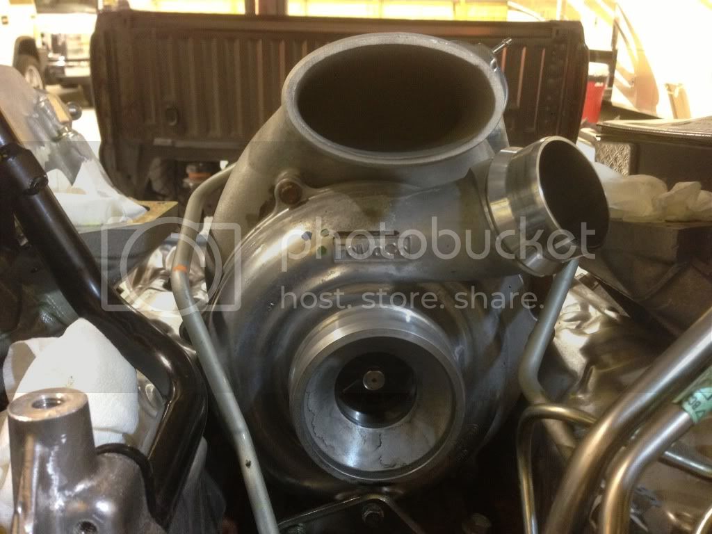

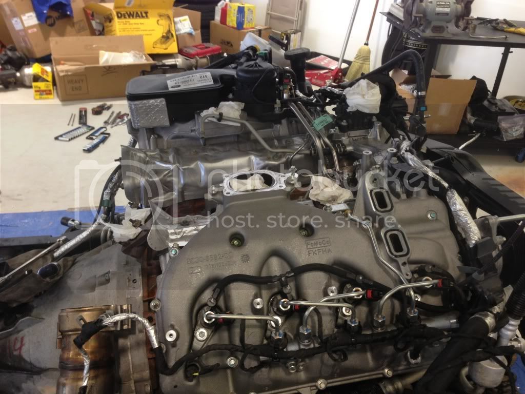

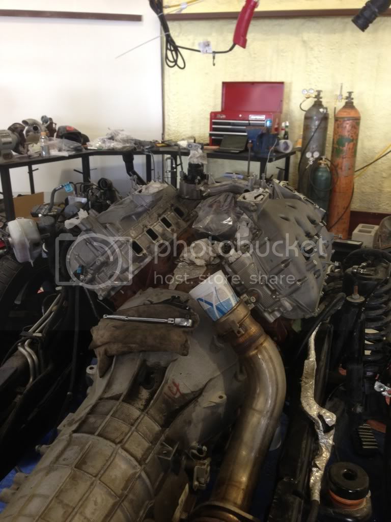

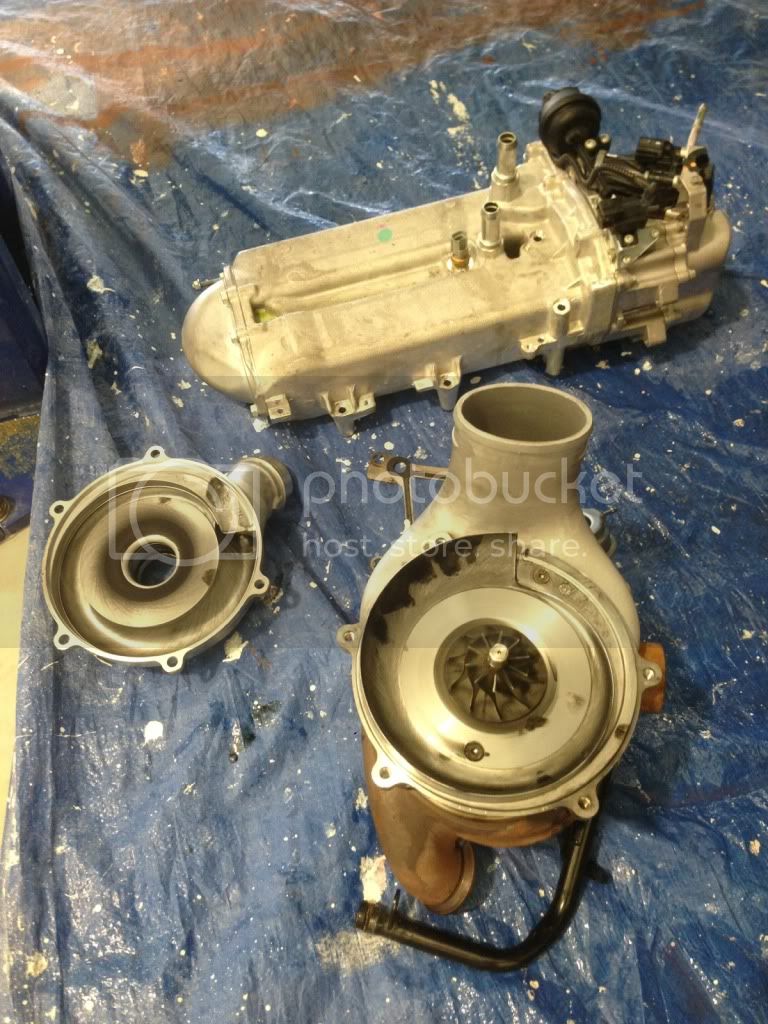

I know that for the past few months, Super08Duty (Colton), Younger1993 (Morgan), and myself have been stirring the pot with rumors my 6.7 being built. So this is our official announcement of our 6.7 powerstroke build!
The truck will start off with the very FIRST Elite built 6.7 long-block, As well as the very first Elite built 6.7 trans.
As for power, we are building and fabricating a unique compound setup that will be fueled by H&S motorsports Dual fueler running a cp3 over cp4 setup. The low pressure system is still in the works but at some point will be released on this thread. I along with the other guys are very excited about my build and cant wait to see what this truck can do for the 6.7 world.
We have already jumped into the tear down and are currently awaiting the long block from elite. Pics will follow shortly. :rockon:

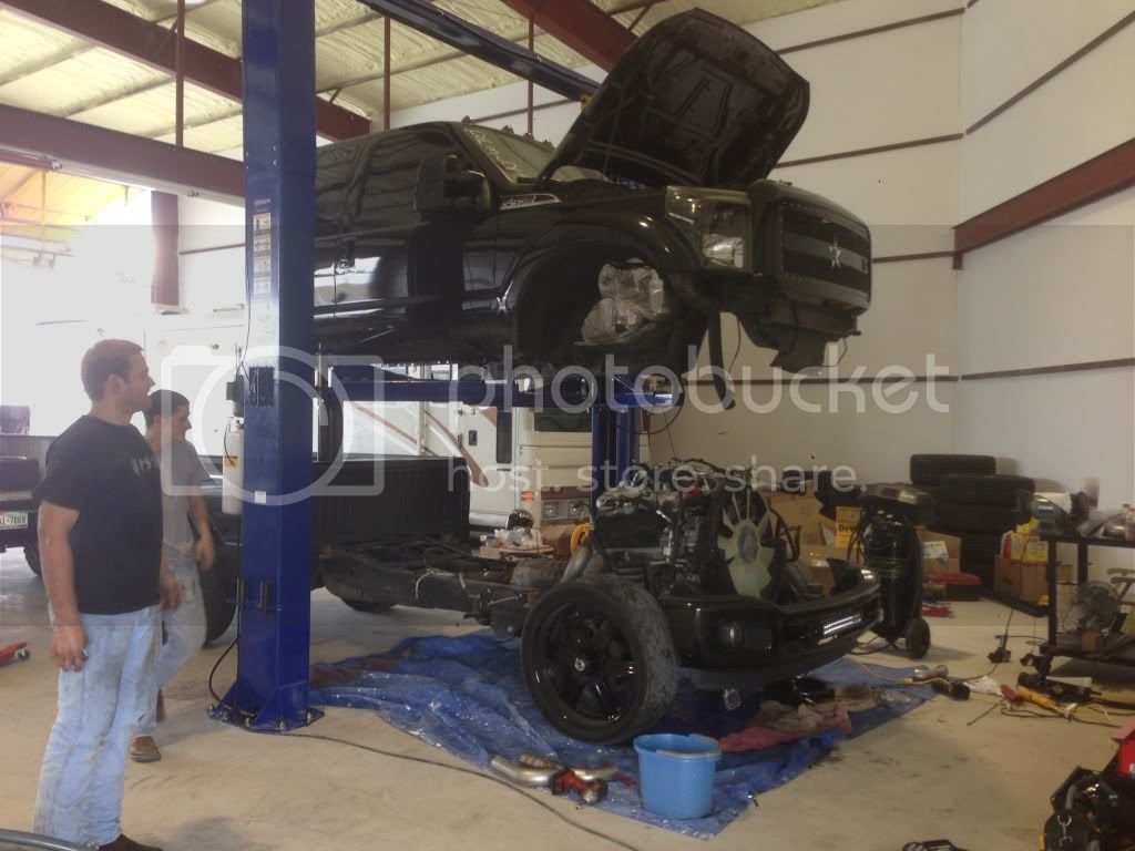

Probably about the same. Pulled it in a few hours. Had an issue with a stubborn cab bolt but that was it!

Yup bolts are the same as the 6.4. We had to get inside the truck and pull carpet to get to the nut on drivers side. Then used huge cheater bars to get it unbolted.

Probably about the same. Pulled it in about 4 hours exactly. Had an issue with a stubborn cab bolt but that was it!
6.4s are about an hour. 6.7s should be close to that. Took us awhile because I only brought a lunchbox worth of tools. Cab bolts by hand take forever.
