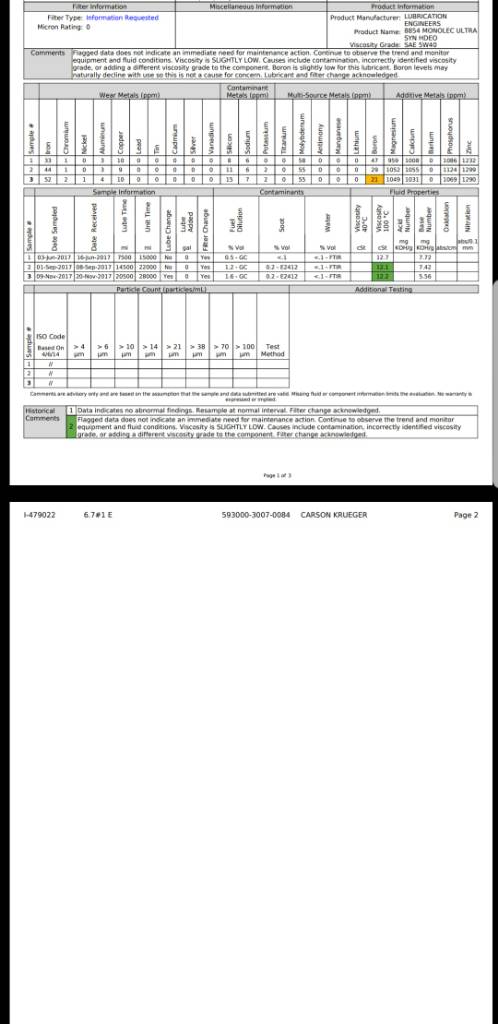

I ran 7500 mile filter intervals and ran my 8854 out to 20.5k. Analysis showed good results so I will keep doing it.

Where do you get the oil analysis? I'm about 8k on my oil. Could I just change out the filter and send that off for an analysis?

Running it to 5k isn’t extending the OCI. Why aren’t you going to 10k? Make life easy and do oil/fuel filters every 10k?

Black stone is where I send mine.
Running the same oil. I changed filter at 7500. I’m at 10k now about to send in a sample. I might do 5k filter changes next time.

I just sampled at 10k with Schaefer’s and an amsoil bypass. Blackstone said filter and oil are clear for another 3-5k. Last oil change I spent a lot of time in the south Texas dirt, they asked for filter change at 5k.
Blackstone can tell by contaminants if you need a filter or not, I trust their advice.

Blackstone is not an ASTM certified lab. ICP can only pick up 1-8um, so it can not guide you if you require a filter change and does not give you any clear picture of delta p over the filtration media. Its better to stick close to OEM full flow Filtration PMs.

Those are some big words, but I think I got it. I’m running a big spin-on filter (FF) that has about twice the surface area of OEM according to specs. I assumed that would translate to twice the OEM FF interval.
