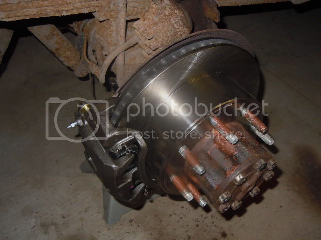

Brings me to where I"m at now I am rebilding the brake system. Front and rear Calpers With brackets, front and rear rotors, front and rear pads. And add in driver"s side upper and lower ball joints, and drivers side wheel joint. Here some pic"s

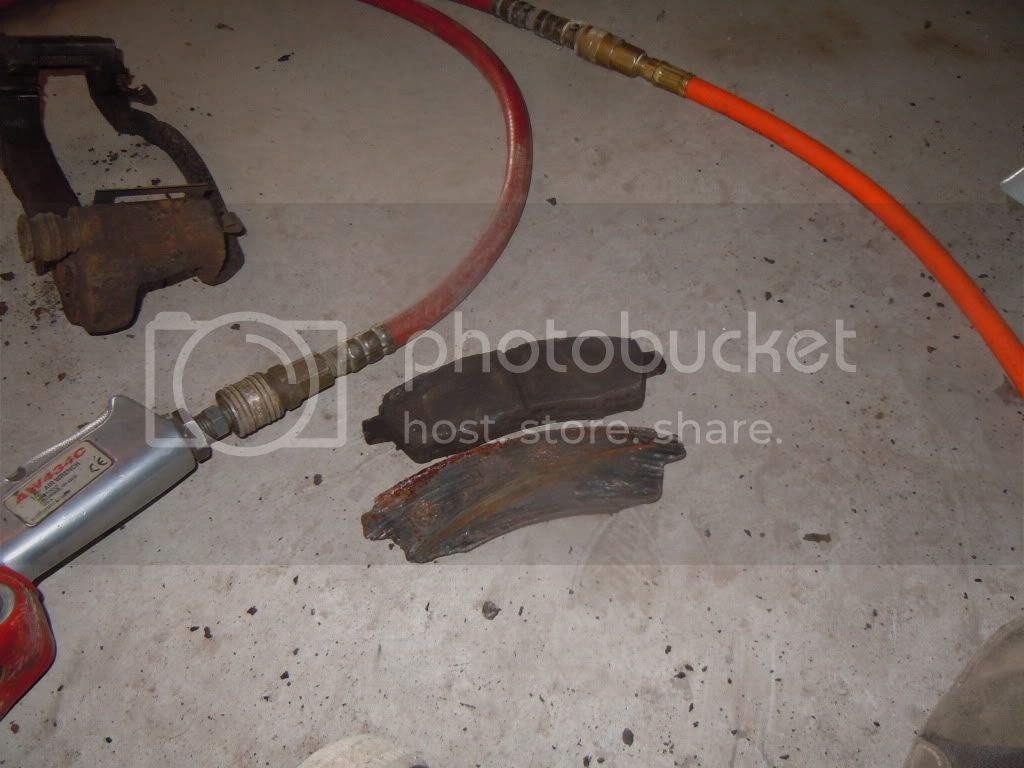

Had to go buy damaged bolt kit just to get the dam locking lug nuts off

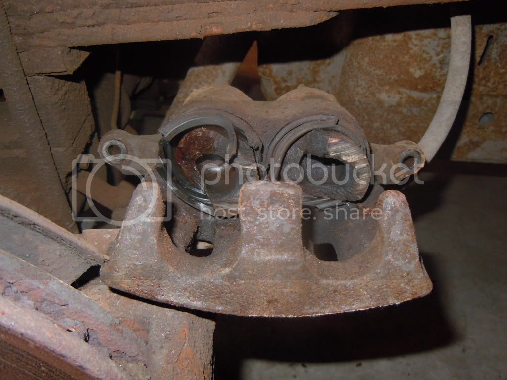

do we see a problem here??????

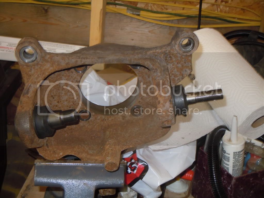

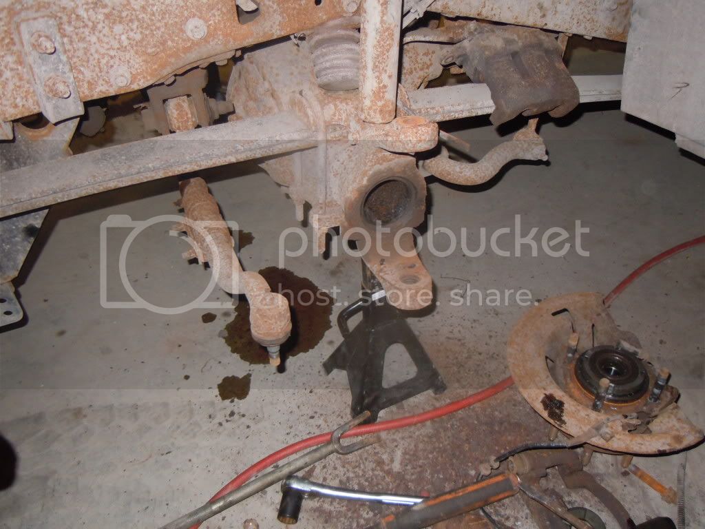

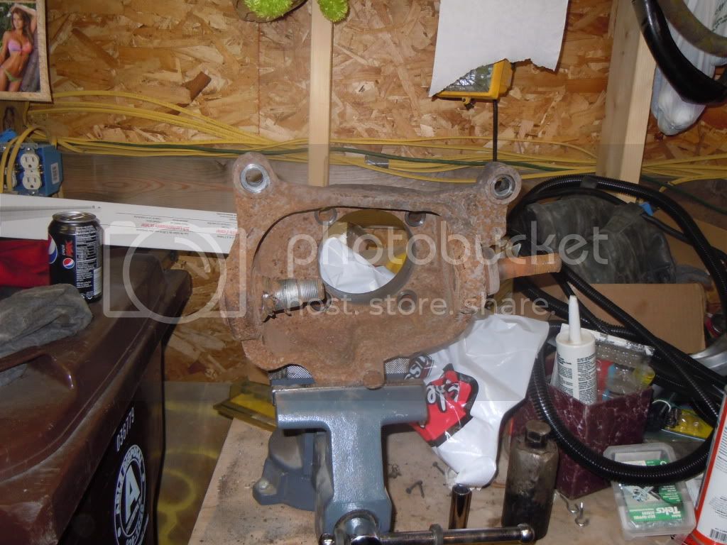

Then tore the kuckle down to change ball joints
All the new parts OUCH!!!!!
I got a set of stock rims for it with the wrong center caps but we"ll see if they work
Changed ball Joints

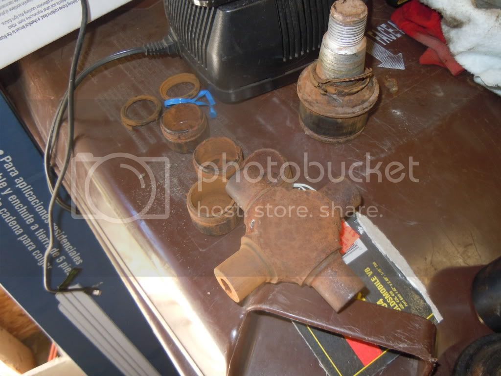

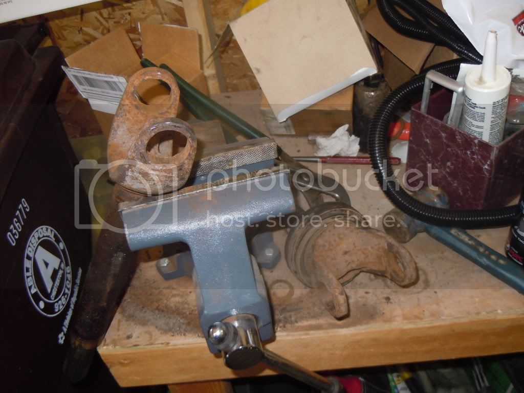

Changed U joint
Forgot to take pic befor I put back together

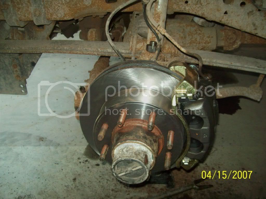

Got the kuckle put back together
And got most of the brakes back together
Still Have to hook up lines and finsh driver"s side front

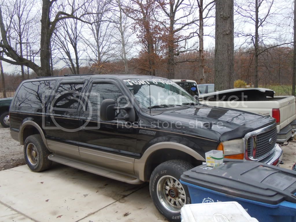

A few pics of my X with the plow
