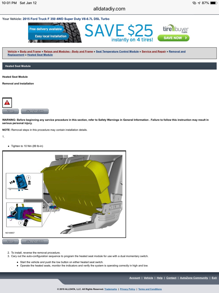

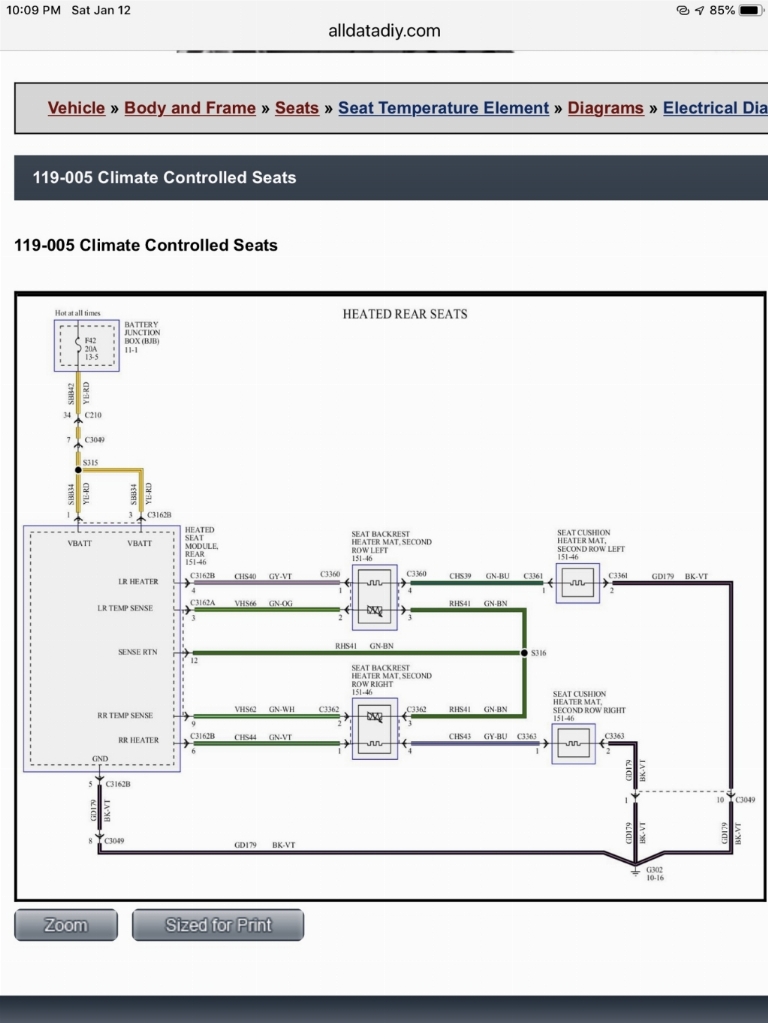

Does anyone have the wiring diagram for the rear heated seats? I had to clean up a spill so I took out the seats and now none of the heated seats in the rear work. All of the connectors are the same profile and they’re a PITA to get to. I’d like to know what plug goes to where so I only have to take these out one last time.

Is this what you needed. Let me know.
