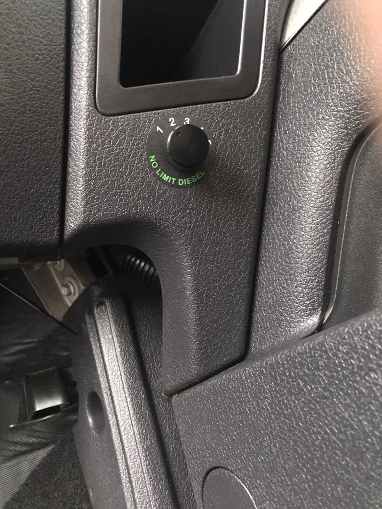

I got with no limit fab for the ez lynk and sotf switch with his stage2 intake to top it all off.

I loaded up the 40-200 clean sotf tunes. The thing drives like stock with way more power... i cant say i notice alot of change between settings but when its on 5 you really know. Even on 5, it barely smokes at all which i like. I leave it on 1 typically as i just go back and forth to work most the time and im seeing a solid 14.5mpg in stop and go traffic. Towing 13-14k on level 1 is effortless. Nothing gets hot and has tons of power. Exhaust brake kicks ass too. Same trailer same route my 6.0 would get low 9s for mpg, and i would have to baby sit the egts and smoke output. I cant comment on egts on the new setup but setting the cruise at 70 while towing was no issue, some steep short rolling hills and it wouldn't even flinch. And got 12mpg

Where do you plug in the wires for the SOTF? I have a GTX with Tyrant I am going go install on my 2014 F350 here this week and the instructions seem to leave that part out...
It taps into a sensor, look up EZ LYNK SOTF installation on YouTube and they show you how/where to do it at
Idk if the 14 & 15 use the same place to plug in for the sotf switch, mines using the charge air temp sensor, but I’m pretty sure some use the fuel rail pressure sensor.
