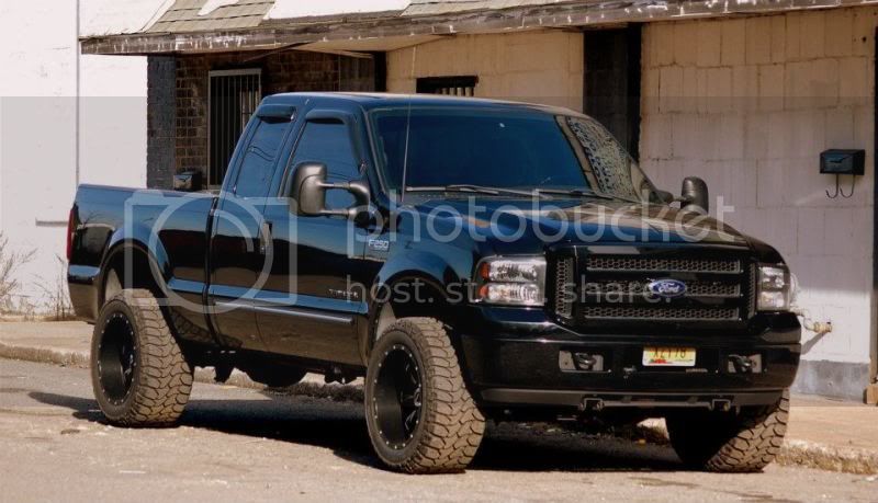

UPINSMOKE's Avatar
UPINSMOKE UPINSMOKE is offline
Major
Member's Gallery
Join Date: May 2011
Location: Dundalk, Maryland
Posts: 1,373
Default
Quote:
Originally Posted by TyCorr View Post
Having spoke with him at length last summer, I can assure you he has a 2k ec/sb f250 with STOCK suspension, no leveling kit. He told me it works 100% if you tie the inner fender liner back.
Since he has a truck and you an excursion his input wouldnt tell you much more. Go to.the search window at the top right of the page. Search for his username and pm him.

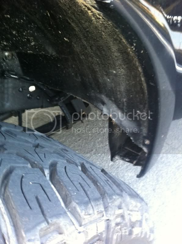

Basically they covered it. I have factory suspension, but I will say after having a plow hang off the front of the truck for many years my springs arent as strong as they used to be. My tires are also 325/50/20, so a bit wider. Wouldn't show much difference on a 12 wide wheel though.
Here is a picture of how much trimming I did. I have since cleaned it up so it doesn't look as bad. But it wasn't too much. The passenger side required no trimming in my case.

... That looks great ! ... everywhere I've went both locally and online , Ive come across nothing but ignorance when explaining what look I'm trying to achieve
Thanks again fellas , Much appreciated !
