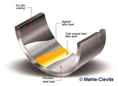

The only place brass colored materials are used in the motor is bearings. All rotational, turbo, cam, and lower plating of the main and rod. I'd check turbo play but that would not cause loss of pressure. I've never disassembled an HPOP to see the material within, but checking the IPR screen may be an easier way.
