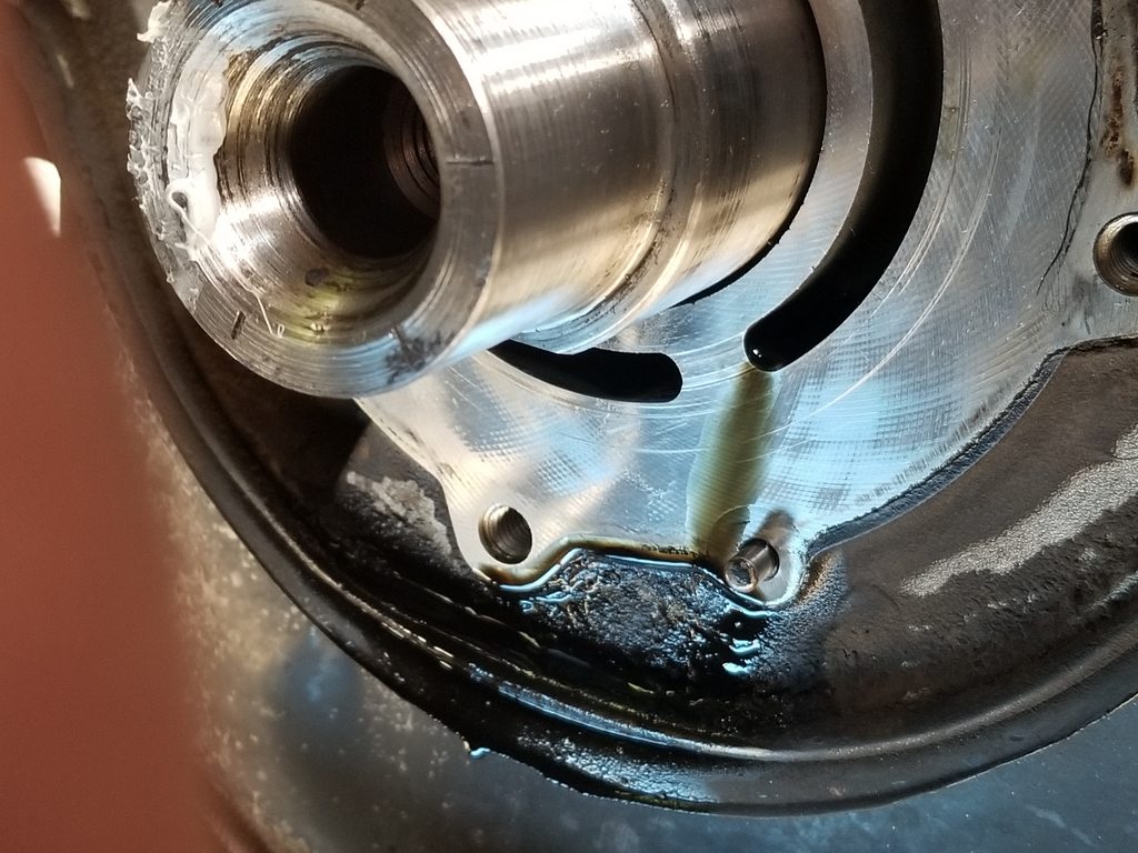

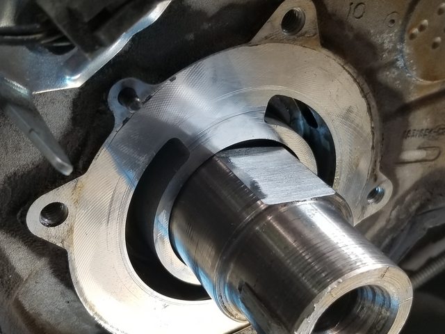

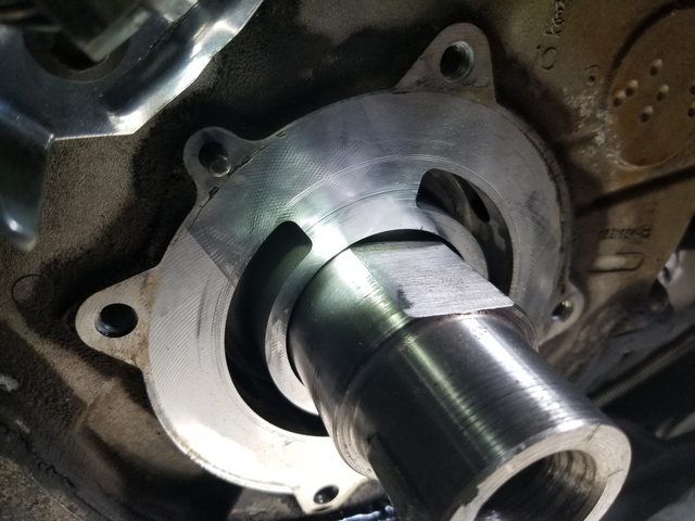

found this today - thoughts?
looks like someone's been in here, and dropped the inner gerotor:

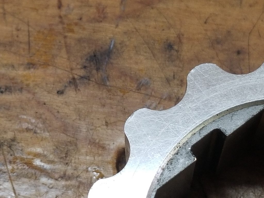

Can you feel the scoring with a fingernail or a pick? What do the face of the geara look like?

Dont think this is the issue.
Fix the bleed down in reservoir.

is that front cover really fine?
where is my reservoir oil going? injector o-rings? reservoir gasket?

The front cover is an issue, I feel, but as ctc said, its not the reason for bleed down. Injector o rings, pump, any number of things will cause it. You will need to air test it to verify where the leak is.
