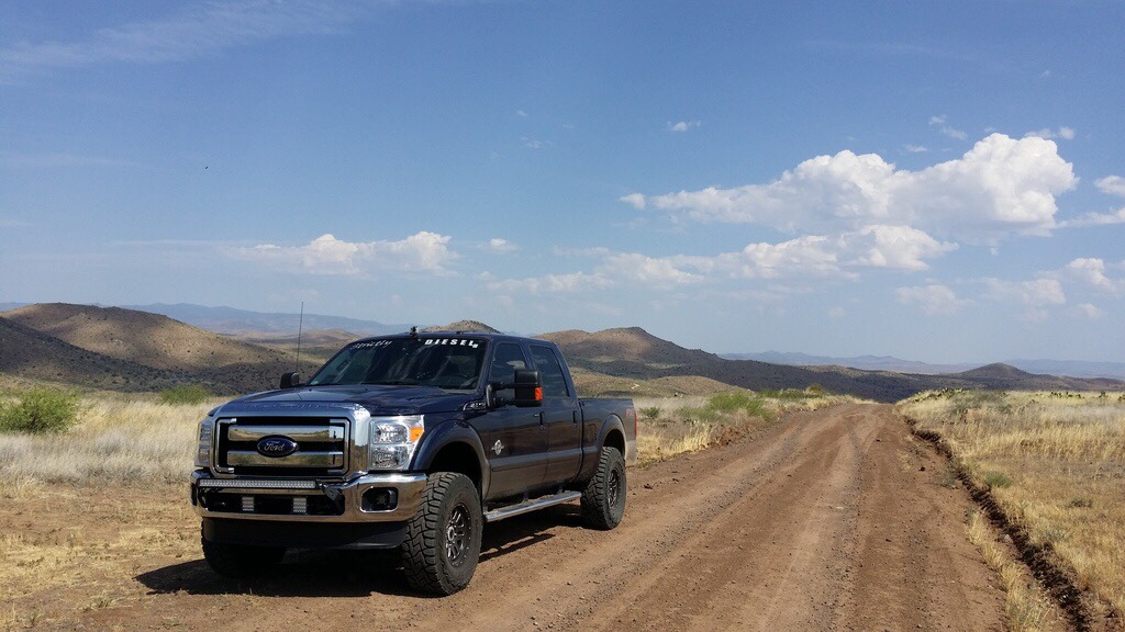

I've ran 37s with a 2.5in CARLI coilover setup. Mileage went to 12.-13 With Emissions.
Rims had 5.5in back spacing and zero offset. I also had CARLI radius arms so I didn't rub there, only rubbed the fender liners in which I trimmed. And had the tire hit the fender corner in a extreme off camber off-road situation. Very hard to duplicate.
I personally would go to a 35 only. Better MPG. And zero rubbing
