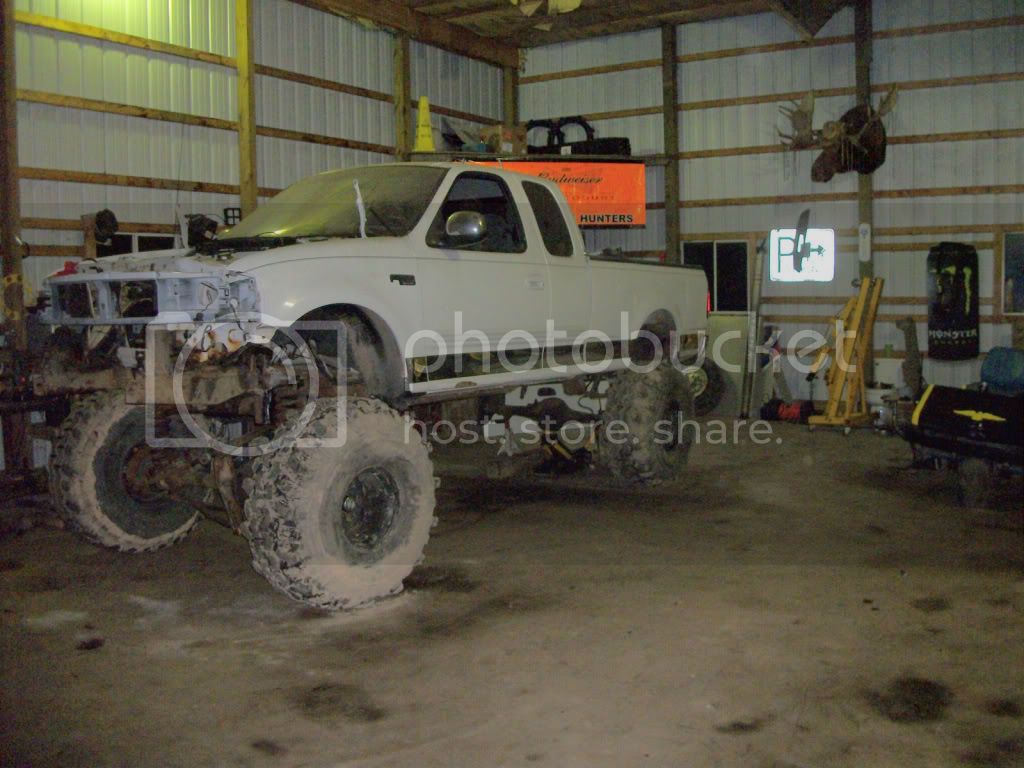

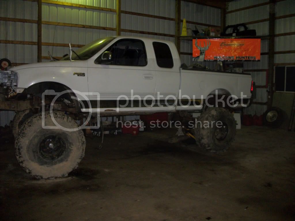

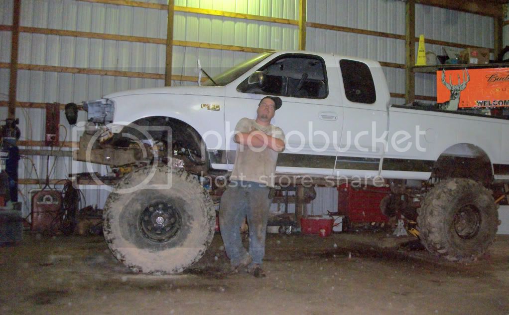

Here it is as of now. I got the axles under it. I need to throw some exta leafs in the rear to level it out and its getting a 3in body lift.
This is with the 44's under it. I'm pretty sure I will have to clock the Tcase. I am keeping the BW alluminum for weight and the low range ratio over a np205. The front axle has a lot of castor due to the 35 degree pitch but it will not be on th road ever,just mud and trails.I'm hoping its alright but I needed it to be at enough angle to keep he front drivshaft happy.

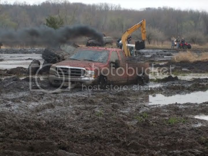

Here is the mud truck I bought and robbed the tires and drivetrain from.Same setup i'm gonna run except with a different motor.
That is a 302 dana 44 and a 9in all stock except for gearing. its even a TTB dana 44.

I remember seeing pics of it a couple years ago on psn. Thats the same thing I'm trying to achieve here. just a play rig for the mud so I don't do this anymore with the stroke

That is a great pic. Powerstroke blowing smoke and carnage next to it. I had 8 lug dana 44 with 4.88's and running 36's. Putting 40,000 miles on it a yr did it in. The metal holding the races in for the wheel bearings kept wearing out, and I couldn't find any replacements. So in went a dana 60 from a Ford, it went into a 95 chev 1500. LOL

Sorry to derail, but am I seeing things or is that excavator really up to the cab in the mud?
