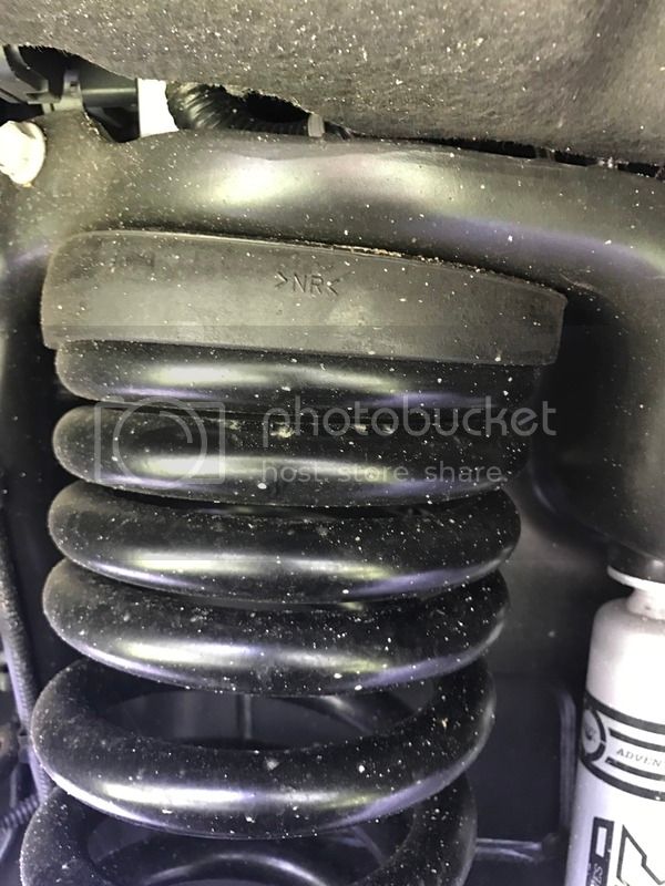

Has anyone ran into an issue with icon coils making excessive noise over bumps on a 2017? I know you are thinking how do coils make noise, but I've noticed with the progressive rate springs, the softer top coils are like an 1/8" apart just on the drivers side and constantly clank over the slightest bump.
I pulled my hair out for months trying to locate this noise after I installed my leveling kit. I started with the usually culprit, the track bar, and that's torqued to 450+ ft/lbs. checked the shocks and caster shims which were all tight. Even thought the lug nuts might have been bottoming out on the stud before they were tight so I swapped them out for longer ones. Had the lug issue on my previous truck and it's an uneasy feeling when I took them off to see all the lugs split in half.
Here are some pictures. Notice the slight gap between the top coils
Now this was my remedy. I wedged some shims between the tight coils and went for a ride and to my surprise, silence!
Anyone seen or hear of this before? The ride is great but the noise is horrendous. I hate to pull the springs but I see carli coils going in real soon

Let's try this. Here's a pic of how tight the top few coils
My remedy with shims. Only lasted about a mile but it was a very quiet and no clanking mile!

I know its not Icon but the carli coils part # appears to be the same for the 05-16's and the 17's. That coil definitely looks like its too close together at the top. Pic below is off truck toyz site showing the 2.5" icon coil for comparison.
