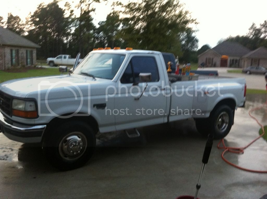

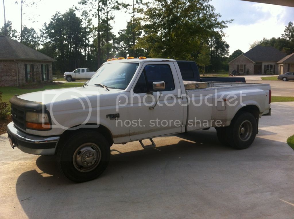

Here is some pics.
First day home
After a quick wash
Steps got removed shortly after the pic.

It was filthy. I took the seats and vinyl floor out and washed it out with the water hose.
It gets tint this week too.

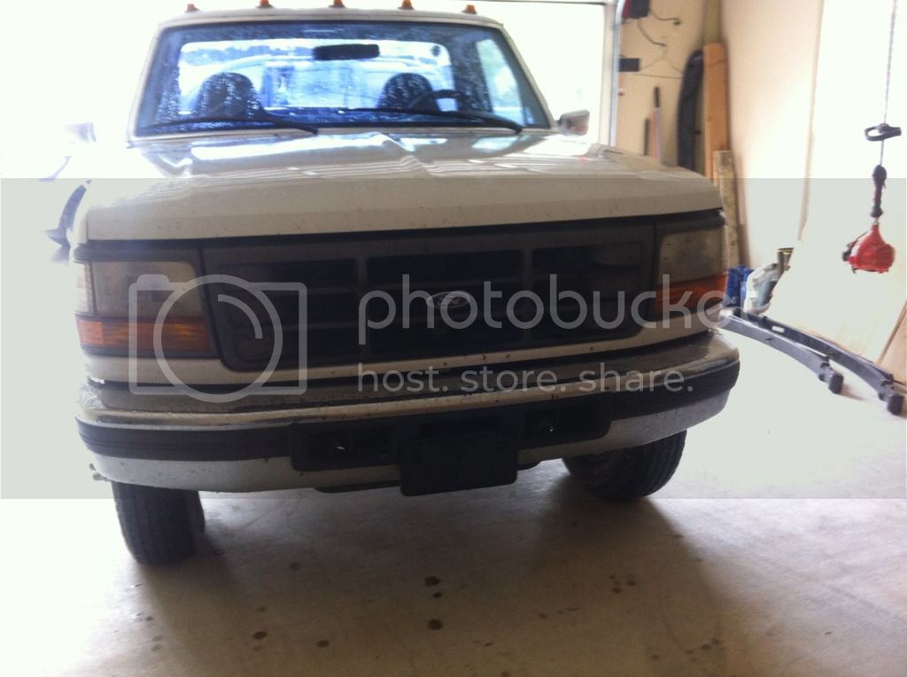

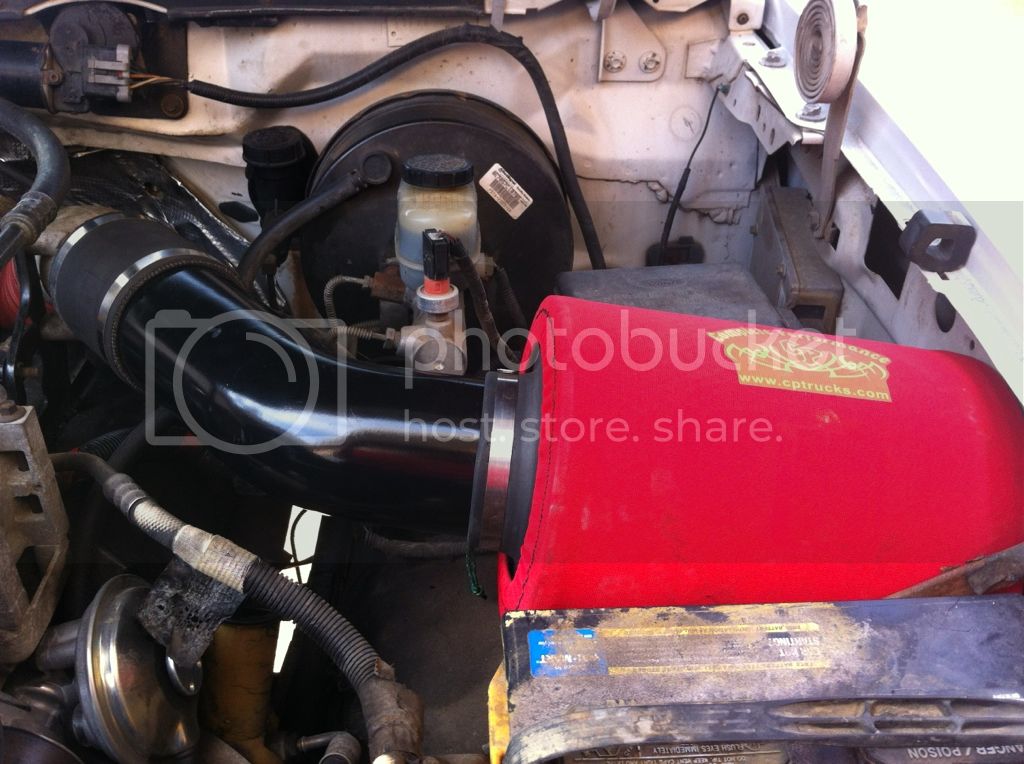

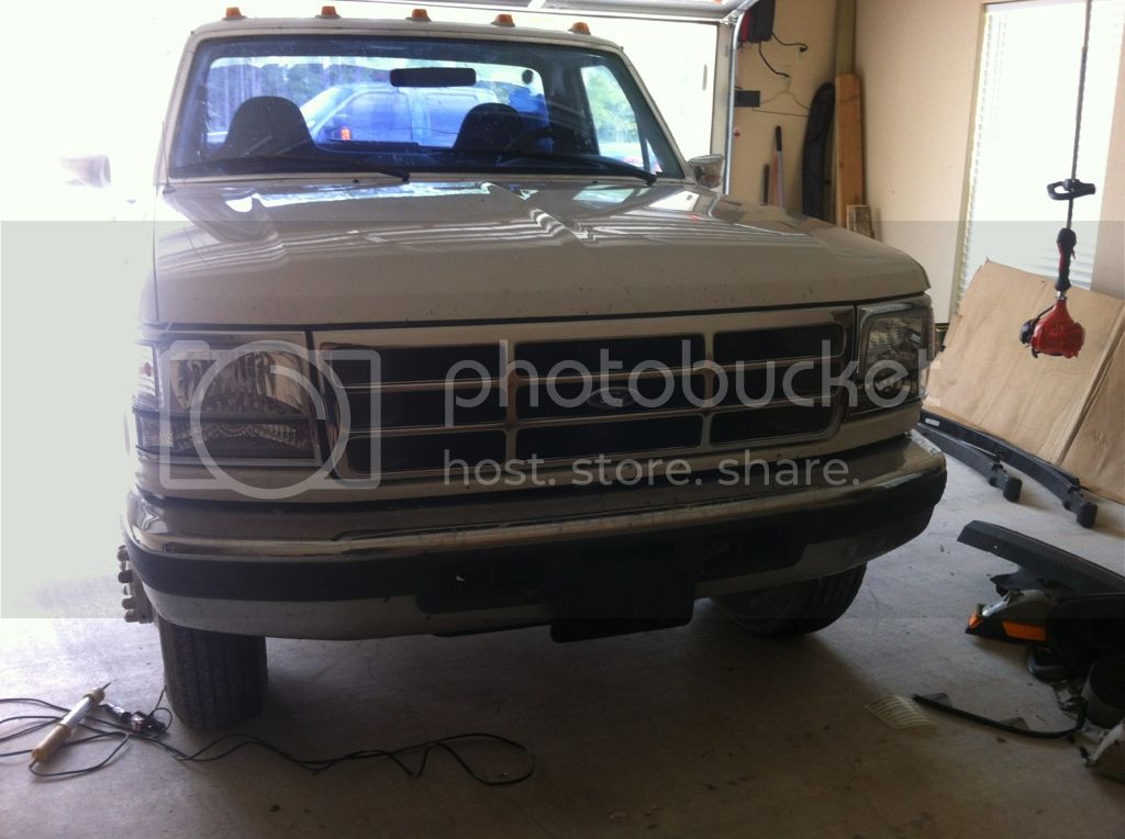

I've been working on the truck for a few weeks now and it's coming together nicely.
So far I've welded up the turbo pedistel where the ebpv was and changed the o rings as well and eliminated the majority of the oil leak.
The 6637 is on. Thanks to Swamps and Paul at CP
Got the exhaust on as well. That downpipe was a pain in the ass.
New headlights, grille, headlight bezels, and taillights
New mirrors ( still need something better)
I have everything to do the intercooler minus the pipes.
It's going in Tuesday to get the 3.55s put in and get rid of the 4.10s
Here's some pics:
Before
After
Intake

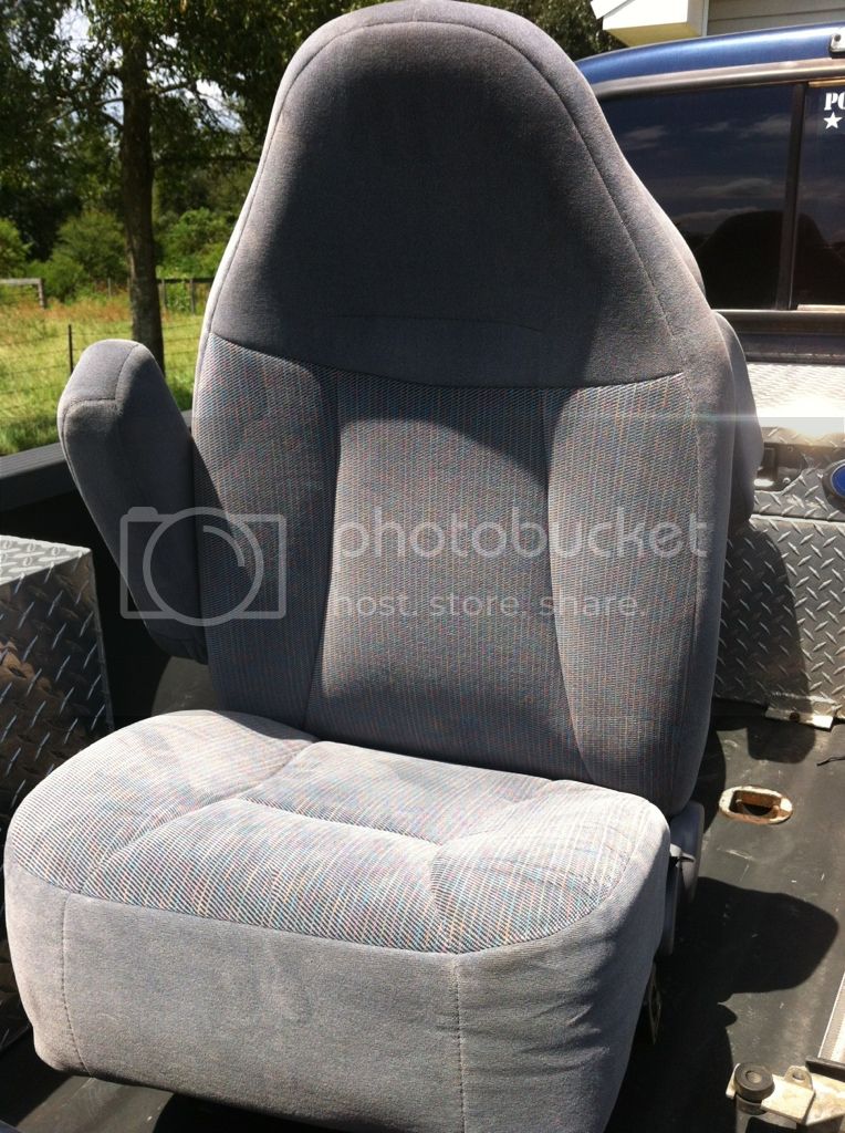

I also acquired these off CL. $150
