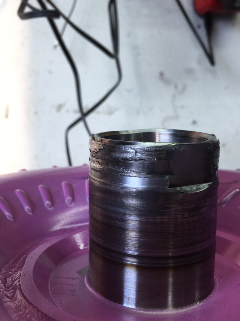

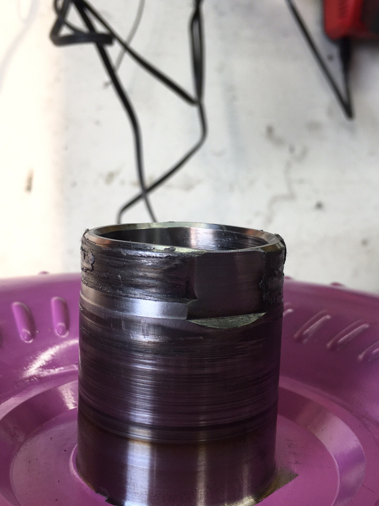

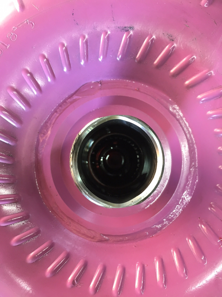

Sounds like the converter wasn't seated properly

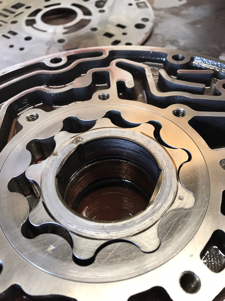

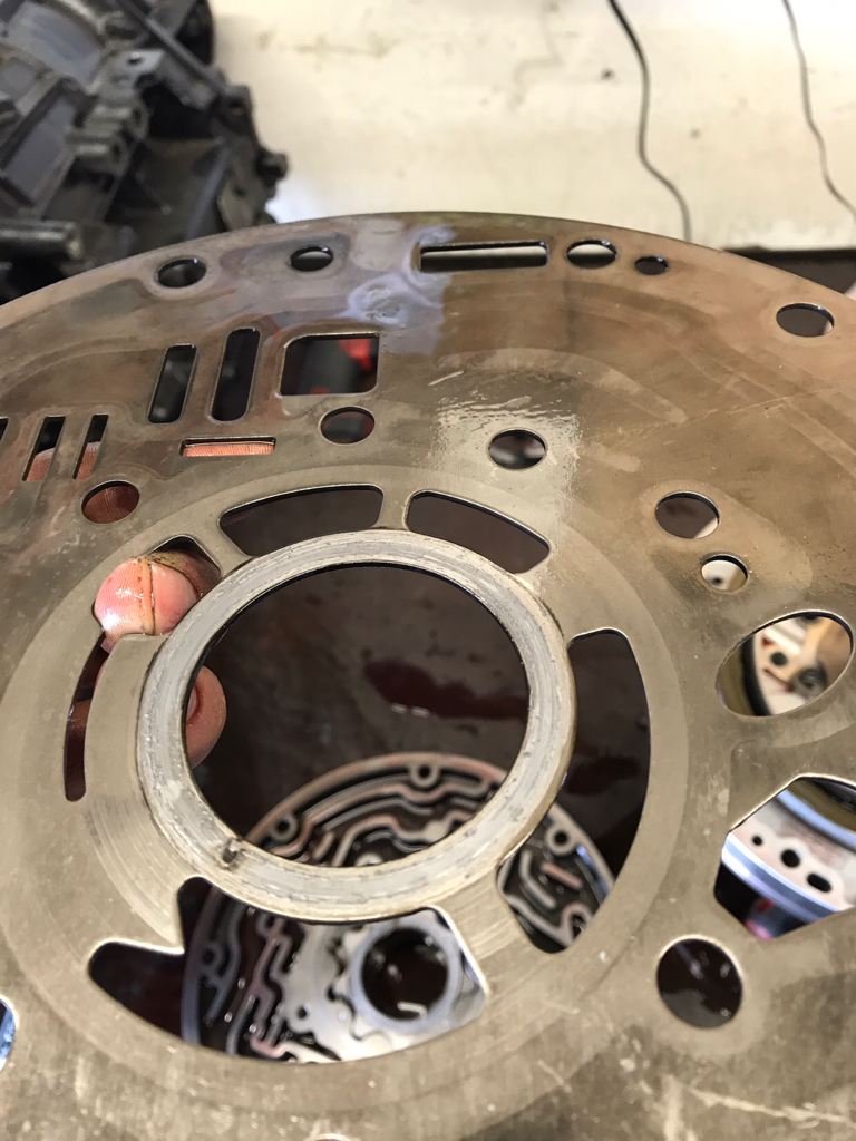

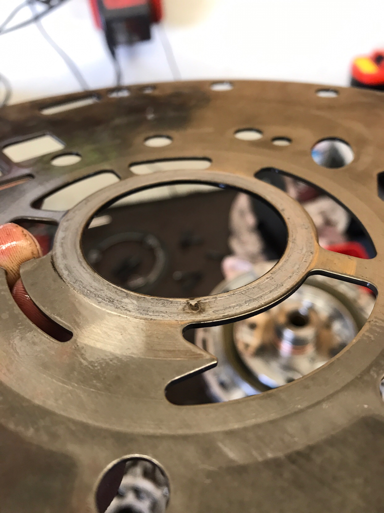

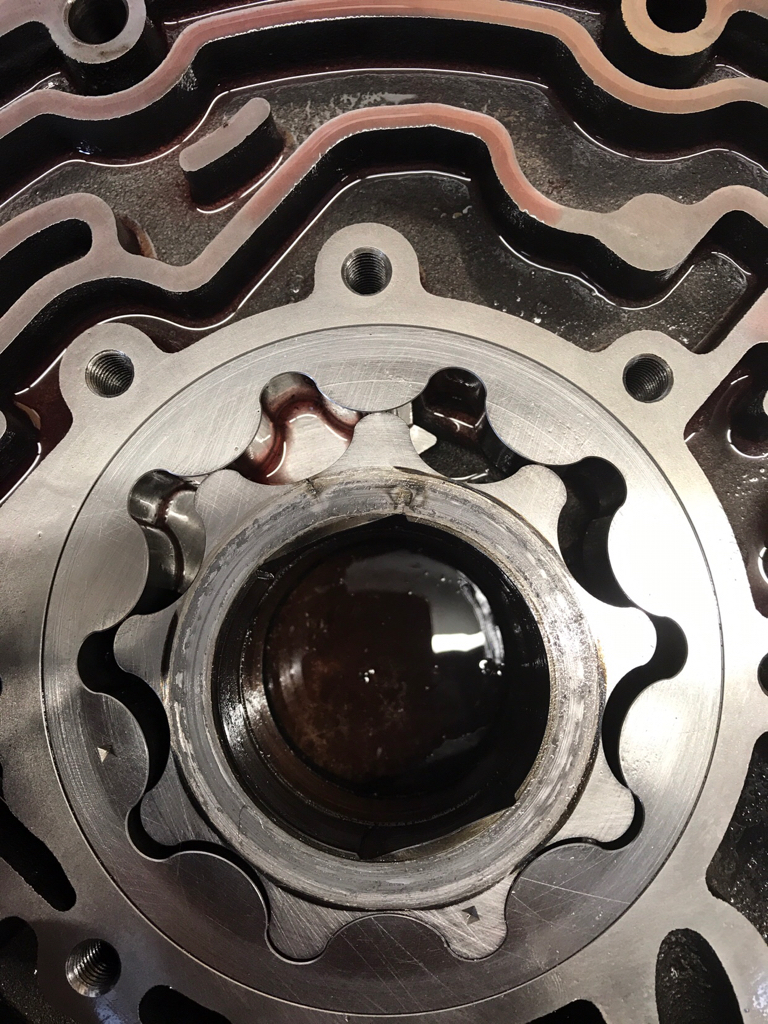

Finally got a line pressure gauge on the truck this week. 0psi in all gears at idle and WOT.
Still think the converter wasn't seated properly sootie? Or could the front pump have decided to take a chit.

Sounds like it wasn't seated properly. The converter is what drives the pump. Pull the trans and converter you will see the converter all chewed up.
