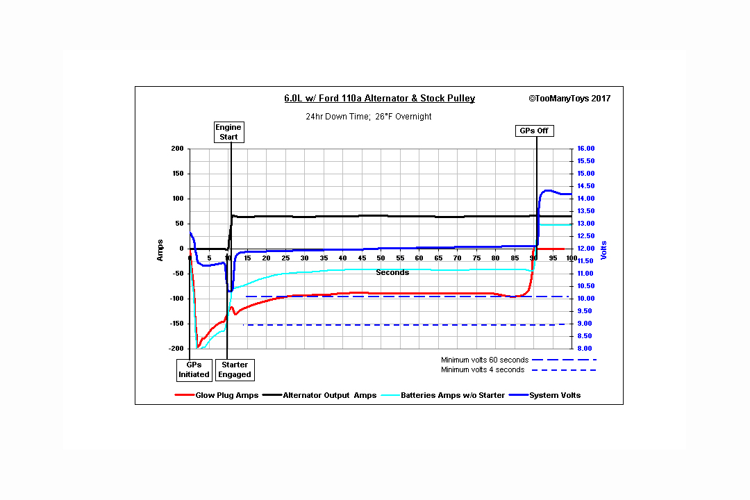

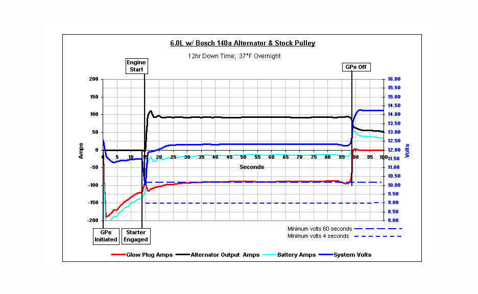

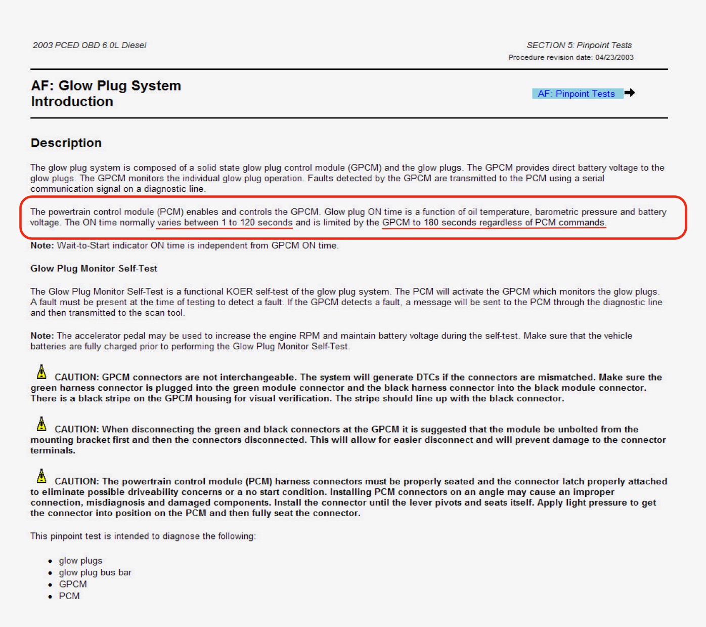

Depending on the alternator, several different voltage regulators could have been installed. If the VR is one with a higher voltage setpoint than 14.4v, even with a lower output current alternator, you could get the GPCM to cycle on and off due to the voltage.
The details from the service manual how the system works, and three graphs showing the voltages you can expect from different setups you've mentioned. |

Cold, the alternator post to alternator frame reading should be in the 14.2 to 14.4v reading. It can drop per design to 13.8v with the underhood heat. Putting a clamp-on ammeter on the glow plug fusible links should show the ON timing as well as checking a glowplug votage, but you are reporting a longer than normal time. Three minutes is the program maximum, but in NJ, I don't ever remember seeing that. Any chance you have dual alternators? |
