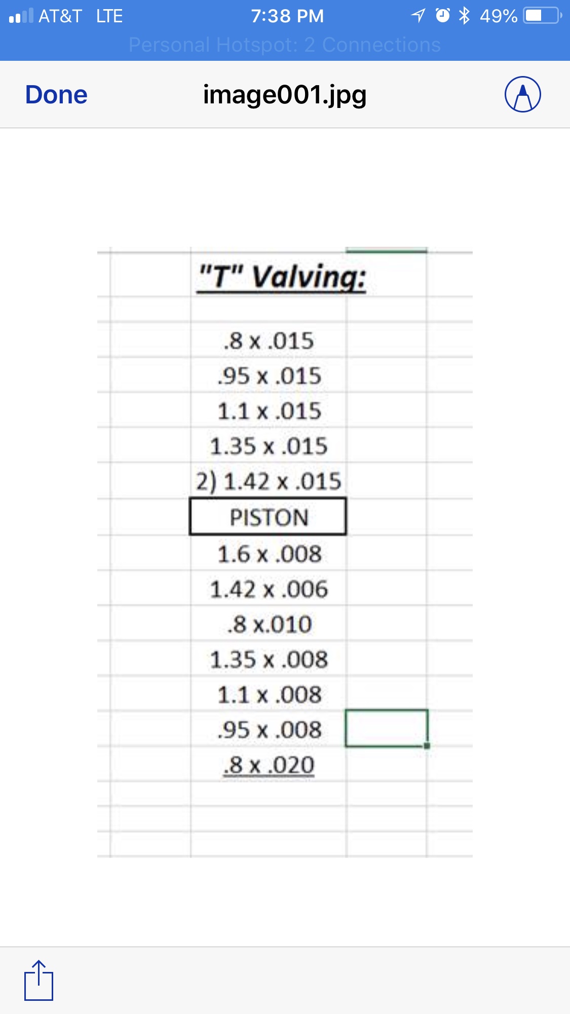

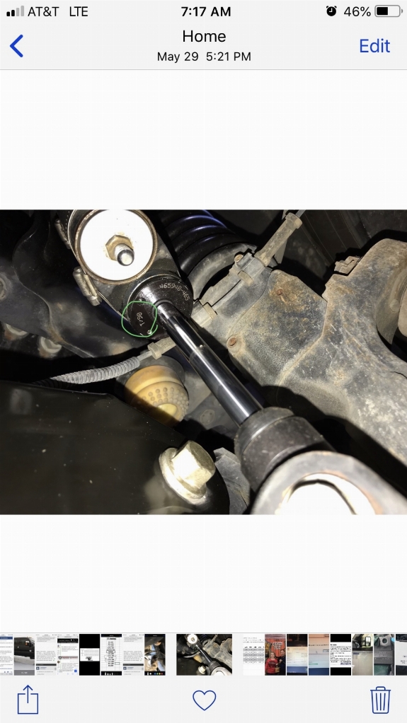

I have an F-350 CCLB Dually(yes) air bags in the rear, stock springs and Fox 2.0 performance with reservoir on all corners. That I use to tow a 16k fifth wheel with. Valve code on the dust cap is T/90, which from what I’ve gathered is something like a (flutter compression)30/90(rebound). The issue I have is the truck will dip in slight hole and the compression is not fast enough on the coming out so it bounces out. Yes I’m aware “it’s a truck” but I believe I can make it better with a few changes. So I’m gonna re-valve, which any body that has tried will say it’s tough to get it right on the first try.
So of course call Fox and see what they say....... “the piston I have is a single bleed .070 and code was last updated in 2009. I should add .070 bleed to all pistons and change the compression side to #50 in the rear(to work in conjunction with the bags and change compression to #70 in the front......i could be wrong(hence why I’m here but)I would think increasing the stack thickness from the .008 to .012 would have the opposite effect of what I’m trying to achieve. Making compression stiffer. Hoping somebody has a similar setup(stock springs/aftermarket bags and 2in shocks) that wouldn’t mind taking a peak at their dust cap(where the shaft goes in and giving me some idea of what I should be going for.

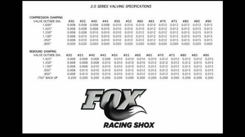

No one? Well I guess I’ll do some experimenting. I talked to Fox again today and there actually was a misunderstanding of what I was after. Said “Adding 2nd bleed port would allow a lot of low speed, we want to use compression to control it. So use a #50 stack(0.010) and keep the same flutter pivoting on a 0.008.” I have riden in the truck and know how it feels and what I believe it should feel like, can’t help but think increasing to a #50 stack would yield a similar performance to what I’ve got now...Being that it takes all of 15 mins to rebuild a shock I figured why not just toy around, see what I can come up with.
Got a few things to do tomorrow so want to leave this here in the hopes someone that knows will tell me “ hey you’re screwing up” or “yea looks legit”
Here’s what I’ve got so far.

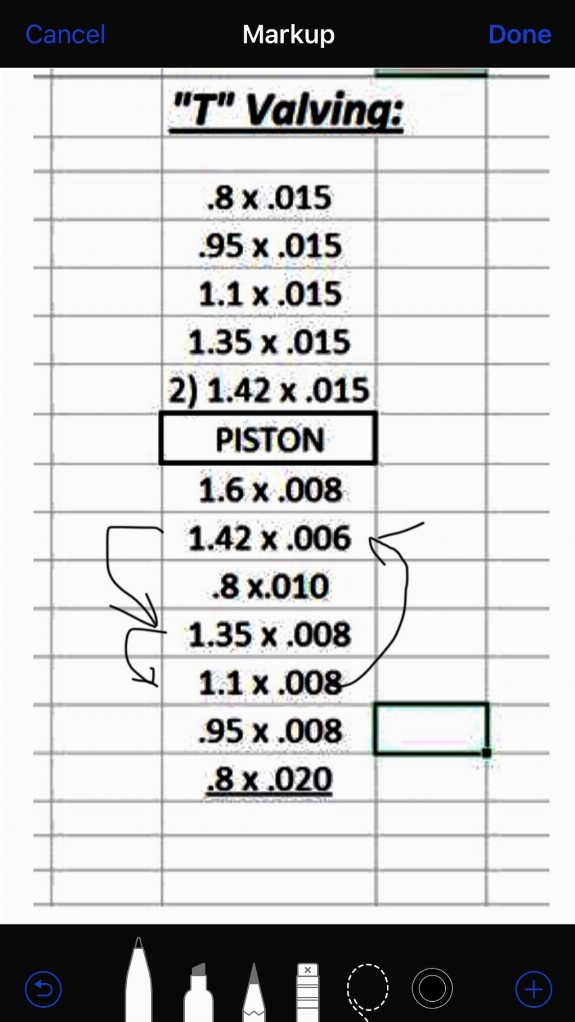

Move my thinnest 1.42x.006 to front to allow more flex and flow
Move my 1.35x.008 to the second position for support
Leave the .8x.010 for pivot
Move my 1.6 to the 4th position to give the flow leverage in the high speed as well as support for the “front line” so to speak.

I changed the shims around to this configuration and drilled out the bleed hole in each piston(per Fox).....smoothed out a lil bit but I can’t stop there lol. still has a jitter in the rear end sometimes. seems to “float” better now the front wants to rock when turning slow up an incline. Not bad just more noticeable. Can’t seem to find anybody that’s happy with their setup and willing to get the valving numbers off their dust cap, so searching and searching some more. I did come across a dodge forum where Don Thuren from Thuren Fabrications set a dually up with 40/100 in the front and 20/120 in the rear but unsure of what dodge/spring rate/weight or how he stacked them. I wrote him on Facebook but he hasn’t responded.

Ok after I’ve spent about a year trying to get my 13 f350 dually to ride better on 22” wheels and 34” tires I’m willing to put some of this out there on how to re-valve Fox 2.0 reservoir shocks and changing the bleed in the piston.
Plenty of videos on YouTube that explain the process better than I can. But it’s real easy to do. You can get your local 4x4 shop to refill the nitrogen if you don’t have the nitrogen bottle setup yourself.
I changed weight from a 7w to a 10w shock but not sure if it was needed.
Cheapest place I found to buy shims is Kar Tek a $1 a piece or stack for $6/5. For my .004 shims I bought .004 shim stock and turned them on a drill press(lil overkill but I got obsessed with it at one point)
If anybody wants to tackle it here’s what I did.

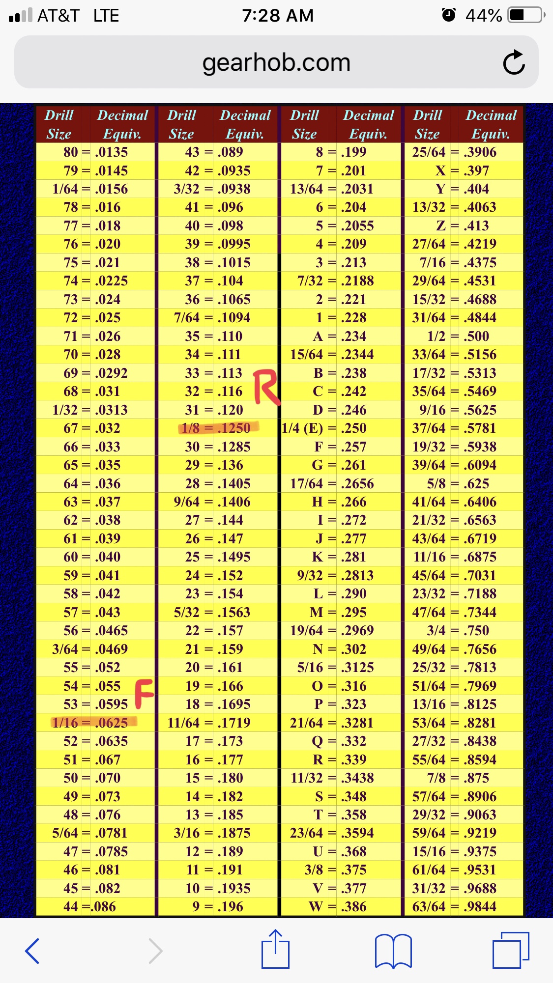

My pistons came with a single .70 bleed hole front/back. Front rode fine but it felt like it had too much body roll when hitting a bump/hole while turning into a driveway, so I went down a little. Filled it with JB weld(caped both ends well) and drilled another hole.
this pic of the shims isn’t what I ended up with but is a good way to keep up with changes as you go.
Diagram is....
Rebound
Piston
Compression
Front 27/98 give or take
—NUT
—-.8-.020
——.9-.015
———1.1-.015
————1.3-.010
—————1.4-.010
[a single 1/16 bleed]
[hole in the piston. ]
——————- 1.6-.006
—————1.4-.004
—- .8-.20
————1.3-.008
———-1.1-.008
——-.9-.008
—-.8-.020
——————-rate plate
Rear #20/97(?)
—NUT
——.8-.020
——-.9-.015
———1.1-.015
————1.3-.015
————-1.4-.015(x2)
[single 1/8 hole in the]
[piston for bleed ]
—————-1.6-.006
—————1.4-.004
—.8-.020
——1.1-.006
———-1.3-.006
——.9-.006
—.8-.020
—————rate plate

I just finished adding another 1/16 bleed hole in the rear because I felt my compression stack coming into play a little earlier than the front and would pitch the rear up coming out of slow dips and smooth bumps. Small test drive felt a lil plusher although it had some hard spikes on what seemed like a smooth road but I like to give it a few days to really get a feel of how it’s working. May open it up the rear bleed a little more.
I’m not sure if it makes a difference having 2 of the same size bleed holes vs having one larger than the other. My thinking(could be wrong here) is it’s like pipe you get more velocity from a 4” pipe compared to 2 2” pipes. Something to do with less drag from pipe surface. Being these shocks are velocity sensitive I figured I’d get the best flow from the larger hole. So in the rear right now I have a total bleed of .1719 going by the yellow chart above.
