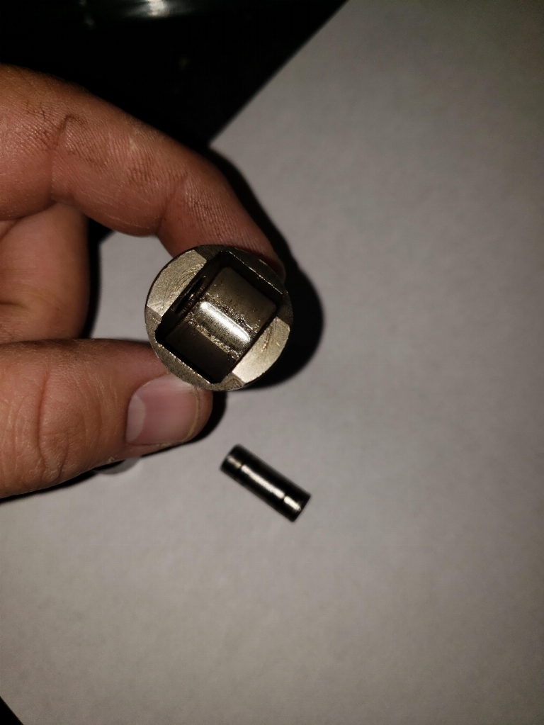

Doing heads on a e series and pull this little guy out. I have seen this a million times, like we all have. But this one was different, well at least in a different stage of failure. I noticed the roller was still in tact but had axial play even with no needles falling out yet.
So looks like a oil starvation caused the needles to seize up a few times (which when happened gave the engine a fish bite) and it appears the roller is being wiped by contact in the lifter housing. Thanks to the wear on the pin. Thus wiping the cam lobe.

The failure goes both ways. Obviously this one was the lifter first. But I've pulled cams and bad lobes and lifters didn't even have a scratch yet.
This lobe was starting to show alot of wear.
Needles seized and ate the roll pin, causing roller to stop intermittently, wearing cam lobe
