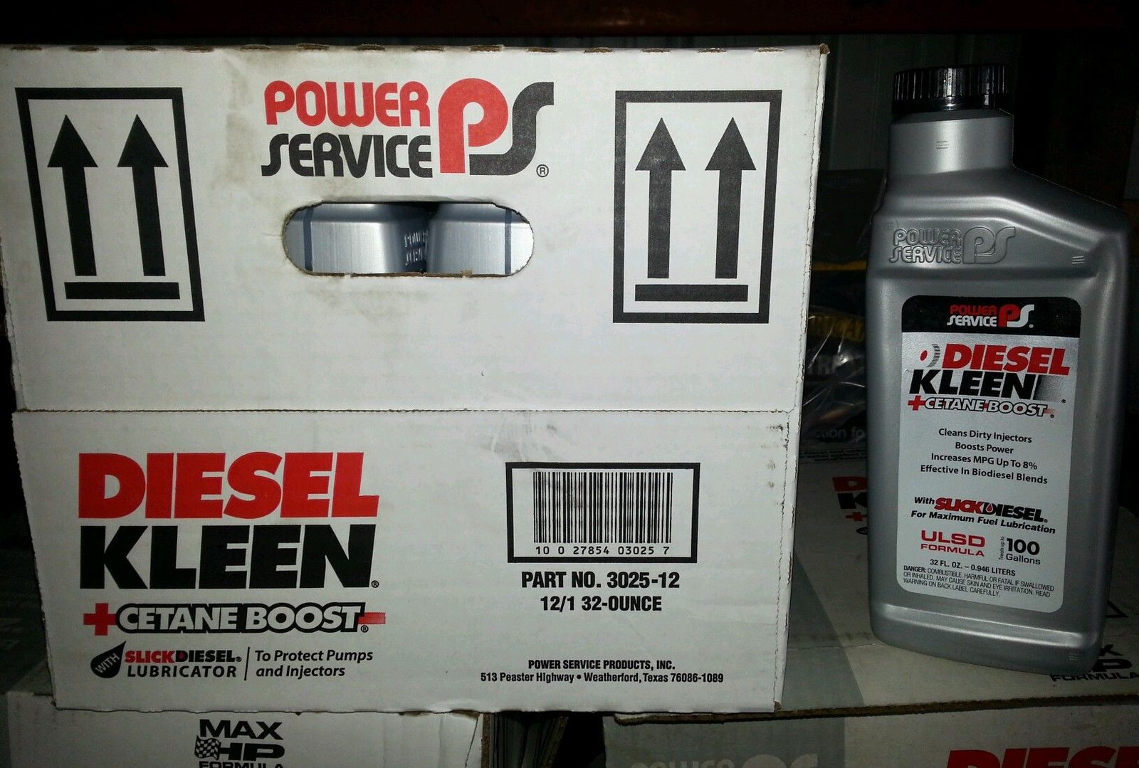

The one that was used is "Power Service Diesel Kleen +Cetane Boost" It's the silver bottle.

Driving it and getting ALL the fluids up to an operating temp would be best as it will help release entrained air and water.
Just to get it out of the way, dieselkleen is a performance additive. It really doesn't do crap for storage. Nor does it inhibit gelling. It is badically suited to raise cetane in crappy diesel fuel and that is it. If you get good diesel, it wont do anything. I know, I used it for yeeeears.
The same brand, white bottle is better for keeping diesel fresh. Id use stanadyne or something from ford though.
What climate is this being stored in?

I have the white bottles too (recommended for temps 30 degrees and less). It's being stored in South Louisiana. Doesn't get super cold down there. I will make sure when they take the truck for a drive they give it time to get the fluids up to temp. Good suggestion.....thanks.
