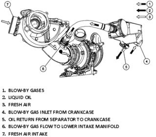

Not looking to start any pissing matches but have you guys seen this? I usually watch Bill's videos as they are very informative but this one seems to have caused quite the cluster fock if you read all the comments. Found them pretty entertaining actually. The argument seems to be that the higher rpm is causing excessive pressure on the turbo seals with the CCV mod installed. I have owned several FI sports cars, both blown and turbo including a twin turbo s550.. with all those cars running open system catch cans.. but then again none of those cars were making 30-40lbs of boost so I have no idea if what Bill says is correct or true. It makes sense in theory but I have yet to see or hear anyone else stress this concept. Is Ford's AOS really letting that much oil pass through? Has anyone installed a catch can between the intake and the CCV to check?

Well I won't get into it because I am not educated enough to back this up but: spoke to a ford engineer about this months ago and to do a Ccv ****** on a 6.7 is a bad idea in the long run(I have a Ccv mod kit still on the shelf new collecting dust).
I still scratch my head as to what to do. 6.7's have an excessive amount of blowboy compared to the other model enfines in the ford lineup. Also that Ccv collector/dog house oem box although looks simple is not and was spent countless hours designing it to attend to the 6.7 blowby. It is their for a reason. I honestly forgot the multiple amount of reasons it was designed like that- I don't listen well when talking to an "engineer"
Wanted to add - had a Ccv ****** on my 6.0 for years- had an engine oil leak even on a new build motor... put the Ccv back in place, leak completely stopped.. true story

The Ford CCV is an air oil separator where it allows the gasses to pass through and drops the oil back into the crank case. It's a sealed design unlike the Dodge 6.7 ccv where they replace the filter more often. On ours we are supposed to replace that whole box after 100-125k miles or so. I have no problem with the gasses passing through but I don't want the intake or CAC getting puddles of oil in them.
Although it would be pricey and take a bit of fab work I could prolly get a Radium AOS hooked up in place of the CCV. But it seems pretty promising if Ford's AOS is able to last 100k+ miles before needing to be replaced. Just not sure how much oil is actually getting past it.. guess I could pull my intake tube and look.

Removed mine at around 75k because I had oil getting past the the box. I had oil in my CAC and all. Truck was bellowing white smoke when I'd let out the throttle. Did a No Limit CCV delet e and it solved the problem

I removed my CCV box at 12k and the turbo piping and CAC had a good amount of oil in it. I think the way to go is Venturi in the exhaust through a catch can. I use a small racor unit. When you get on it and there is any blow by the Venturi should keep the crank case pressure at a reasonable level and keep the oil leaks to a minimum .

Been running mid sized racor unit,no venturi for over 75,xxx miles.No leaks here.The venturi is over kill....

So you guys using the Racor units.. are you draining the oil back to the oil pan as well as running the outlet side back to intake? Or do you have a canister hooked up to catch the oil and the outlet vented to atmo?

My racor is in line to the Venturi. I drain it when I change the oil. I don't drive much so that's every 2000 -3000 miles for me.

Just an opinion here...but leave the factory box on, remove the line from it to the intake, cap the hole in the intake, buy a vinyl 1" hose and slip it on where the hose came off the box and you're done.
Lets the factory box do its separation job, 1" line is plenty big enough to vent pressure, and it all cost you about 8 bucks and 30 mins (if you're working slow...)

What I'm doing currently, then into exhaust venturi
