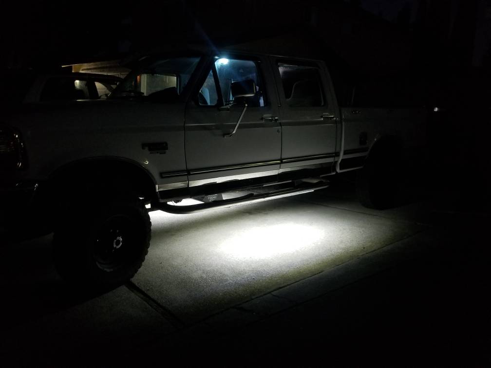

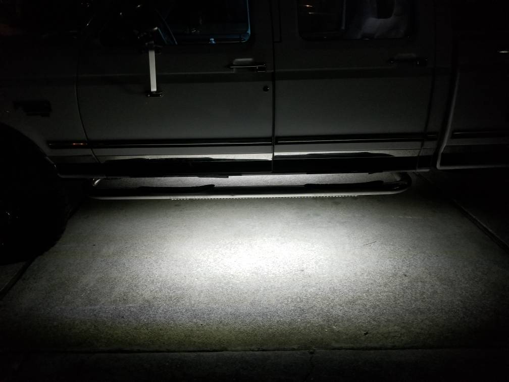

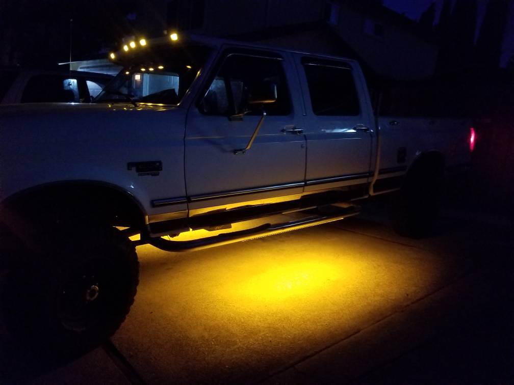

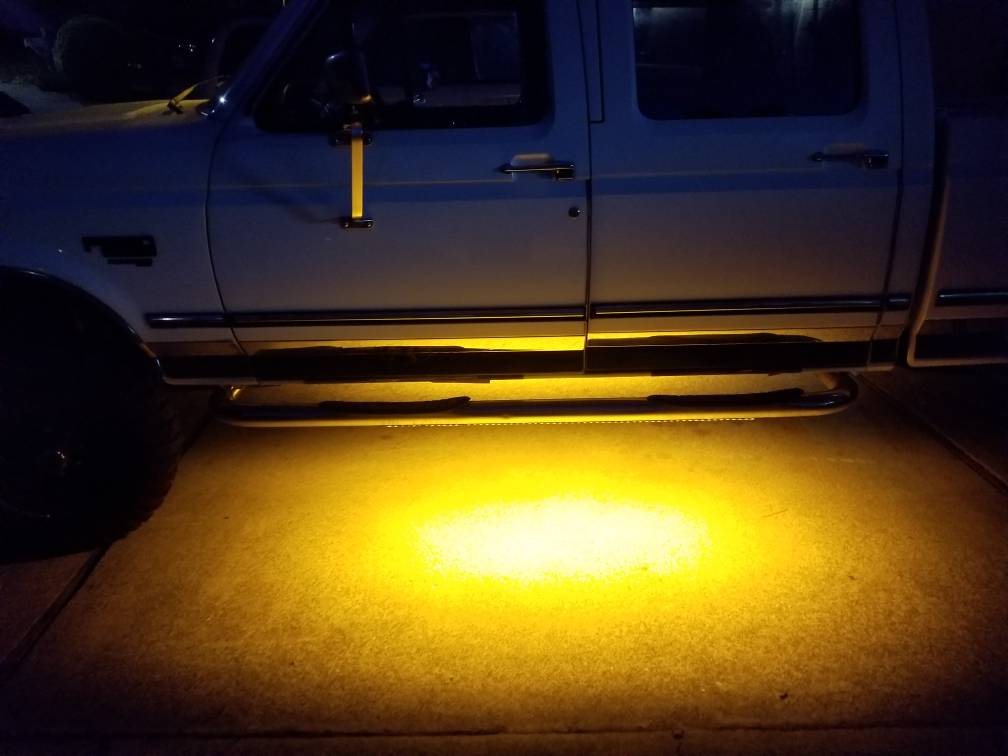

Are those mounted under your steps, shining straight down? How bright is the white function?
Yeah it's just 3m adhesive tape and they are facing straight down. I'd say the white light is equally as bright, if you look at the Amazon ad, there are 60 LEDs of white and 60 LEDs of orange, also says they are the same kind of LED. So makes sense they would be pretty much the exact same brightness.
I can take a picture when it gets dark.
If you are not wiring them up as blinkers your wiring will be super easy. Just need to figure out which wire going to your normal running lights is only hot when they are on, hook that up to the yellow wire.
Then, find a wire that is only hot when the courtesy/cab lights are on and hook that to the red wire. ( I used the wire coming out of the door open sensor)
Then just hook up the ground!
Note as the ad says, the orange light always has priority, meaning if your running lights are on, and the LEDs are orange, opening the door will NOT turn on the white LEDs, the white LEDs will only turn on when your running lights are off, and you open a door/turn on the courtesy lights

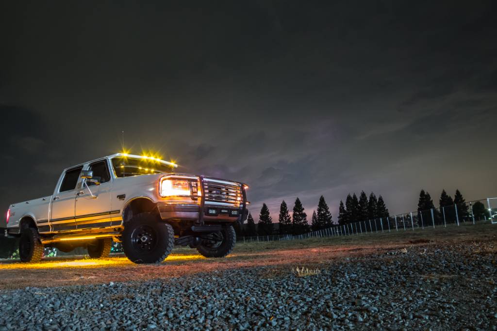

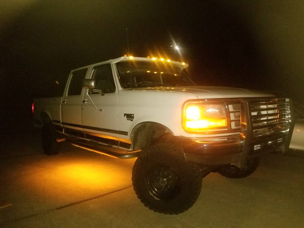

Here are some photos. The orange and white are pretty much the same brightness
