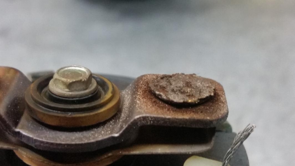

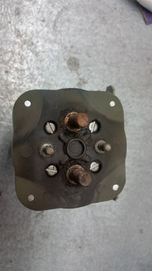

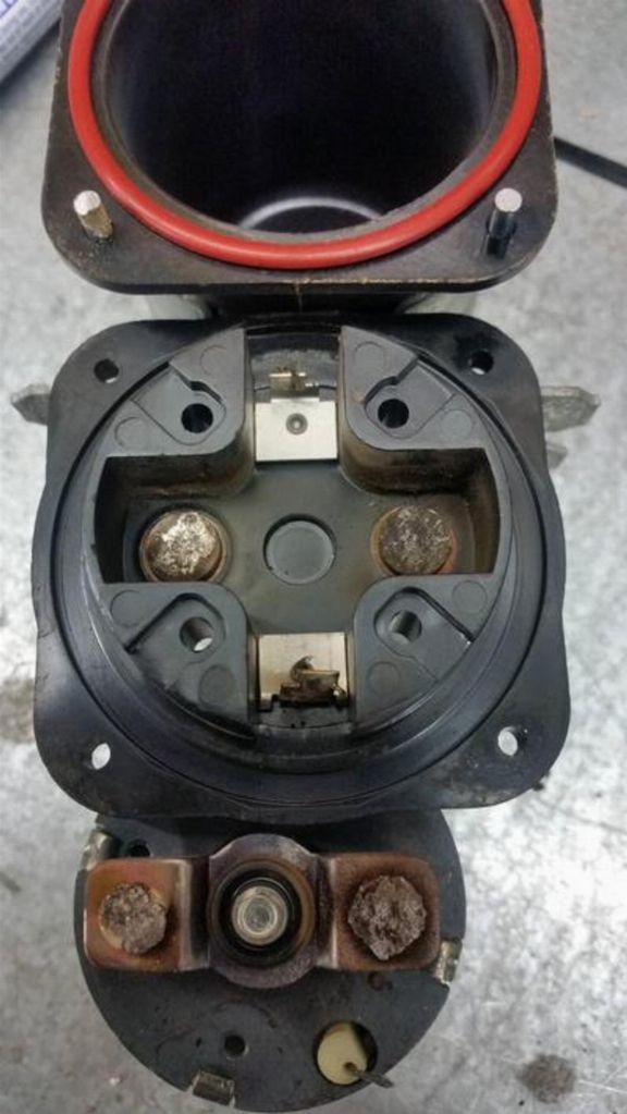

Fast forward to these two past weeks, the GPs would not energize. I had to jump the big terminals with a hammer to start the motor. So I bring my truck into my shop and began diagnosing the issue. I put a bulb across the control circuit of the relay. The bulb lit everytime I turned the key on. I let the PCM time out and the bulb turned off. I have a bypass switch in the cab for the GPs and activated the GPR manually after it timed out. I heard the coil activate with every press of the bypass switch but no GP activation. With the coil activated, I had power only on one side of the big terminal studs.....bad relay.
So I install another so called HD 200A continuous duty relay. And the GPs once again start energizing. So I took apart the White Rodgers relay and this what a 200A continuous duty looks like after 60k miles:
So is the 586 relay any better than the OEM one? Others have tried the GPR-109 (NAPA), the Western Plow one, generic auto parts store ones, etc, etc but to what success or failure?
