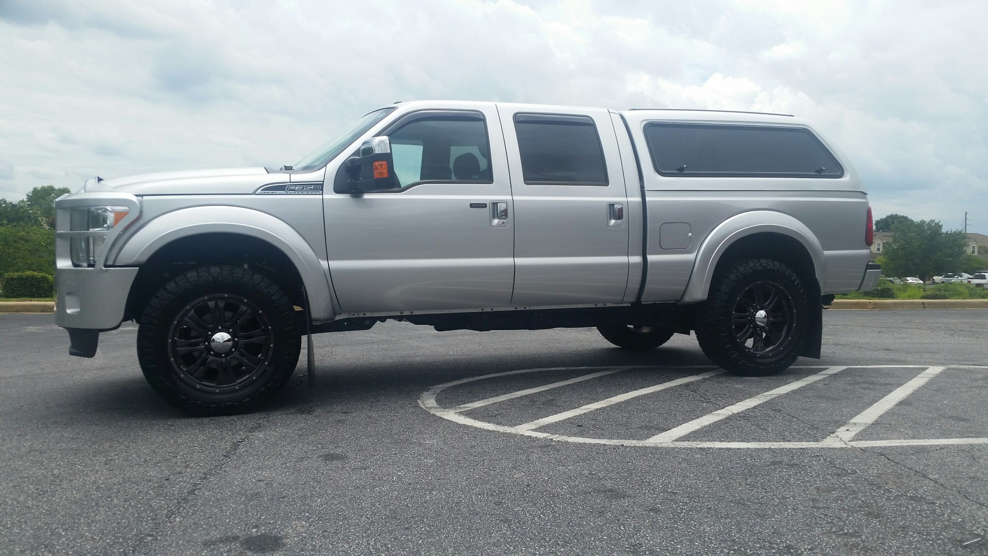

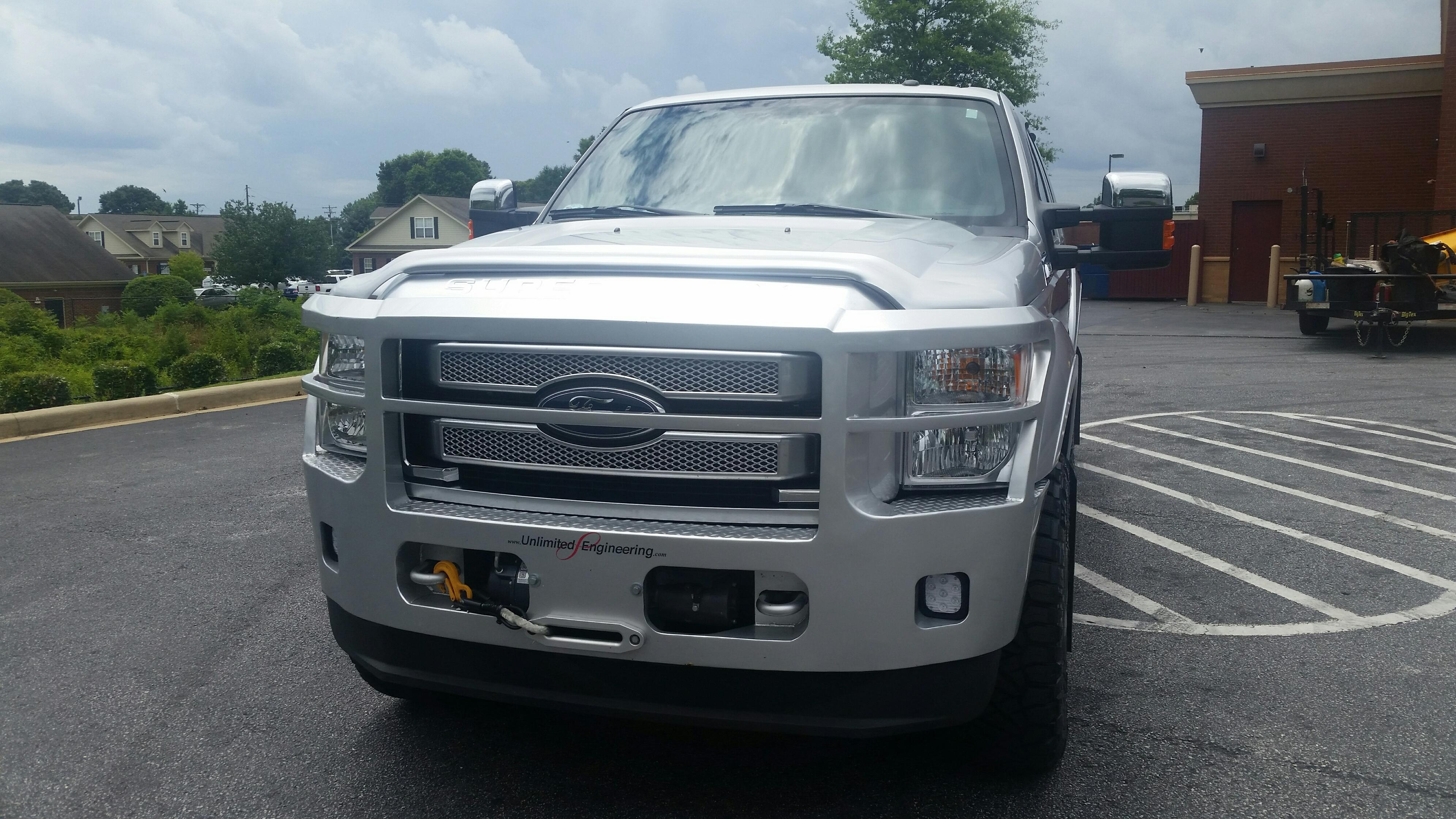

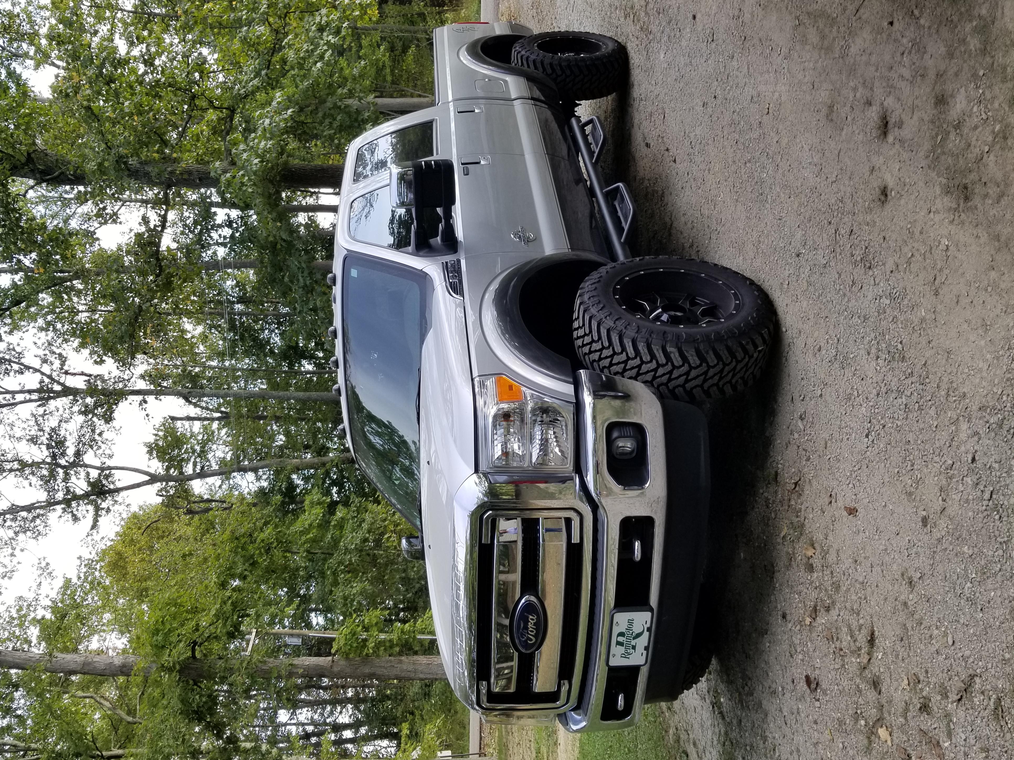

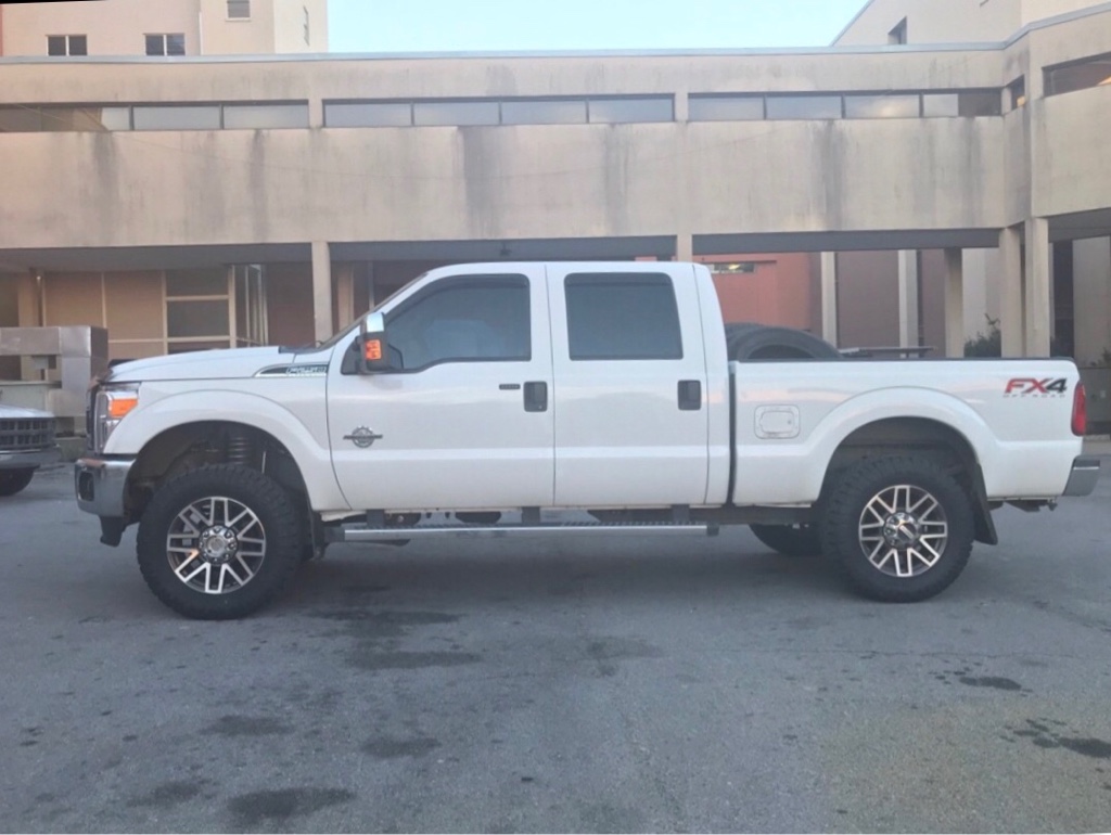

I'm running those on a two inch taller front spring with 20x10 pro-comp rims with -12 offset and half inch wheel spacers. It rubs a bit even without my front mudflaps on. I should really be another two inches taller.
