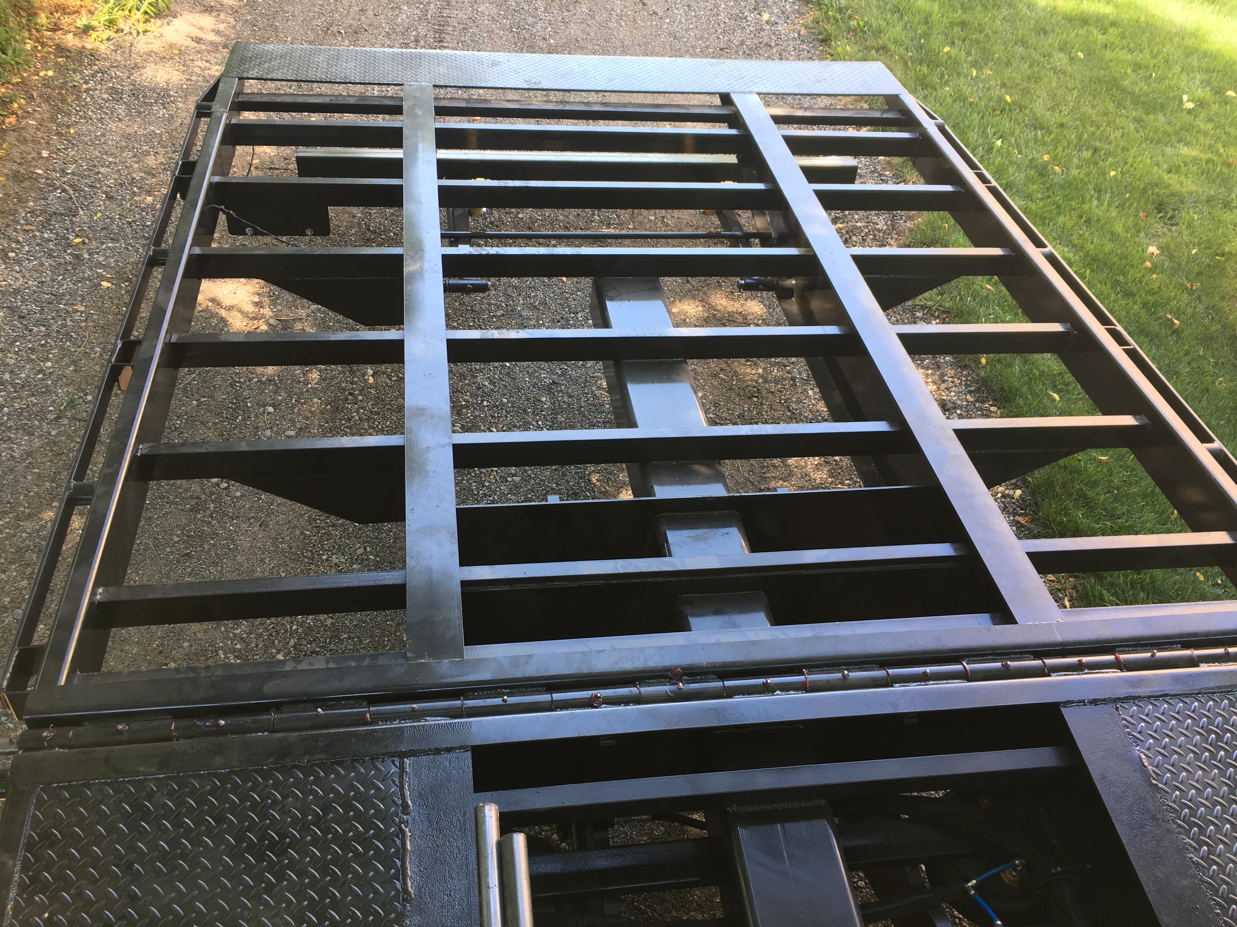

Just got done building one for mine and it's a huge improvement on flip over ramps.

grease fittings on the top seems vulnerable.
Works great, They are 1/2” under deck height and there is only a 1-3/8” span across the tail and main deck. Never had any issue and I didn’t want to climb under it to grease it or have raod grime hitting them. Plus if I did them on the bottom there would be three that would not be reachable with the hydraulic tail ram lock mechanism in place.
