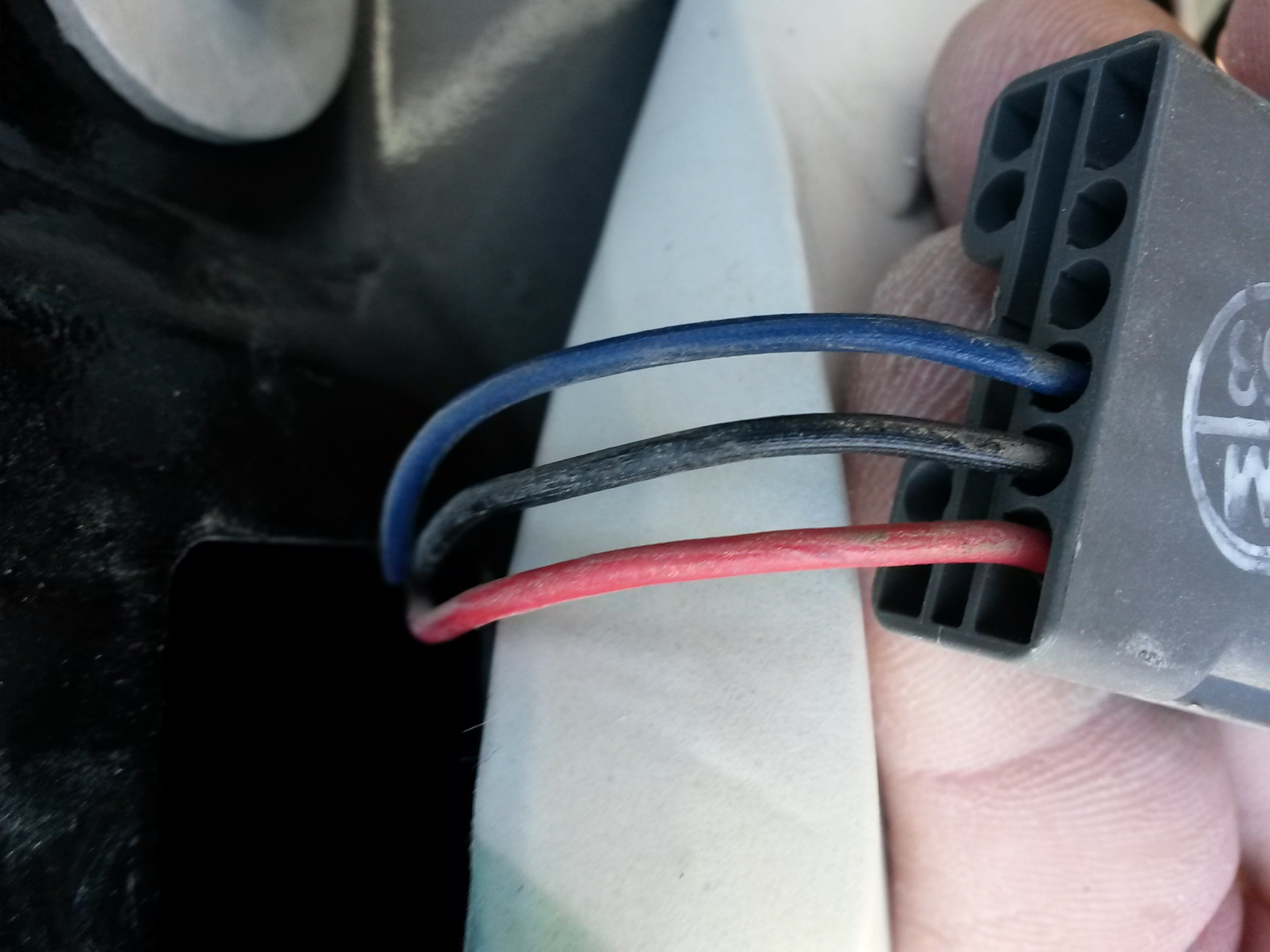

I just took the door panel off and if I'm seeing this right.. the factory mirror plug has all the lights wired already for turn and signal lights.. can someone confirm if I'm seeing this right? First pic is factory body plug second is the actual mirror plug

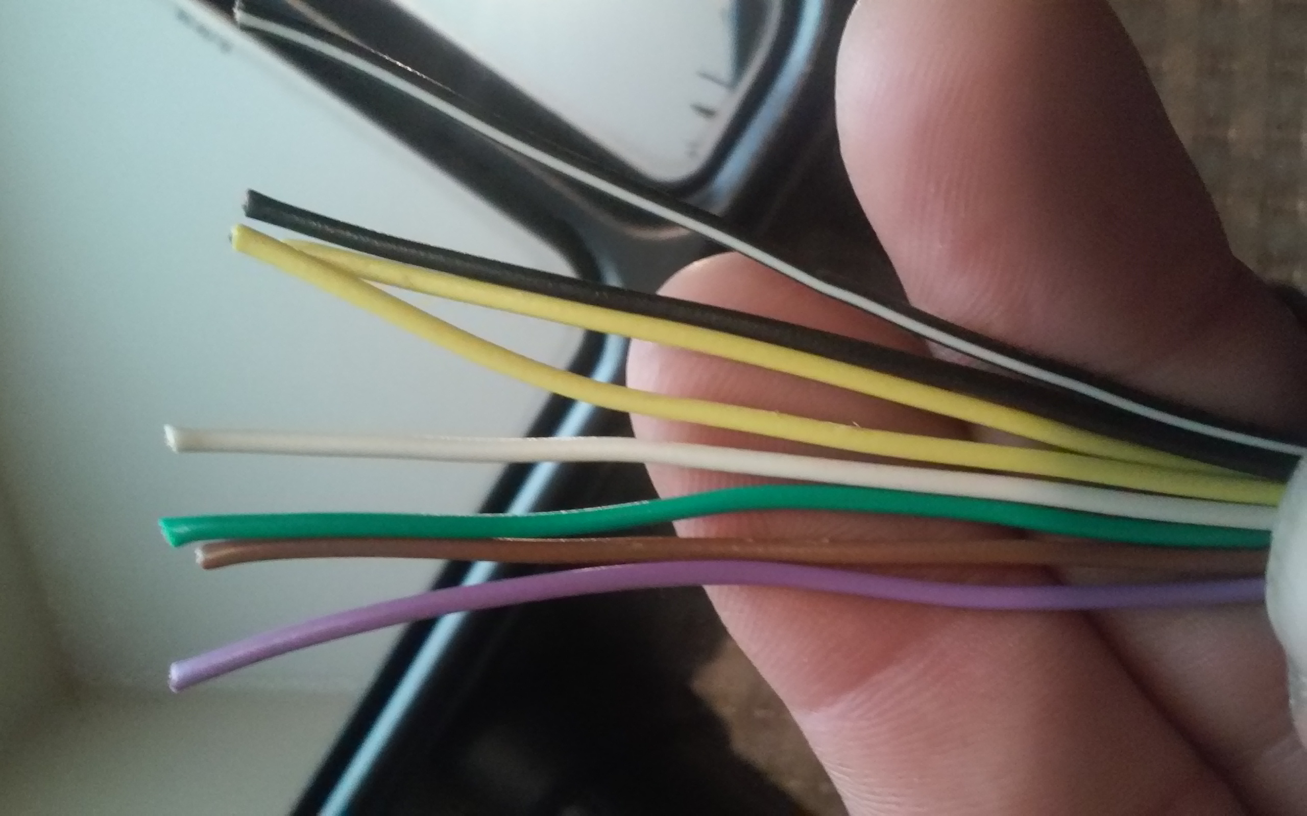

So I finally get time to put my tow mirrors on.. And notice there is 8 wires on the mirror and only 7 wires on my truck..extra yell wire..anyone have any idea?

Anyone know where I can get raw mirror side pigtale or plug? That would probably explain how to solder these wires together..

What I found adding lighted mirrors to my Ex was that the running light isn't wired if the truck didn't have factory lighted/ signal mirrors. You can wire them yourself or tie the extra wire into the signals so it lights then as well. Everything else works. Makes no sense why Ford would leave one wire out of the harness but that's my experience.

Makes sense.. My truck has power mirrors.. Just not heated or marker lights

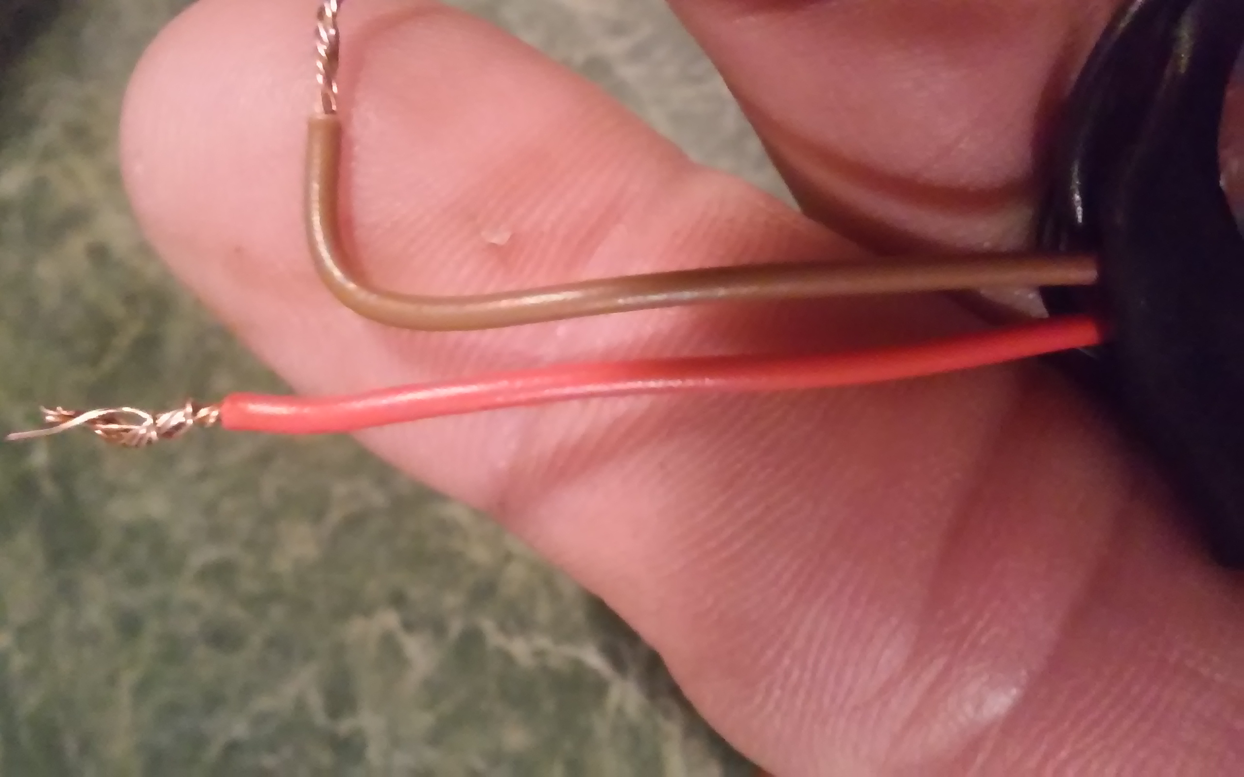

Ok.. I'm color blind and need help.. What color are these two wires? I pulled door panel off and everything matches up.. But I need a brown wire for the marker lights.. The two yellow wires get crimped together if I read the wiring diagram correctly. ..
Now the factory plug.. Is there a brown wire in there..maybe that single one?

In the photo, the curved one is brown, the shorter straight one is red. The second photo is not clear enough to accurately make out the colors.

The brown wire on truck side should be park. Iirc, wire the yellows together. Colors changed slightly left to right also I think.
👌 thanks. In the very first post.. that is my factory truck plug.. the bottom wire to the right.. is that the brown wire if you can tell?

In your first post, first photo, the wire to the right with the slight bend appears to be more brown than any other wire in the bundle. Left to right - green/purple, black, green/white, blue, yellow, red, brown.
