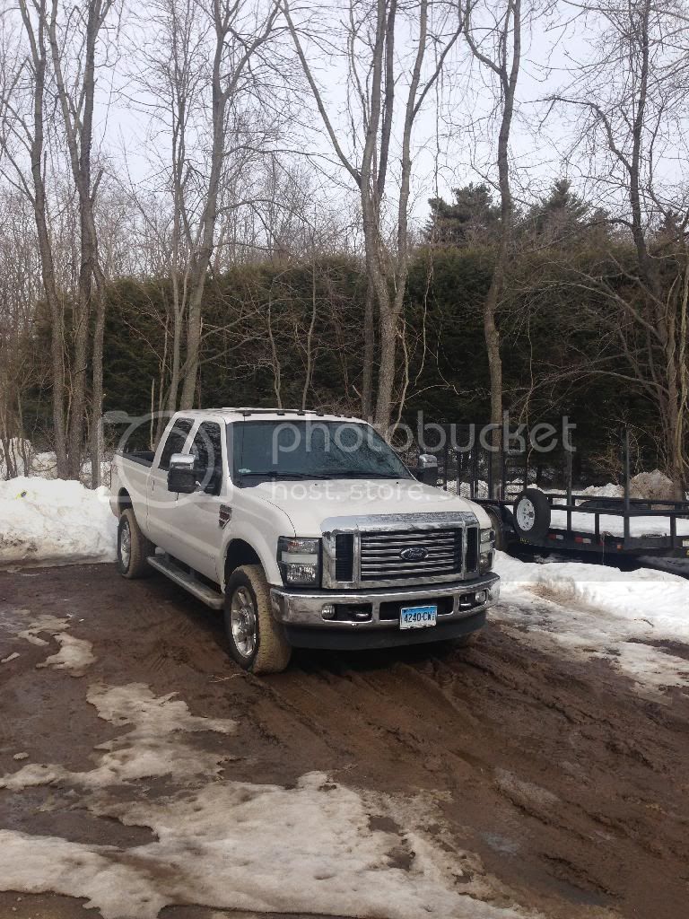

here it is now, not much different, but front windows are tinted to match or close anyways.
recon smoked cab lights, I did the led mirror lights but not in this picture.
the head lights get baked in the oven and smoked, the grille will be getting changed, tail lights will be smoked, fender badges painted, and bumpers will be ptm. It should look pretty sick sitting 6" higher with the leveling kit and 37's on it. might do a 1 piece drive shaft as well.
