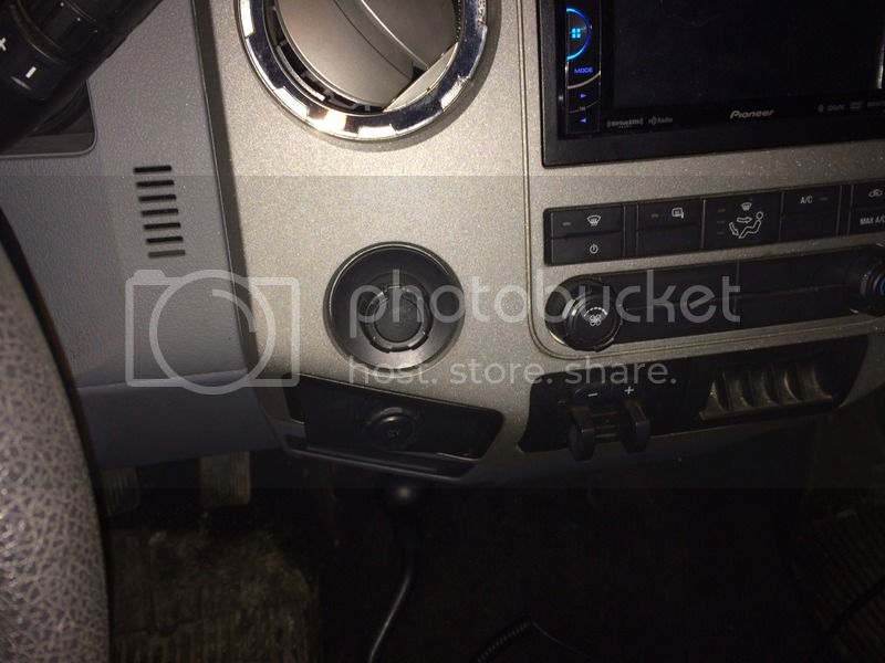

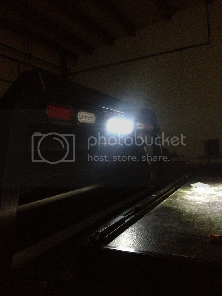

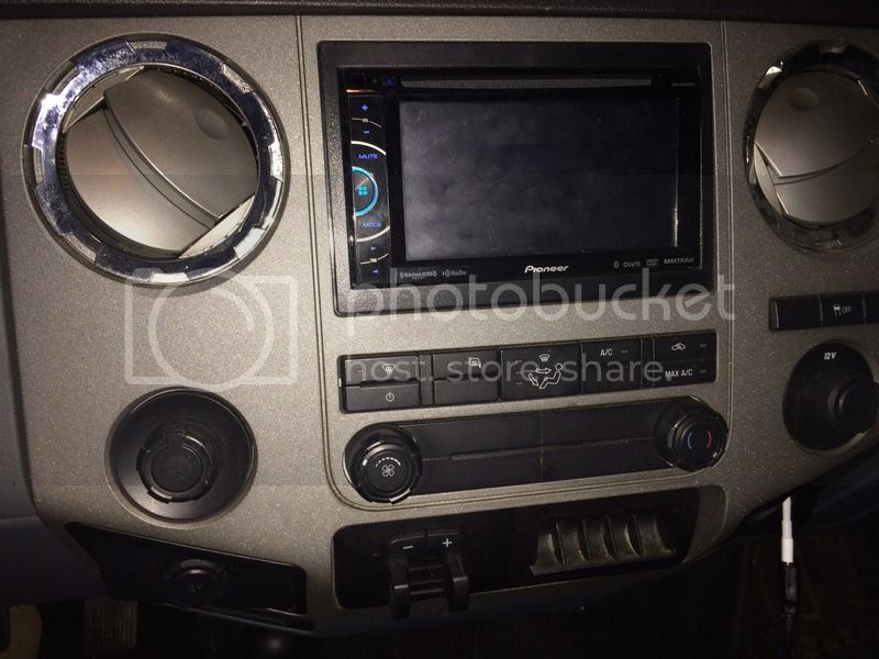

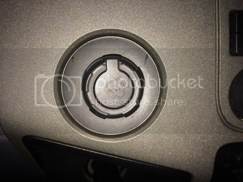

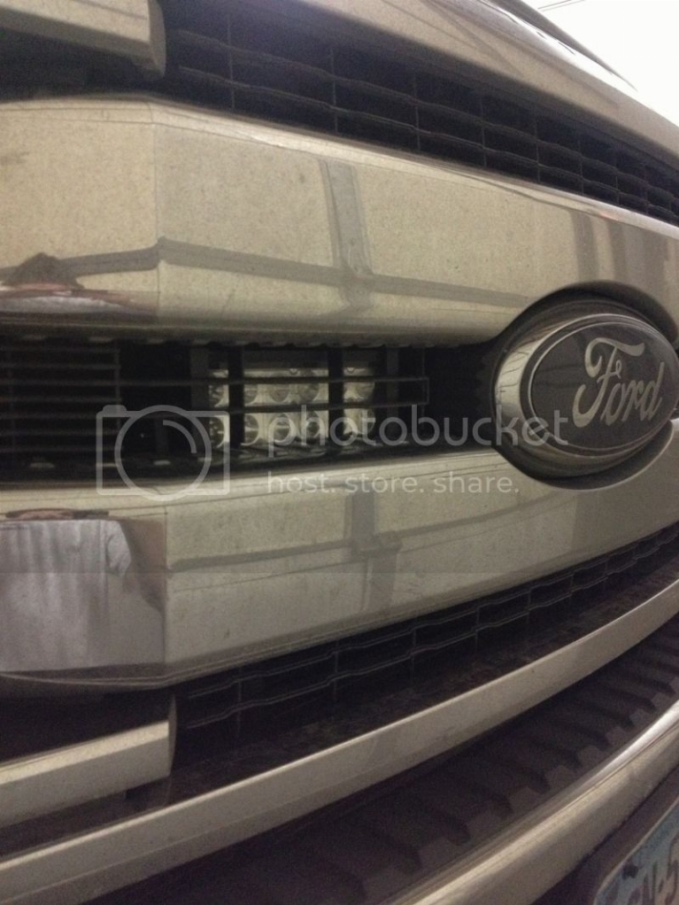

We were asked to add some lights to his BackRack and behind his grill and instead of having a myriad of toggle switches we wanted to find a nice OEM looking way to control them. Our solution was to replace the change tray to the left of the radio stack with an electronic 4wd selector switch and reconfigure it to run the lights.
The 2wd position is "off", "4High" is the Front lights, "4Low" the back lights, and if you pull the switch it kicks on all the lights simultaneously.
Here are some pics, hope you guys like!
