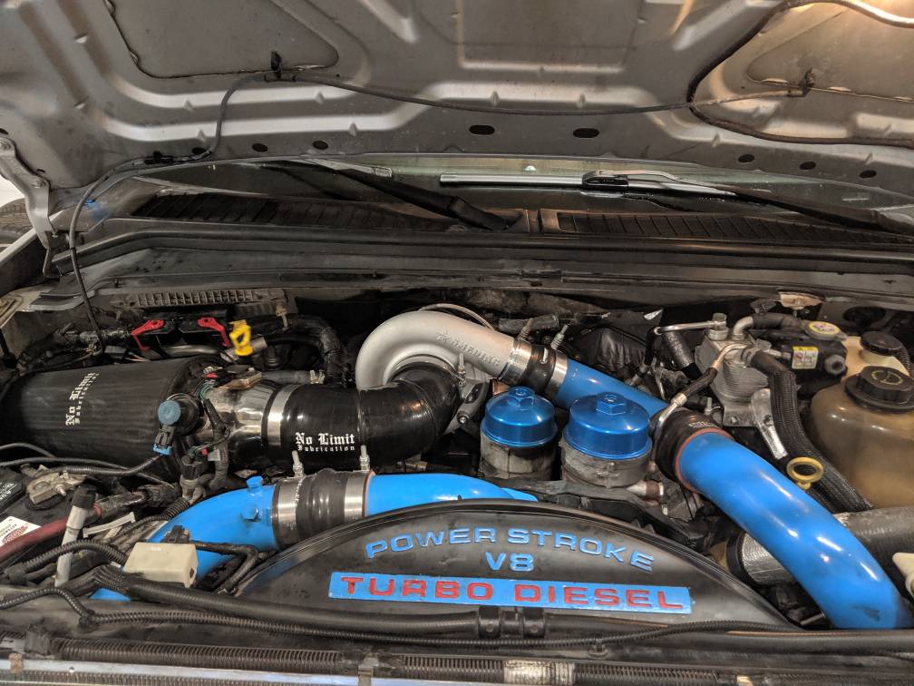

Got the 364/68 in tonight. Noticable improvement for sure over the 369/73 I'm happy

No I haven't , Byall sent me a revision and it's pretty damn nice driving. I'm getting a lot of boost with this 364 , spiking my 46psi boost cut. I think I'll raise it to 50 psi and run it.

I haven't towed heavy yet , not that I tow that heavy just a drag car. World's better than the 369/73 , i don't think it's possible to find a better tow set up than the OEM twins. If I was towing 10k+ regularly idk if I'd go single. The single non vgt's seem to take much more throttle to spool over stock twins.
