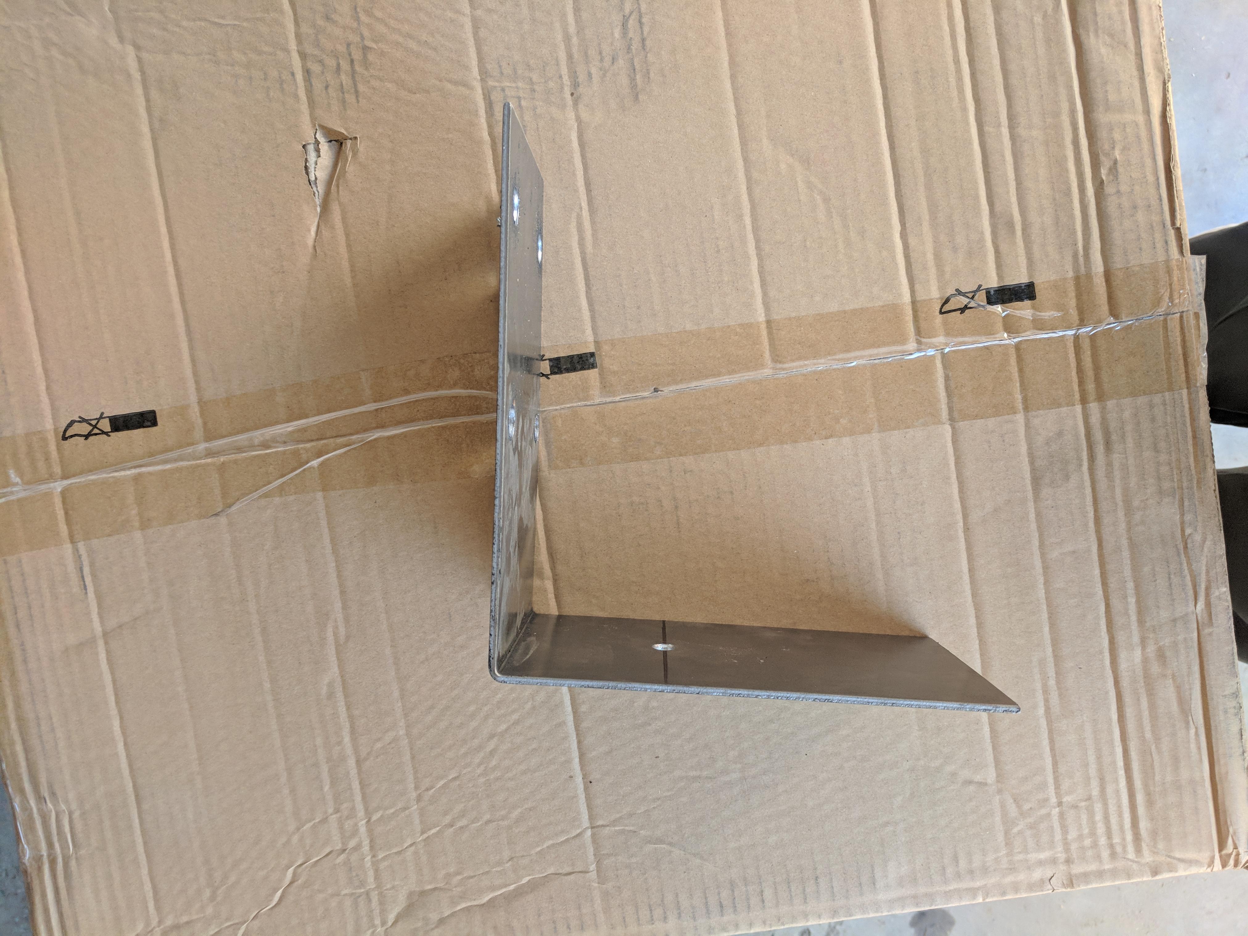

I added an auxiliary fuel filter and water separator in front of my factory water separator on my 2014 6.7. I used factory style quick connects I found online so this is easy to remove if needed for some reason. I went through many ideas and designs before I was happy with the location. I wanted it tucked up inside the frame rail so it is protected. I have included a parts list with part numbers, where I got them, and what it cost me.

-Custom L Bracket made from 1/8 inch cold rolled steel, Dimensions are
7x7.5x4 inches $40-Local Machine Shop

So first I found where I wanted to mount the bracket. There is a stud with a nut on it that is just behind the factory water separator that makes a perfect mounting point. I really liked how it was close to the factory setup and protected up inside the frame rail. You do have to trim a plastic stud back to the frame rail so the bracket will sit flush. The 7.5 side of the L bracket goes over the top of the frame rail towards the interior of the truck.

After getting everything marked and drilled I installed the filter base to the bracket using 3/8x1 bolts with lock washers from Ace Hardware. I then Installed the fuel line from NAPA. This is high-pressure hose. Don't cheap out here and get the stuff that costs half as much. This line can be up around 100 psi and will blow that cheaper line apart. Also if you get high-pressure stuff from somewhere else make sure it is rated for both diesel and biodiesel. Many places I talked to would tell me their hose was diesel rated but had no idea about bio-diesel. This is not the place to save a couple of bucks to trash a $10k system in my opinion. The part number I gave from NAPA is rated Diesel, Biodiesel and up to 225 psi. I used the 2 high-pressure clamps on the raceflux fittings. The other fitting were pushlock and did not need them.

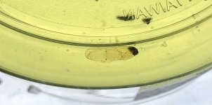

Did my first aux filter drain today.
It is doing it's job. Had a small drop of water from the Donaldson. None from the DFCM.
