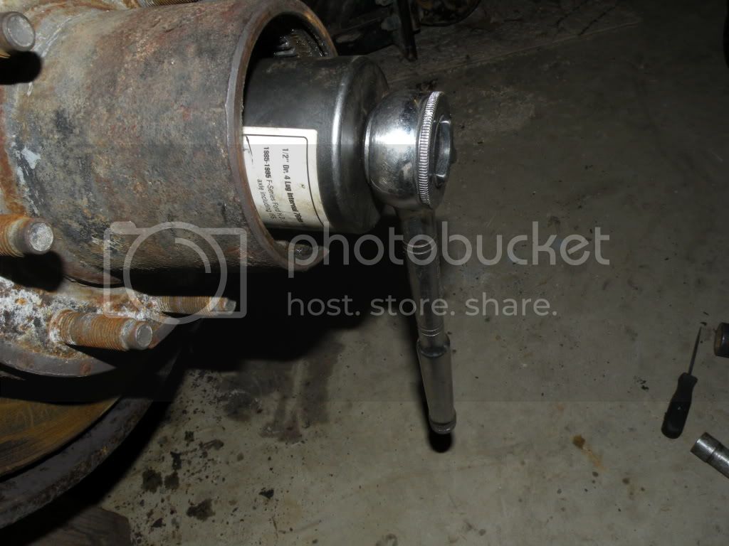

Ok I have a ? What's the size of the socket for the hubs plus will the same socket work for a f150 with the twin I beam 4x4 ?????? Gota change my bearings and a budy of mine wants me to do his too so let me know thanks

You may wanna get a couple different sizes because my hubs were different than the tool said or vice versa. The tool listed to use on my 97 F250 front hubs was too small to get the nut off. more importantly it was too small to tighten them up. I bought the socket from my Mac Tools rep and had to call him at home to get the correct socket.

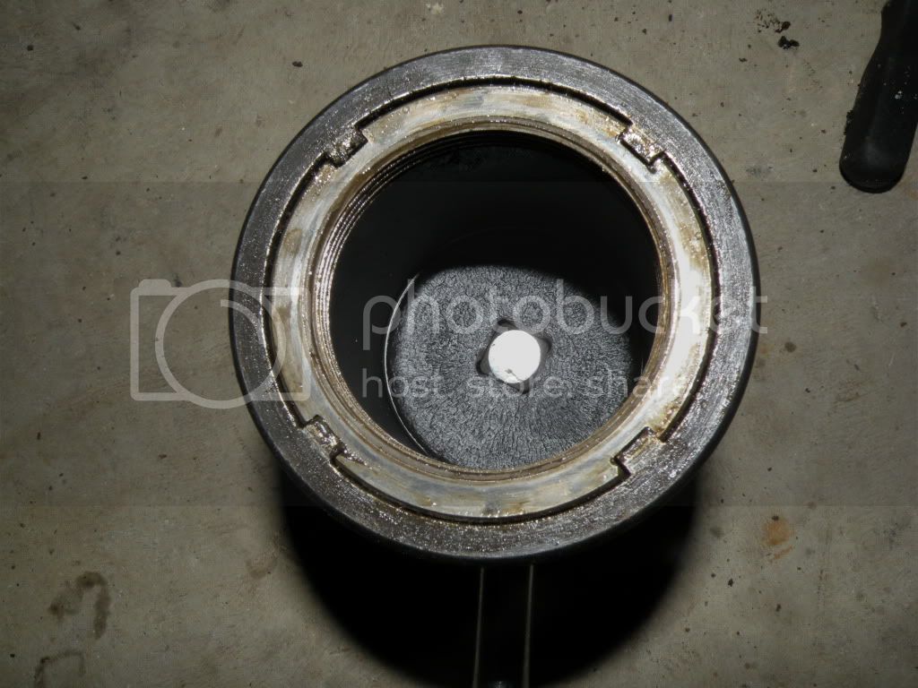

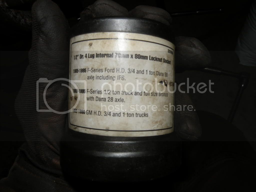

Use this one for the manual hubs-
94.5stroker
Jul 17, 2011
143
Phillipsburg Kansas
Mine is a dana 50 and I had the 4 prong one as shown above for my dana 44 F-150 and it wouldn't take the nut off my F-250..... Had to get the one Otahyoni linked to....... Kinda a weird deal it didn't fit right but it worked..... the four prong one I already had wouldn't work at all
Brads93 idi
May 24, 2011
183
Big spring tx
Yeah I had a hard time trying to figure it out but it was the 76mm with the four prong and the f150 was a pain in the rear to do but thanks for all the advice
