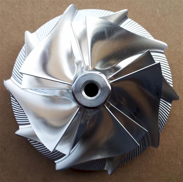

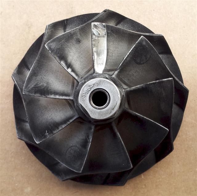

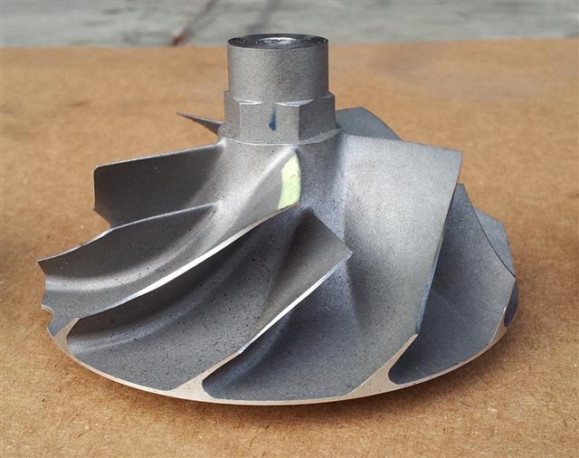

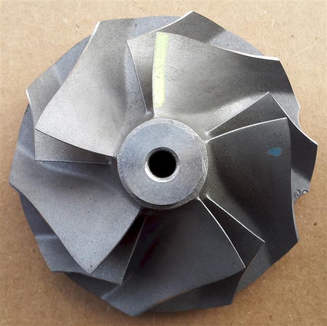

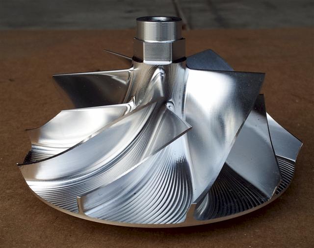

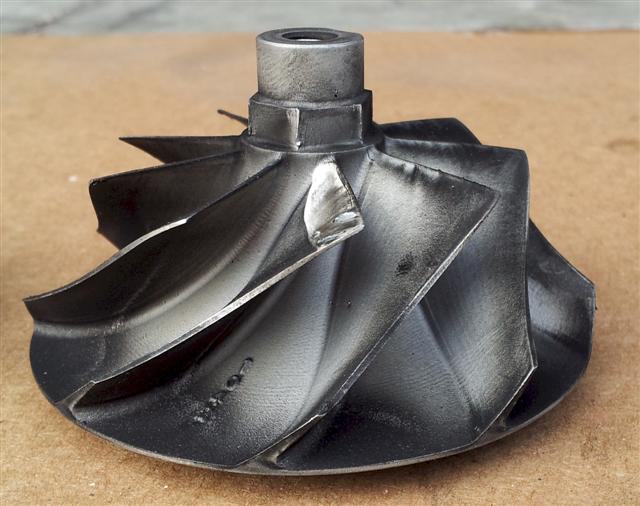

The new wheel is a pretty drastic departure from both the stock compressor wheel and the original Wicked Wheel. These images show just how radical the new design is...
Stock (Click on images to enlarge)...
Gen 1 Wicked Wheel (Click on images to enlarge)...
Gen 2 Wicked Wheel (Click on images to enlarge)...
The pictures clearly show the effectiveness of the new design, but what I didn't expect were the results we achieved when we put this little puppy on my truck today.
