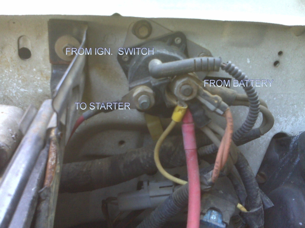

Here is a picture of mine

Mine looks a little different. But basically the small red wire from the starter on one pole, the rest of the connections on the other?

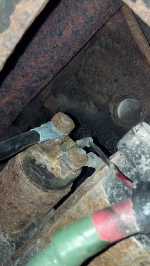

Ill get some pics up tonight guys.
When I get under the truck there is a large red wire on the starter, there is a small red wire on the starter, there is a large black wire also.
All three of these wires were somehow hooked to the solenoid...maybe someone had it rigged up, I dont know?

The one that just plugs on comes from the key switch. The other smaller red one goes to the starter solenoid on the starter. Just where is that large black wire connected to the starter at?

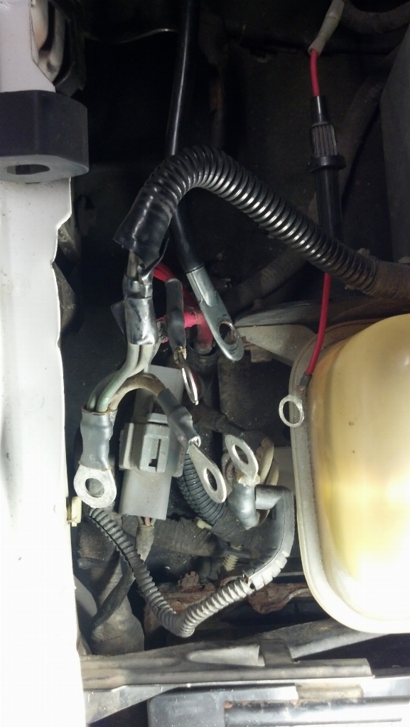

WhiteStroke13
Jun 27, 2013
40
Chillicothe, OH
theres my setup..at the top is the large black wire from starter.
to the left a larger red wire with a small red wire running with it
1 set of green wires
2 sets of white wires
the plug
and a random very small red wire that runs into the cab
please help!

Someone has change the wiring on it for you. They are using the large black wire to run the starter, perhaps they lost the eye or there is a bad cable from the battery to the starter (large red wire at the starter). Is the large wire that comes directly off of the battery still connected? It is hard to tell in the pictures
To me it looks like you connect all the large wires together. The large black one, two green and the two sets of white wires on one large lug. The small red from the starter to the other large lug on the solenoid, then the other small that runs into the cab to the other small lug.
