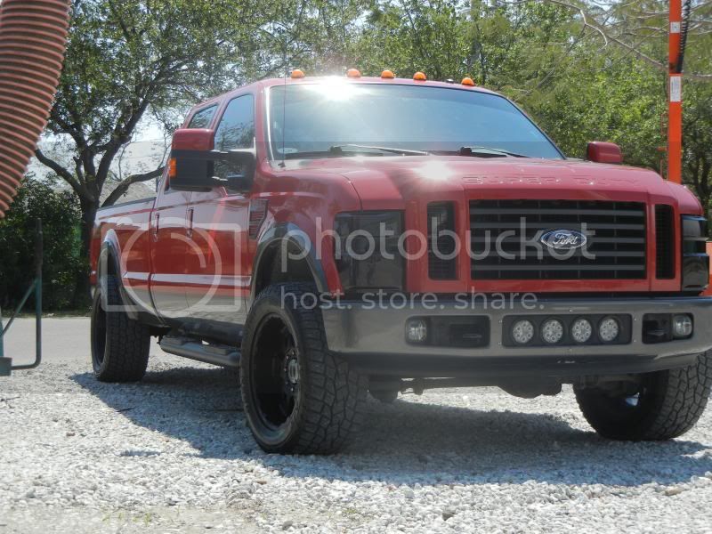

I would go 10" wide with that tire. Here is a pic of my truck with a 20x10 -12mm and 305/55R20's. Stock height in the front -3" in the rear.

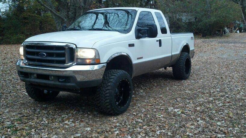

I don't think it will fit with out some major trimming. Here is the same truck with a 18x10 -25 and 325/60R18's. I am lowered about 1.5" but you would be adding an extra inch to each side of the wheel plus the extra offset.

I've run the 20x10. Not interested. I really like the look of the 12 wide. Thanks guys. And yes I was sure there was already a thread somewhere but didn't want to search for days for it

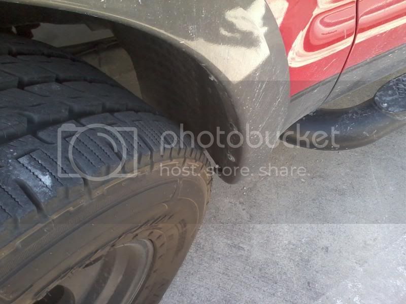

I have 20x12 -44 on my 04 with 33/12.50 Toyo MTS. I'm running a 2.5" leveling kit and it rubs in a hard turn.
