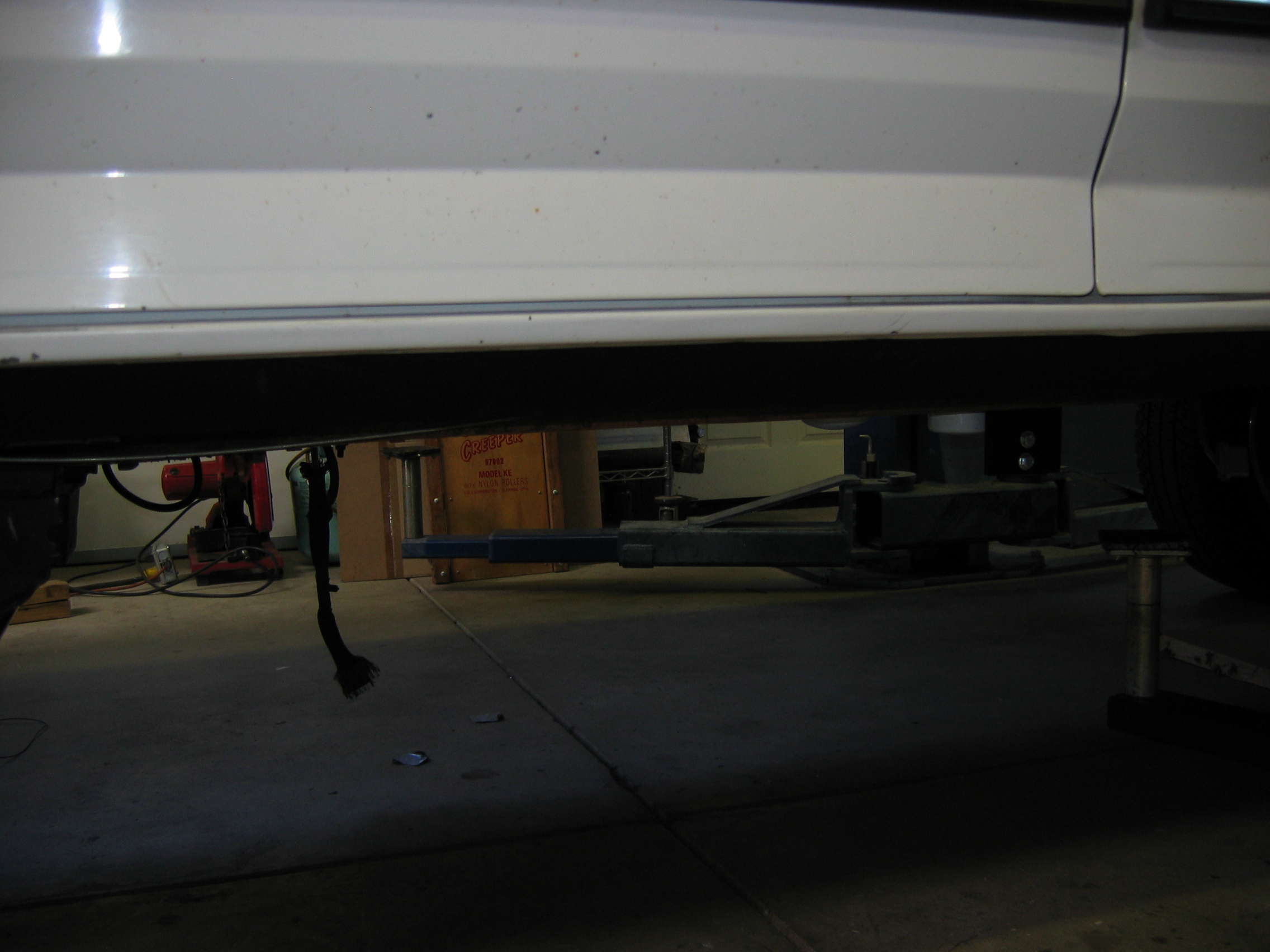

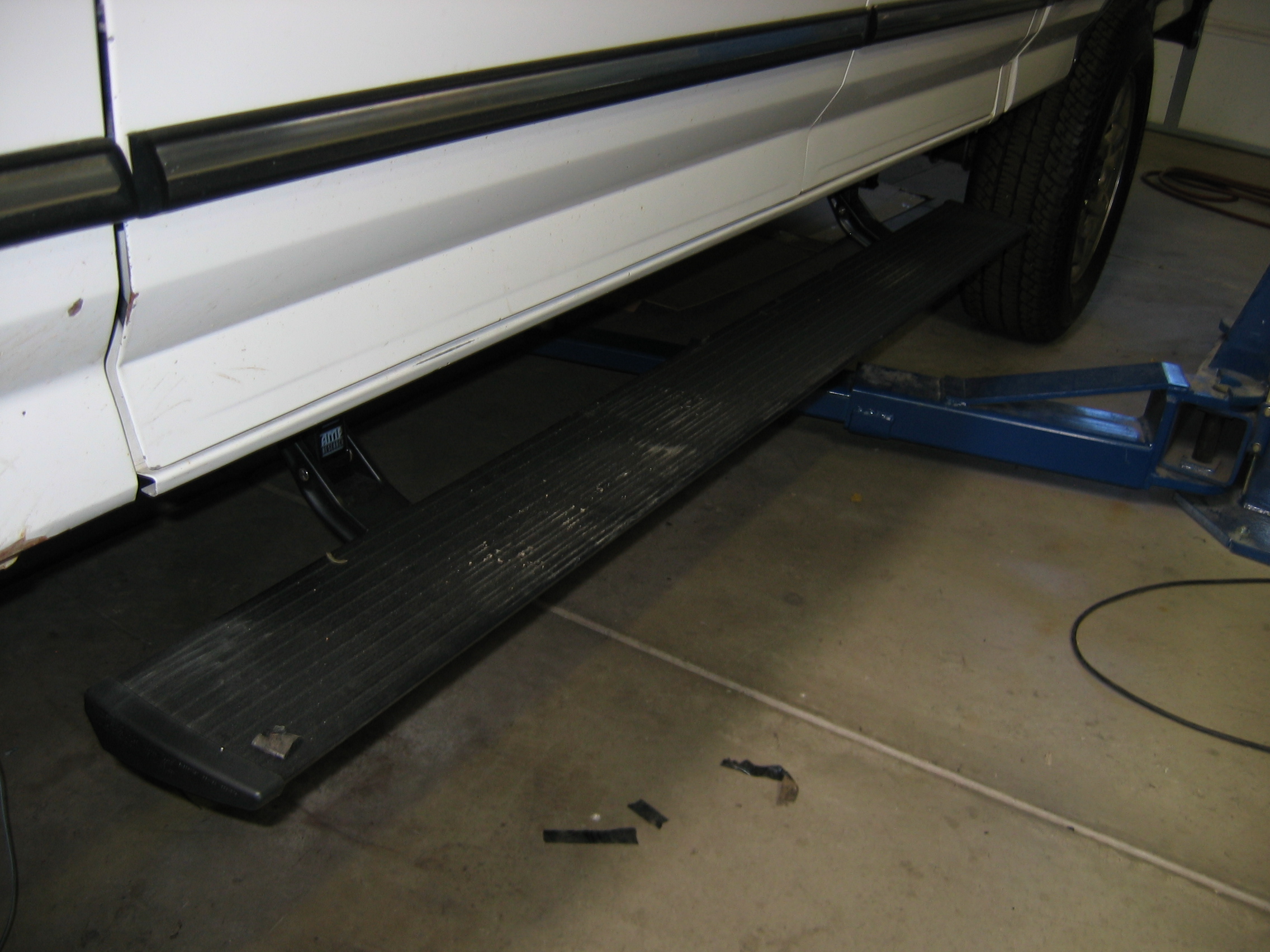

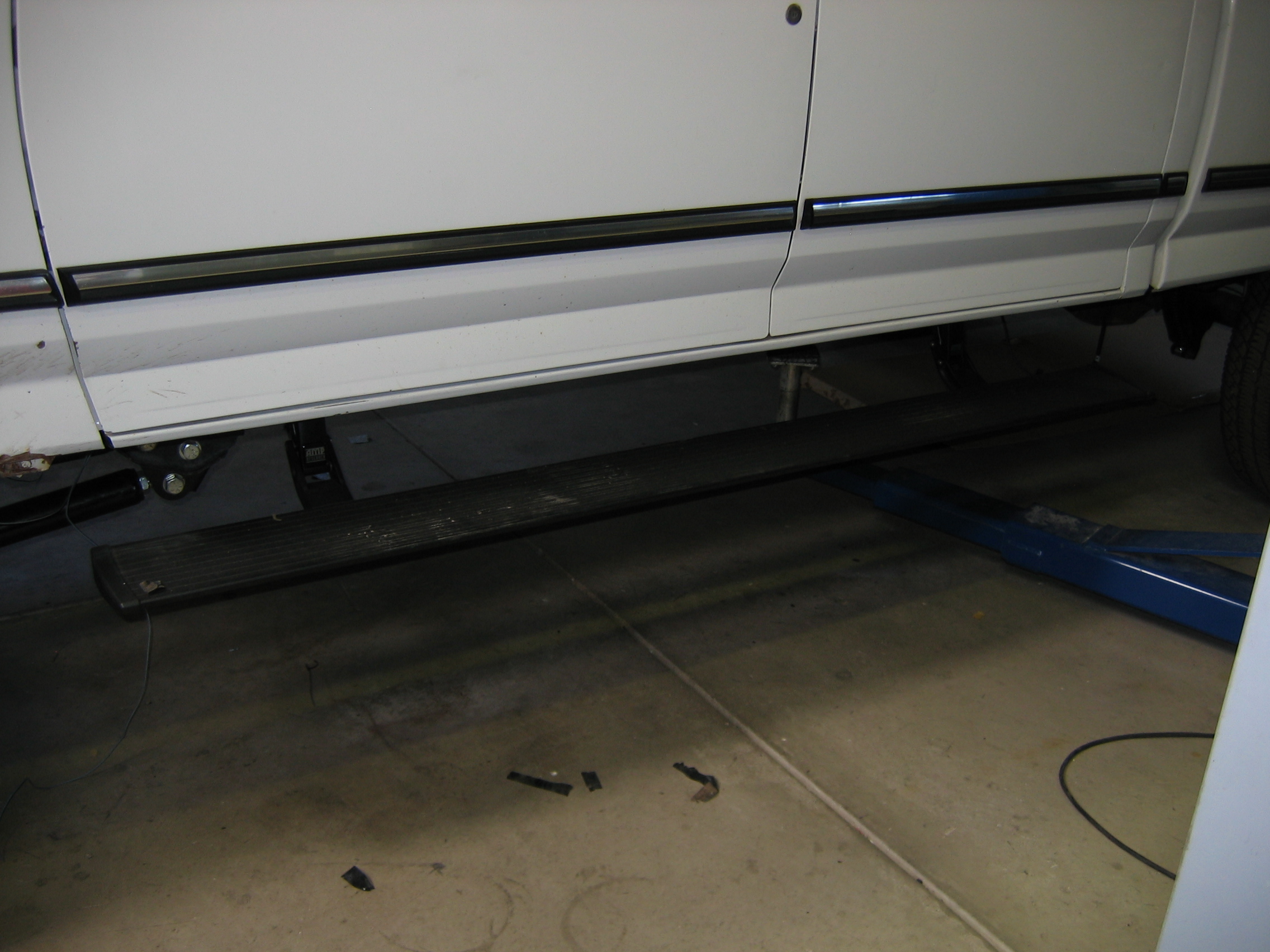

Yes I have finished a install on a crew cab '07 with Amp steps..we sell the steps and can provide parts needed or provide instructions..PM me if interested.
OBSWIZ
846
Wellington NV
:doh: I hit the 0 not the 9..trucks a '97..sorry the pictures are not better..
