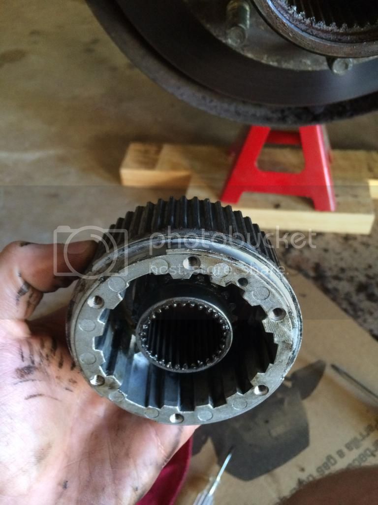

4) Remover the hub cover with the appropriate sized allen wrench or torx socket. This is what you will see.
5) Remove the spiral lock ring by prying it up out of its groove then pulling it out with a small pair of pliers.
6) Remove the hub body assembly and set aside in a clean area.

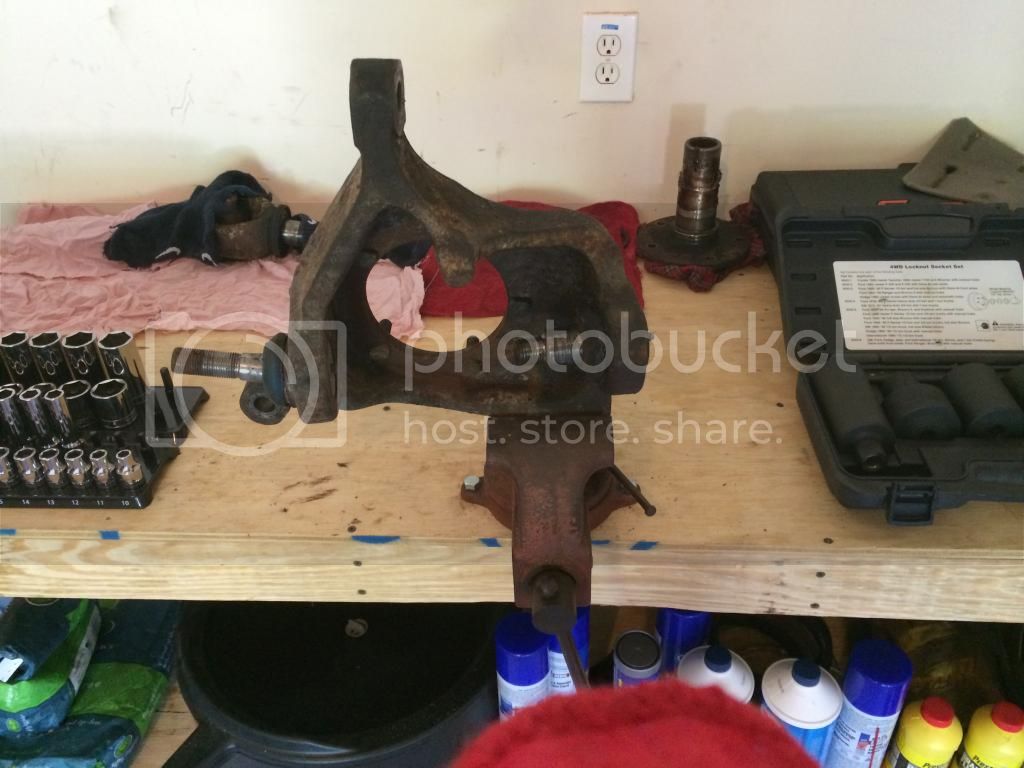

12) Remove the upper ball joint nut. Loosen the lower nut and pound down on the steering knuckle. Once it is loose remove the lower nut and place the steering knuckle in a vise as shown.
13) Remove the snap ring on the lower ball joint.
14) Now it's time to remove the ball joints. In order to remove the upper, the lower must be removed first. This holds true for installation as well, the upper must be installed, then the lower. Here is how to rig up your press to remove the lower.
