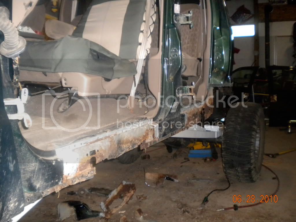

This is kinda what rust looks like?? right??

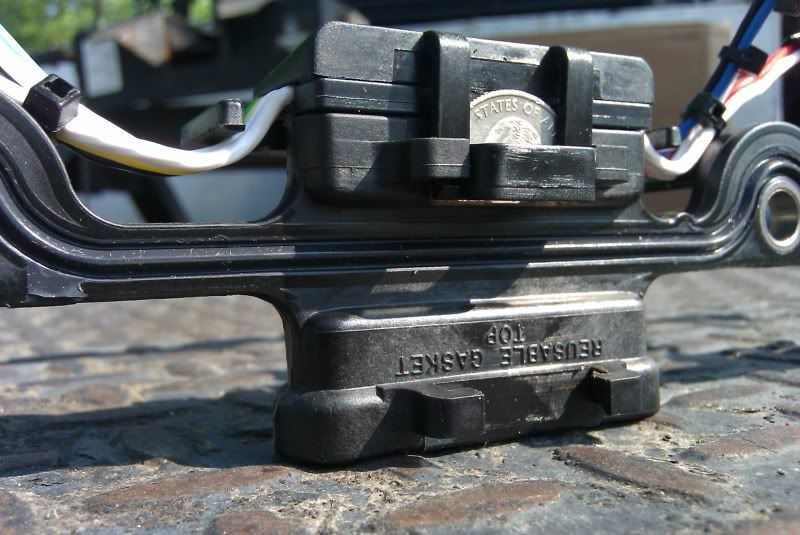

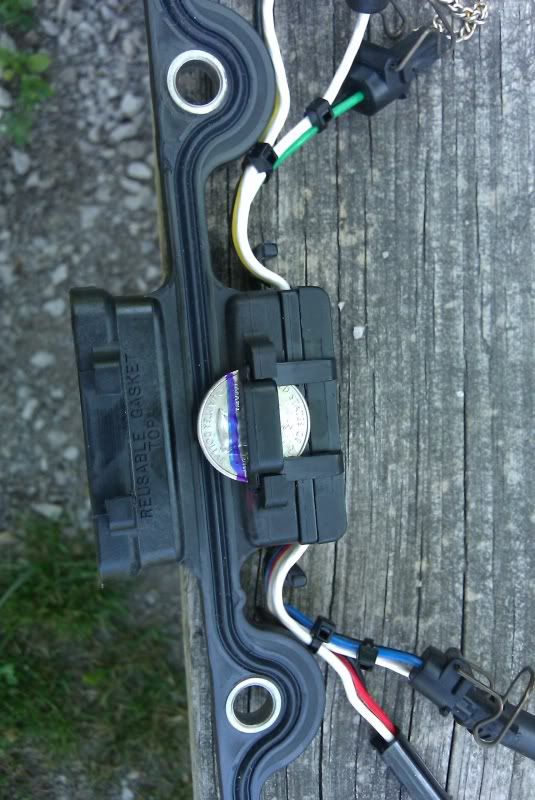

I'm not sure I would invest in VC gaskets or UVCH's. I would do the $0.50 mod to make sure UVCH's don't come unplugged. The probability of these failing is low and they aren't really that hard to change in truck.

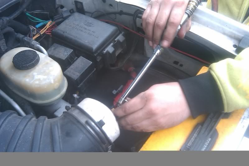

Build a boost leak detector and make sure ya don't have any boost leaks when ya put it back together:

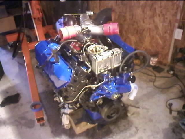

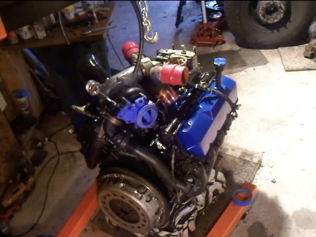

I was out of time and this was all I could get done on the F350's engine:
