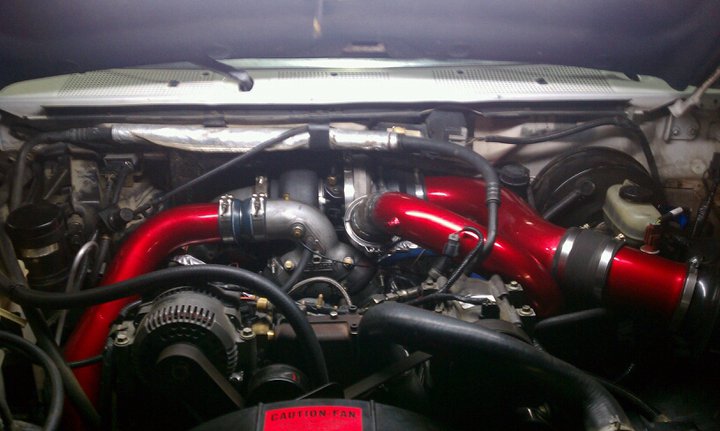

Lets have thread for custom turbo setups and pictures to give ideas to those that might be fabricating their own setups.
I'll start: Billet wheeled S400 based turbo setup for 2.6 sled pulling, Murff mount, custom "Y", IC plumbing, hood stack, etc...

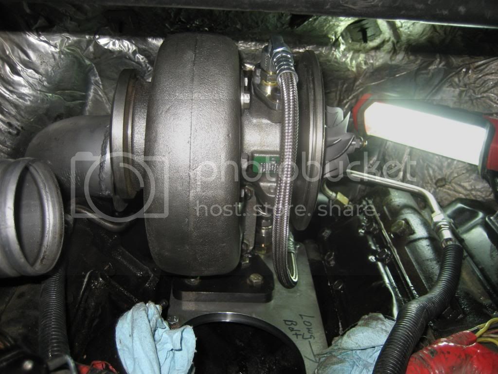

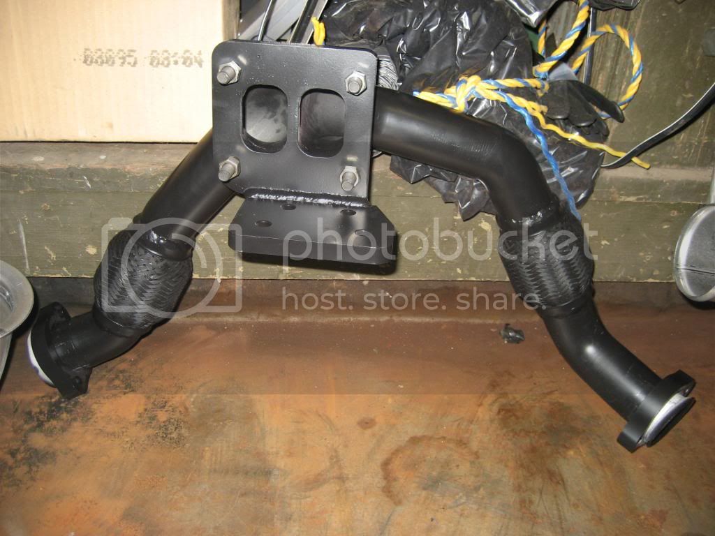

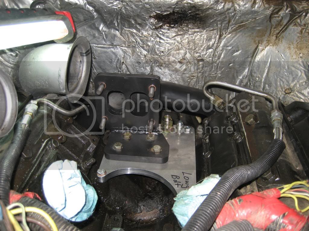

Garrett/Volvo GT4594 and mount kit I made for a member a while back.
68X94 Comp 88X82 1.19 T6 Exh

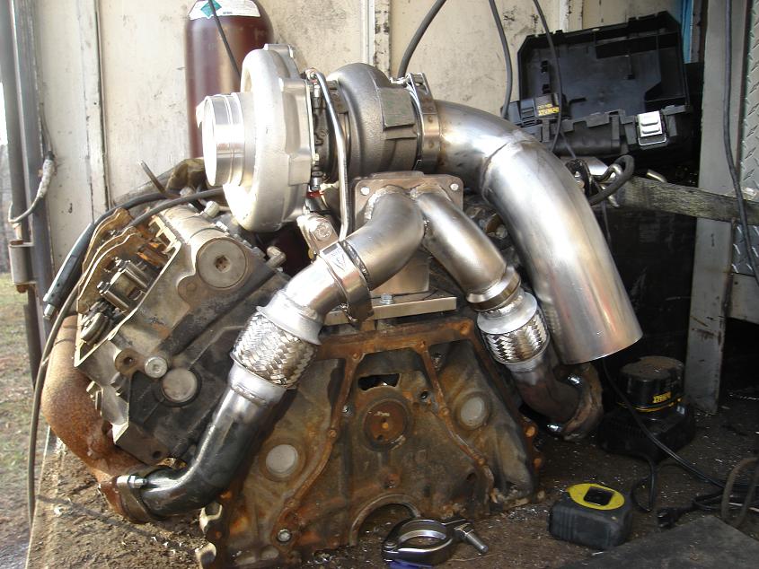

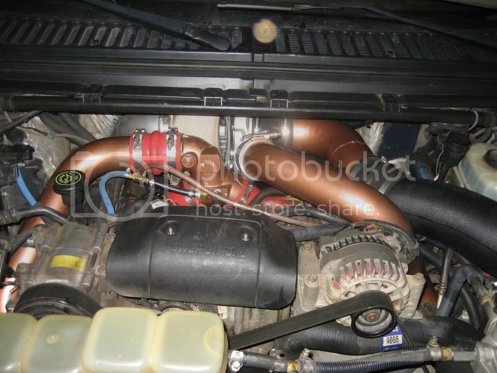

On my old 7.3
This was the infamous Chinese GT45 that would not die, later upgraded to the GT4594 setup exactly like the one seen above.
