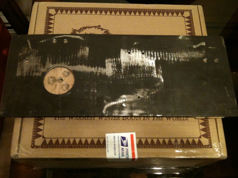

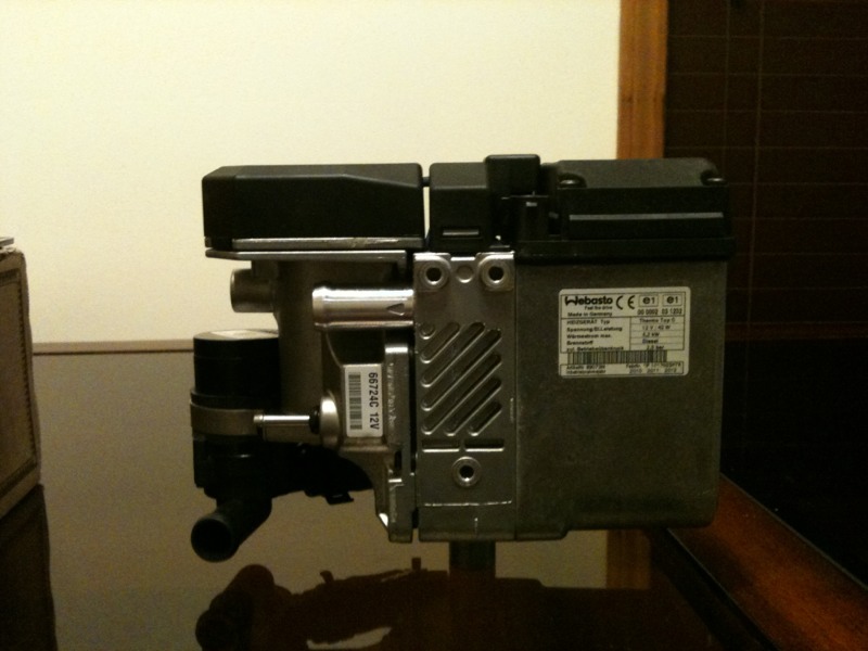

Here's some of the bracket and the heater. The bracket's nothing fancy, just something to keep me from having to drill holes in the frame. I need to get the holes for the heater opened up, they're a shade to small. I'll try to get that done Monday.
On the heater, the metal port on the bottom is exhaust, the metal one with a visible triangle is coolant out, the tiny feed is for fuel, the left-rearmost port is inlet air, and the black plastic thing on the lower left is the coolant in/water pump.
