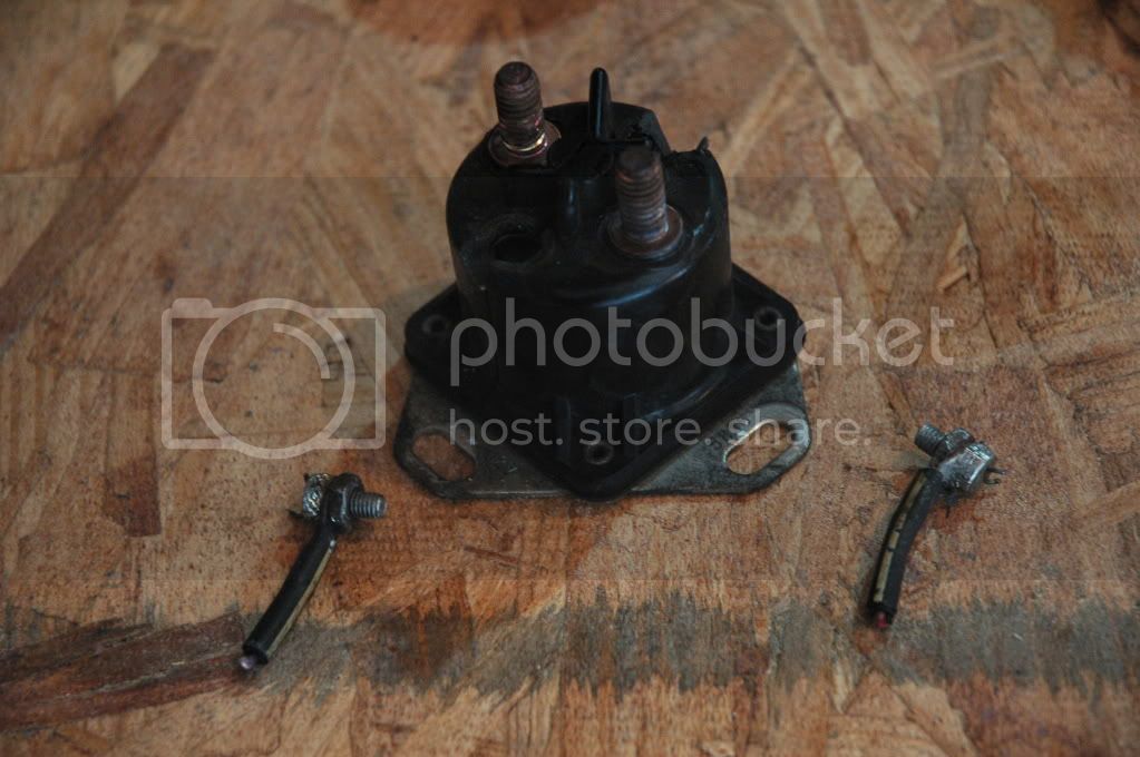

What is the solenoid under the plastic cover by the fuel bowl? Mine is broken, yet the truck still starts and runs fine.
CSIPSD
5,284
Bend, OR
Glow plug relay...
Go to Napa and pick up a GPR-109... Do not tell them you need a glow plug relay for a powerstroke or they will sell you a $75 POS... Tell them you want a GPR-109 and you will walk out with a glow plug relay for about $35 bucks.

Awesome. Thanks. $35 is a lot better than the $70-75 I was seeing everywhere.

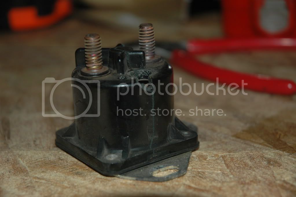

Or you can get a western plow relay for 12 bucks.
I have never done this, may have to try one... Any personal experance?
Any difference between this, and a starter solenoid? It looks just like the starter solenoid on every ford truck i have... and I have half a dozen of those laying around.
It is more or less the same, you could try one, it may last a week, it may last a year...
Keep in mind the glow plugs turn on every time you turn the key (more or less) and it gets a large workout.
Sounds like I should just stick to GPR-109. I don't mind spending the money to do it right. Afterall, $35 isn't much.

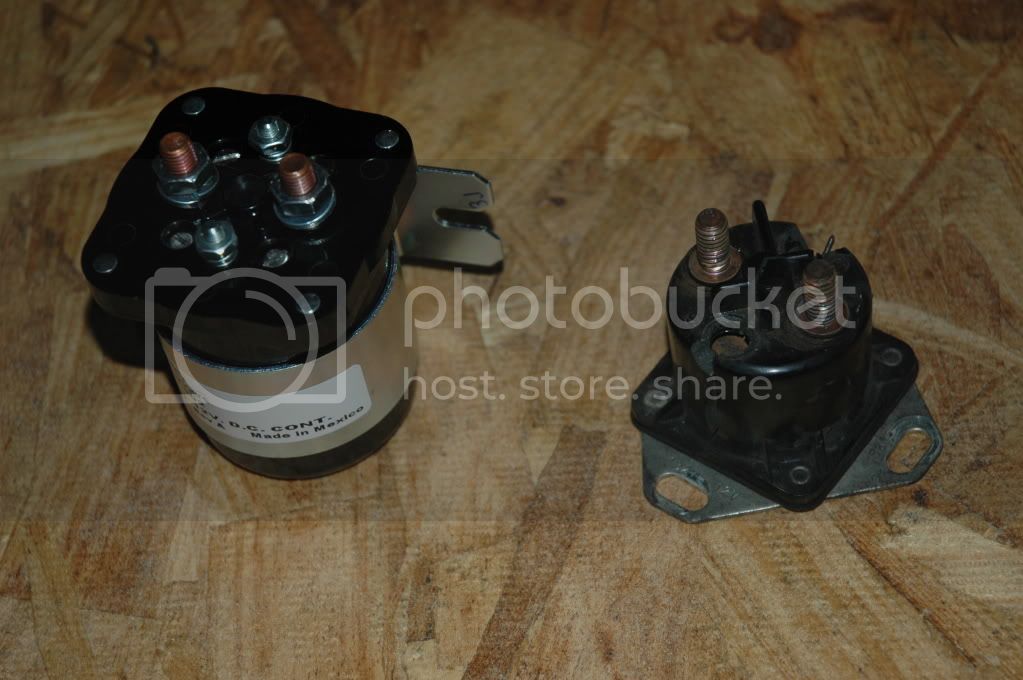

Its giant and built like a brick **** house. It's like the Chuck Norris of relays.
If memory serves me correctly, Chuck Norris died in Way of the Dragon. Got his ass handed to him by Bruce Lee. Where can I get the Bruce Lee of relays? lol
Will the stancor relay be a direct swap? Or will I need to change any of the connectors on the wiring?
