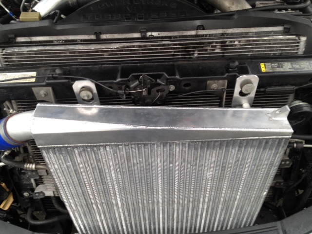

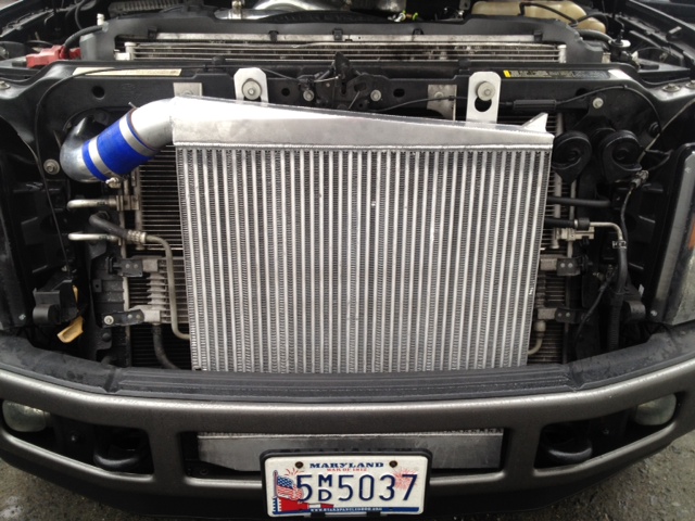

Been doing some testing on mikeys new intercooler..least to say this thing is built extremely well and is heavvvy....install was pretty easy took about a hour had to loosing the bumper up to install it and that was about it
So far i have noticed quicker spoolup and lower egts at highway speeds by 100 degrees...wot pulls seem to be a little lower...biggest thing i have noticed is i was reading boost from straight out of the turbo and before was 78psi and now is 72 psi

It does have a bar and plate core, the only ic I have experience with is the spearco, and this is thicker aluminum and welded inside and out, for high boost applications. 100psi at 700+ IAT entering. The core shows less than 1lb of loss across the core.
