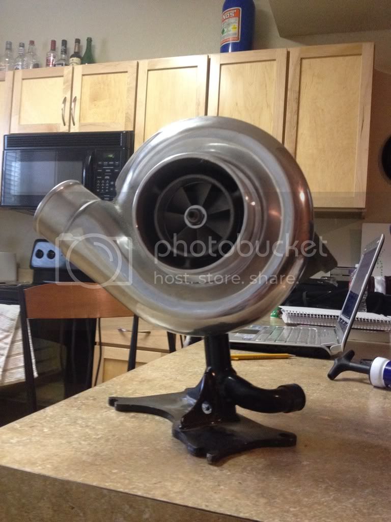

I threw in some photos..just for grins because I like to keep photos of this kind of stuff.
Parts: RCD s300 pedestal and t3 vband adapter
3" vband flange for downpipe (3" outlet on the bullseye turbo)
s364/71/.70
210cc's/100% nozzle injectors
Reflowed FICM half shell
KEM FICM tune
01PSD

Thanks! The return is part of the pedestal, RCD makes it
