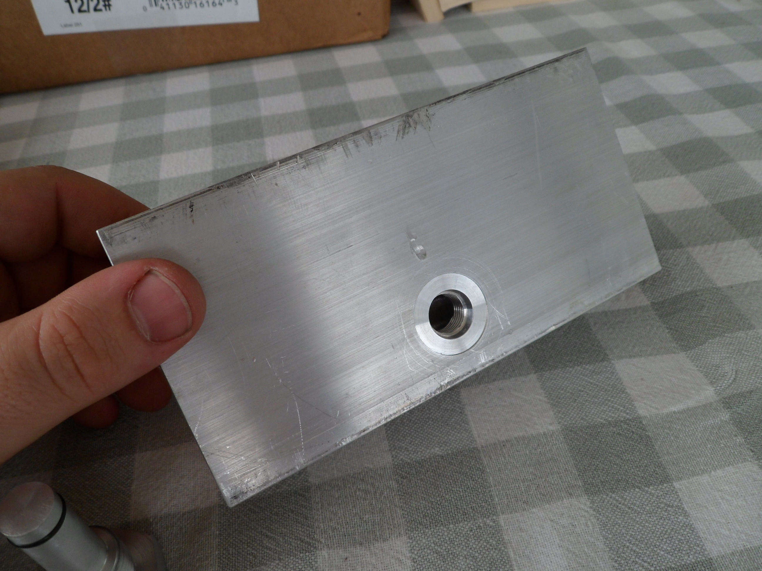

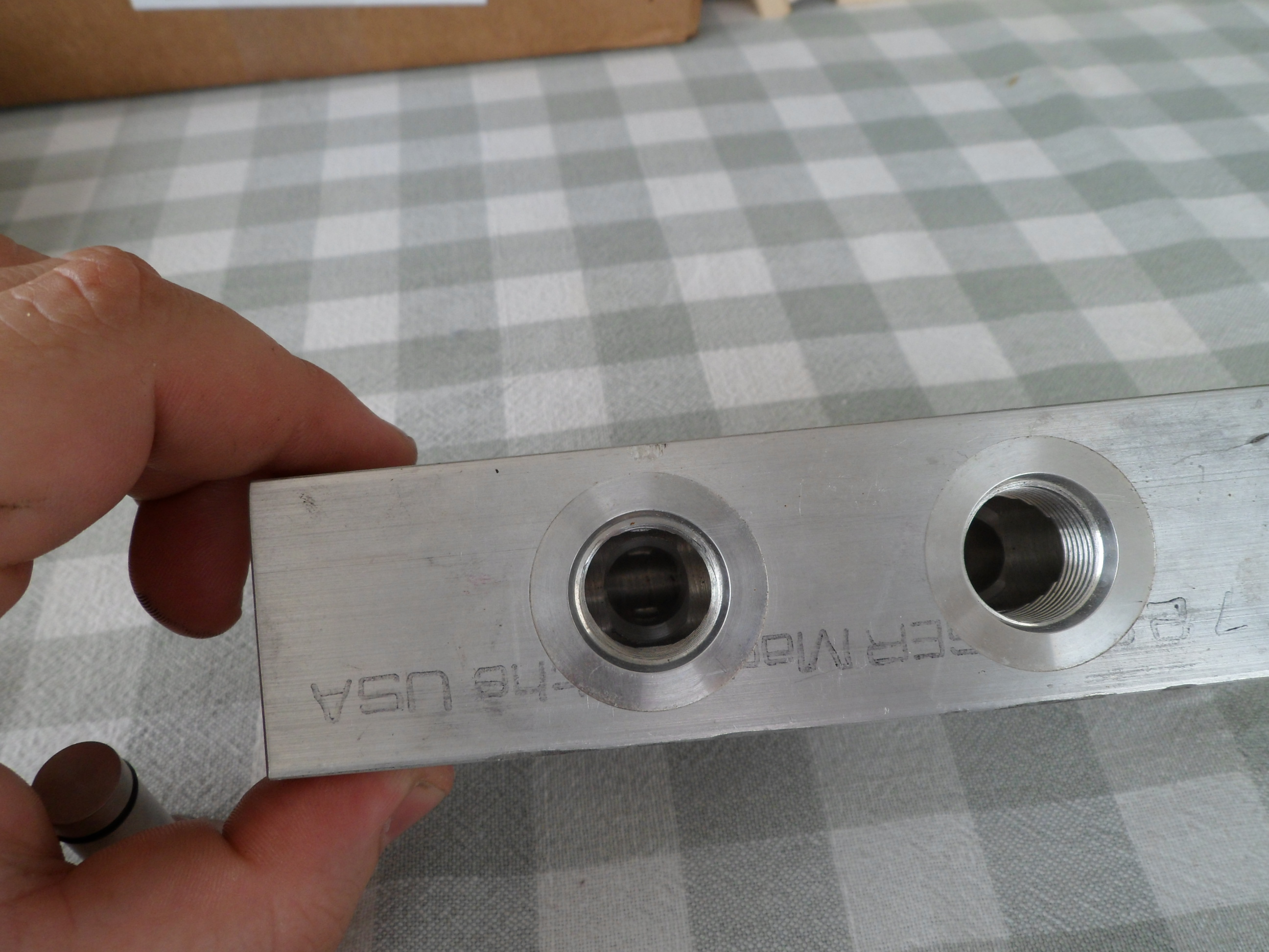

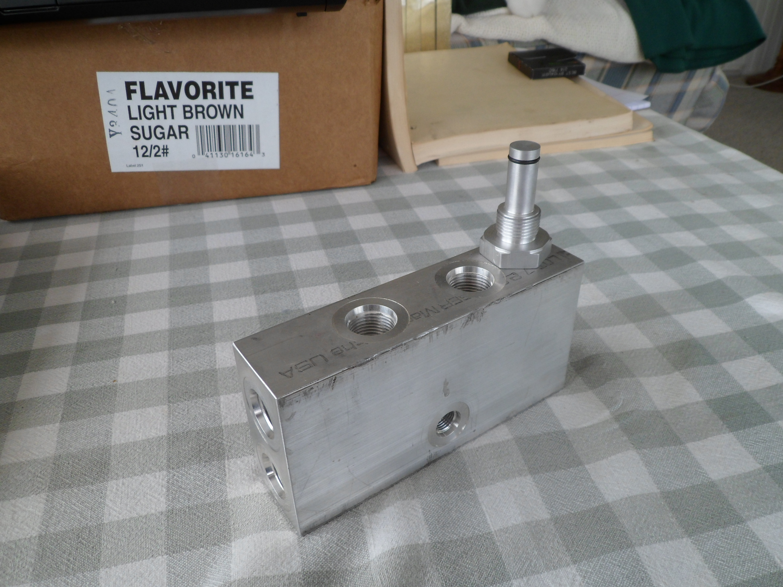

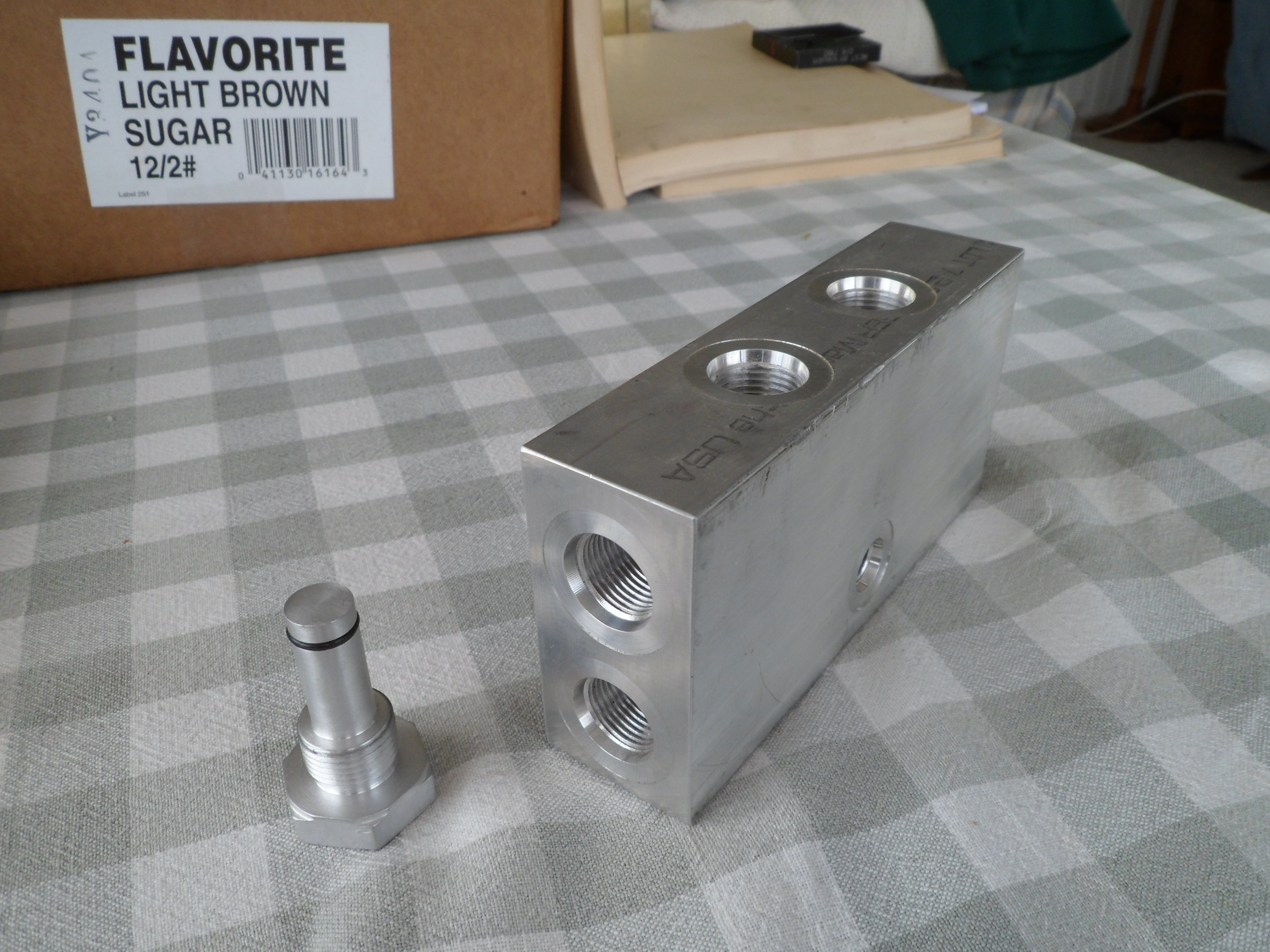

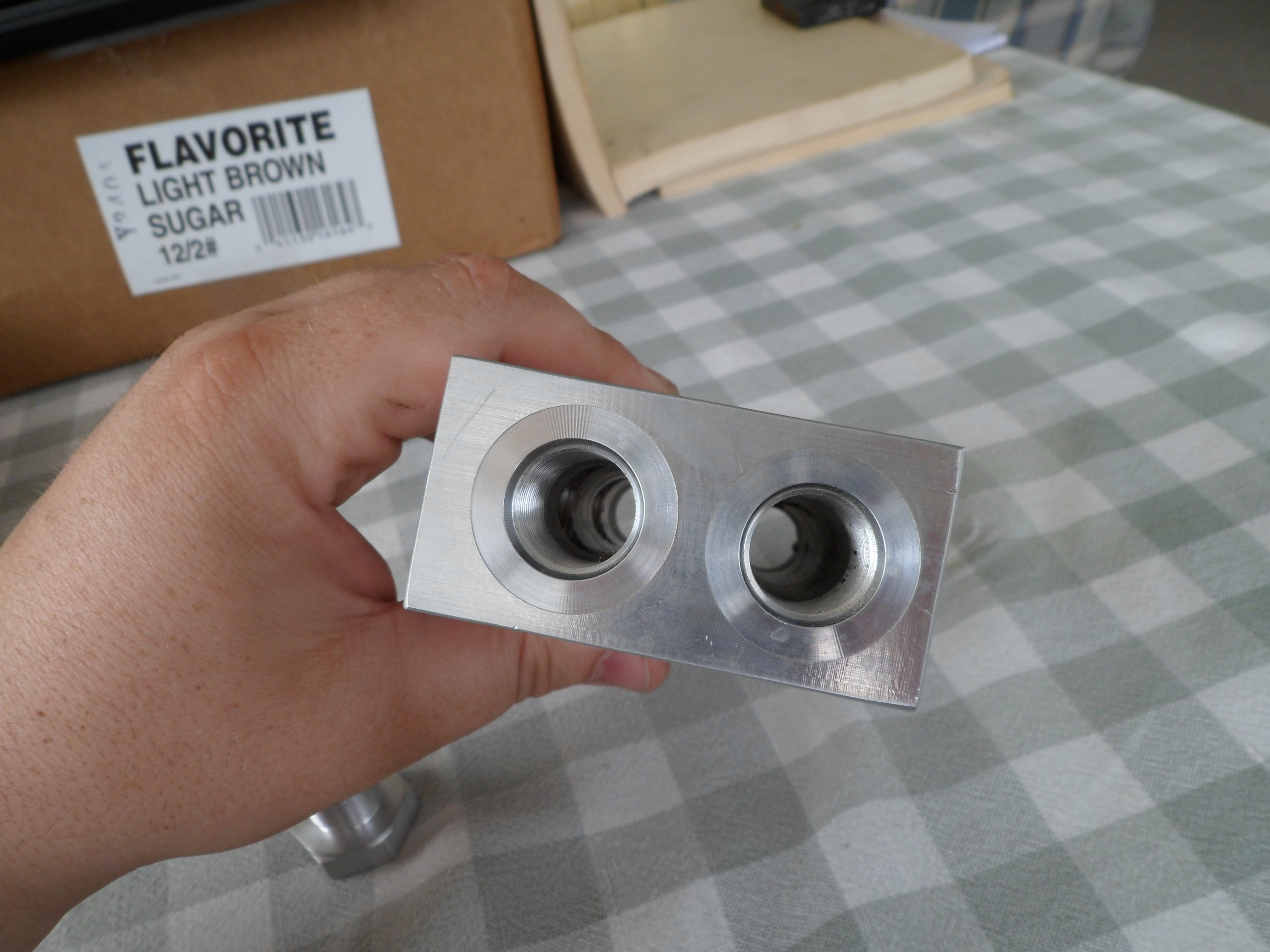

Pictures as promised.
Two IPRs go in the top, ICP sensor in the lower port in the middle - run a line from each head into the lower ports on the block, run a dump line out of one of the upper ports and plug the other side.

Dude, that is exactly what I have been trying to find.
