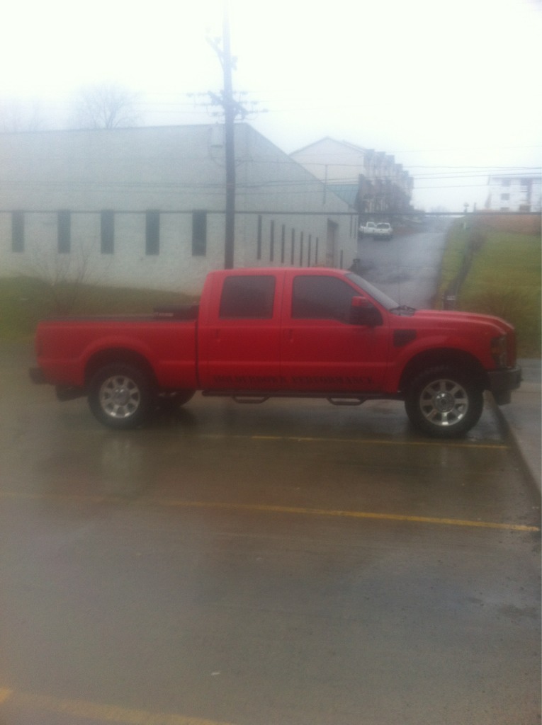

Factory 20x8 wheels, 295/60/20 Nitto Terra Grapplers, stock height F-250. The tires measure roughly 34" tall and 12" wide on these wheels. There is no rubbing anywhere with this setup.

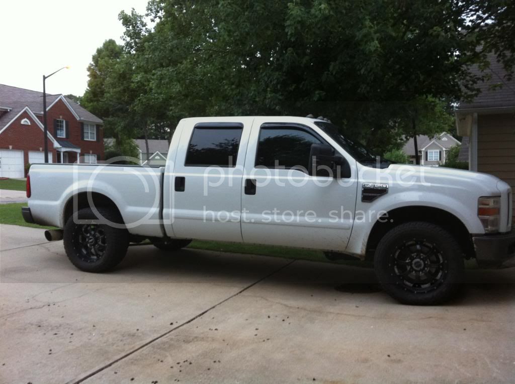

20x9 BMF Novakane's, 0 offset, 305/55/20 Toyo Open Country AT's, 4400 lb 5.4L front springs and no rear block. The tires measured a little over 32" tall and little over 12" wide mounted on the wheels under the weight of the truck. There was no rubbing with this setup with the fender well liner zip tied back.
Same setup as above, but with 305/50/20 Toyo Proxes. No rubbing obviously. The tires measured about 31.5" mounted and under the weight of the truck.

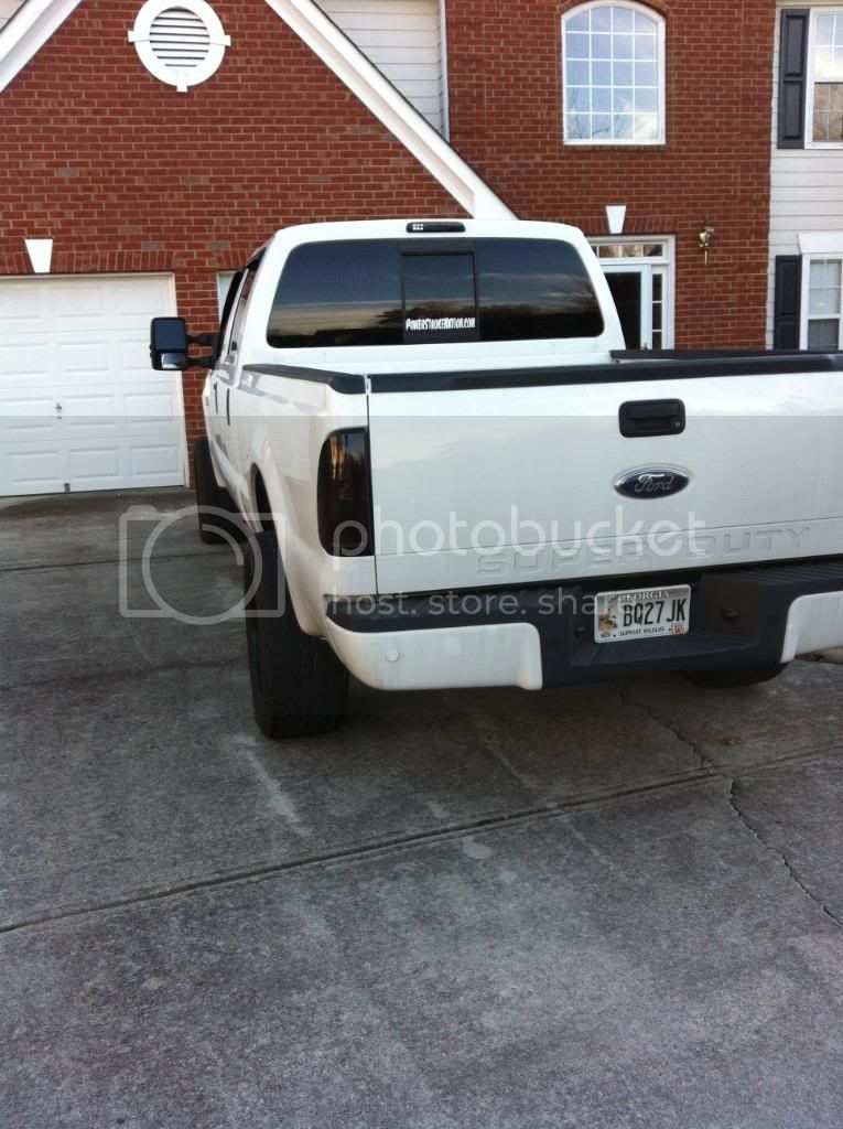

20x9 BMF Novakane's, 0 offset, 325/60/20 Toyo Open Country AT's, 2.5" leveling kit and 3.25" rear blocks. The tires measured about 34.8" on the wheel and were almost 13" wide. There was no rubbing at all with the setup with the fender liner pulled back. I also had this same setup on my truck with a 4" lift....no problems there either obviously.

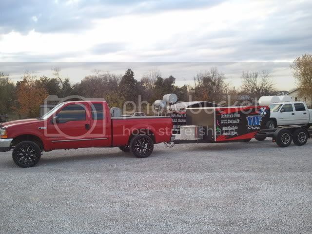

99 F250, 4x4, 100% Stock suspension, 20x10 wheels, -24 offset, 305/50/20 tires.
It is tight in the front but it does not rub. The closest I get to rubbing is about 1/4". The tires stick out about 2" and it will sling rocks and water down the side of your truck. I would like to try a deeper offset but my pockets aren't that deep and it may cause rubbing on the leafs, don't know for sure though. I tried to get some good angles.

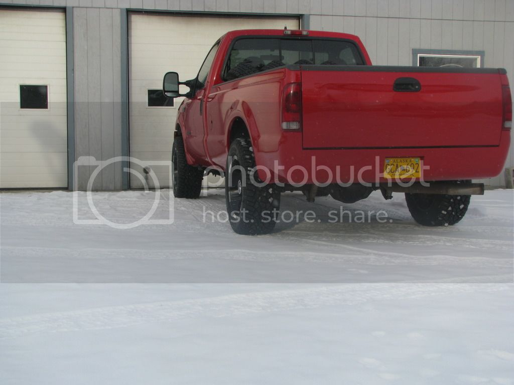

Wheels: 20X10 Moto Metal 951's with -18mm 4.79" BS
Tires: 305-55-20 Cooper Zeon Ltz
Truck: 00 F-250 stock front with rear leafs modified to level (-2")
No rub, no modifications to wheel wells.

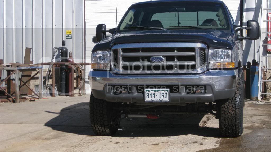

20x10 Fuel Throttle, -24mm offset 4.5" BS 35x12.50x20 toyo open country MT minor rubbing, pulled fender liner=no rubbing. total stock height
factory 20's, 35/12.50/20 toyo open country MT. fender liner pulled back from 20x10's no rubbing.

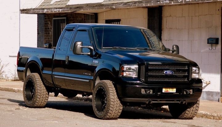

Only pic I have of it with the 40's probably don't really help much. I'd pot another set on if Johnny law wouldn't bust my balls on the lift laws. They put me 2.5" over height
