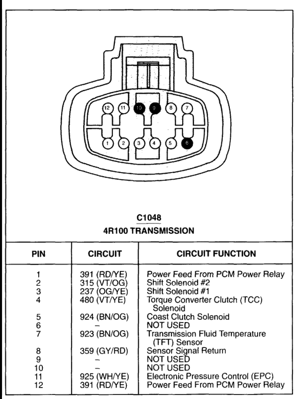

Need a picture or schematic of the passenger side 4r100 plug/connector
MadDiesel73
1,153
Glen Burnie, Maryland
I need to find a schematic or good picture showing wiring harness plug/connector on the passenger side of a 4r100, specificly a 2002 if it matters. i need to see where each color wire goes in the plug end.
can anyone help?
rpm-inc
988
This is an 01, but should be the same.
